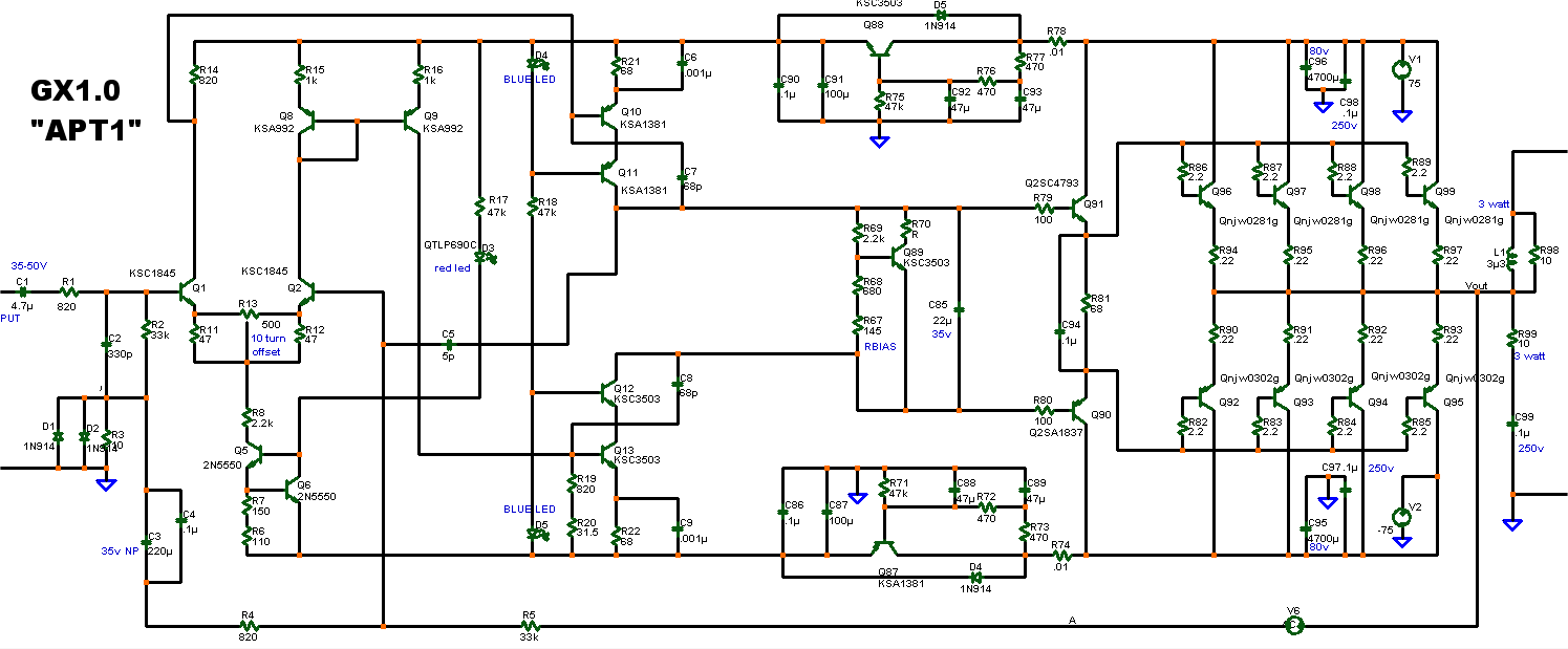

That will be my GX , with full cascoded VAS just like the original. paired with the PB250 it should be a good clone. The apt used a triple ,, but with modern driver/output pairs 2SA1837/2SC4793 + MJL4302/4281's , the EF2 will be up to "snuff".
GX will be coming "soon" to a theater near you..

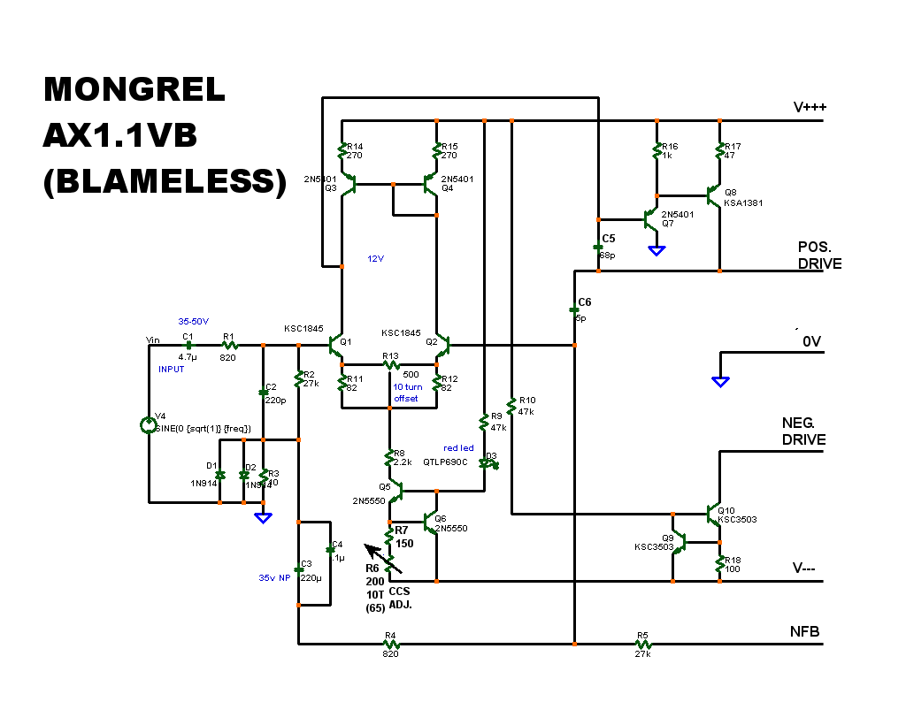

I am doing the "Blameless" now (AX1). The VAS was very easy , I kept it compact (below - 2) with it's 2- KSA3503 VAS CCS back - to - back. On the top end (+) the KSA1381 and it's EF driver (2N5401) are also , should I say .. "face to back". All 4 trannies will happily run in class A with a little 50 X 20 mm (2 x 3/4") heatsink which you could cut out of roof flashing. You don't need anything special since ALL my VAS's run 6-8mA per device. On my "supersym" , at 7mA X 5 = 35mA ... just slightly warm , regardless of output stage use.
I decided to use the ksc1845's on any differential without a cascode. At 120Vceo ,low COB (1.8pF) , high gain (Hfe100+) they are best. I will keep the 2N5551/2N5401's for CCS's and CM's.

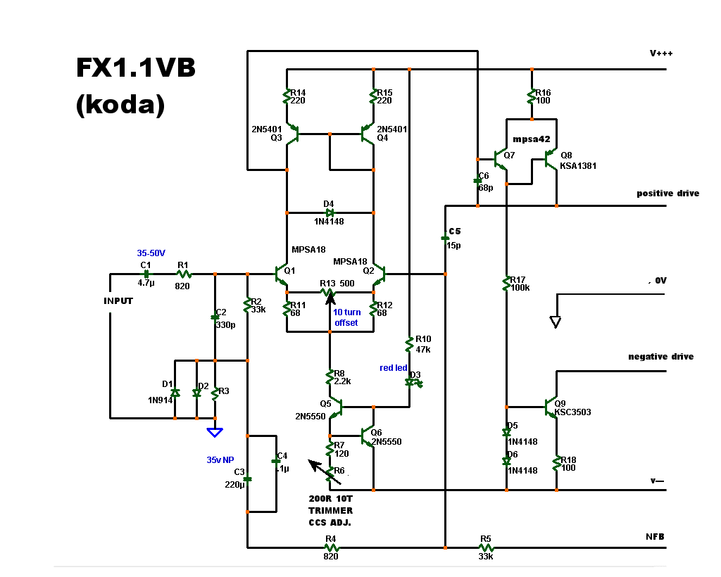

For better clipping, put a protection diode between Q7's base and Q8's collector. This will help protect the VAS and decrease clipping recovery time.
The Blameless looks fine, and it seems you've carefully included an error made by doug himself. He said himself that R8 was a mistake, if only I could remember where. Anyways, notice that the 2N5551 has markedly worse Ft than the 2N5401 (PNP wins over NPN in this case). Increasing Vce decreases Cob. Including a resistor may or may not increase HF impedance in important places, but it will lower the RC corner frequency, where phase changes rapidly, possibly into the audio band (but probably in the ultrasonic). I try to steer clear of phase anomalies.

Changes in blameless have been assimilated (borg speak) (pix 1)

BTW , APT1 (the GX) is pix 2.

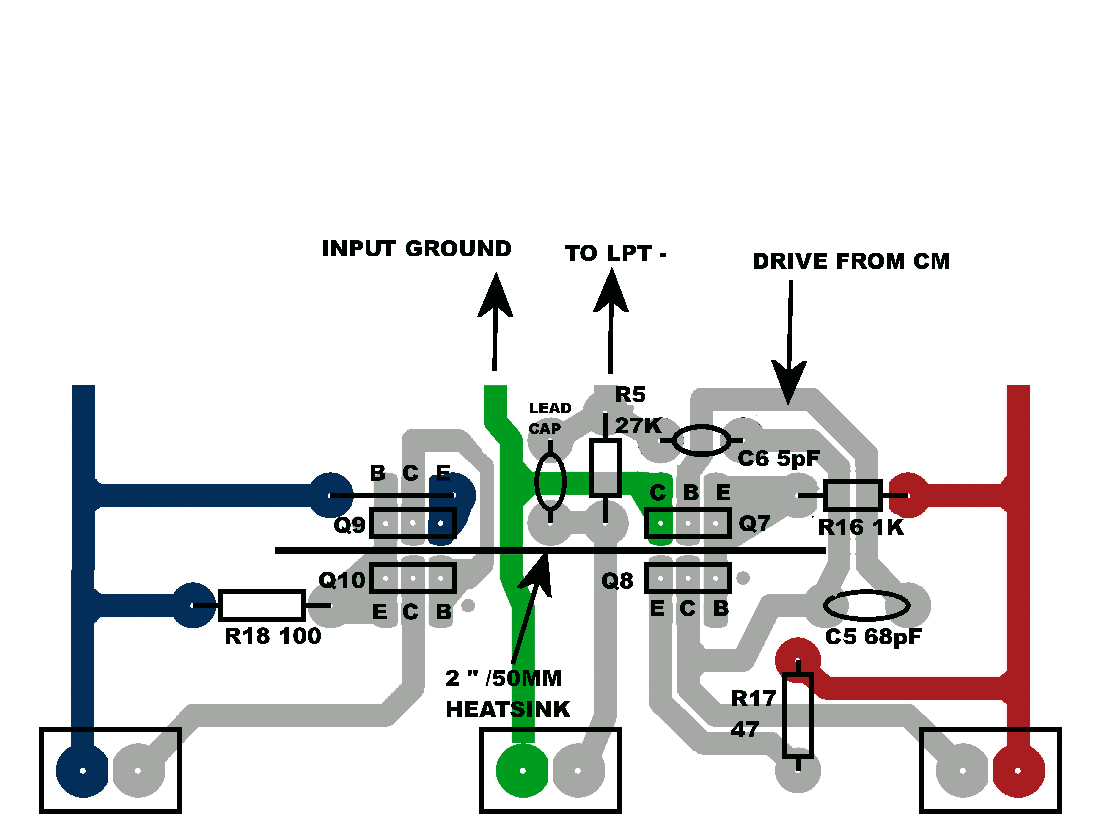

Let me finish them to at least the GX , they are hard (2 hours for a voltage board).

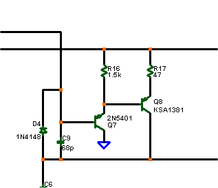

Alright, I will post the CCS. It uses three BJT's, and optionally a schottkey (my personal improvement). No hard to find parts, just one extra transistor, and it's the best.
BTW, you put the diode in the wrong place I think, it's supposed to Q8's collector, not emitter. This is done often in opamps, for reference.

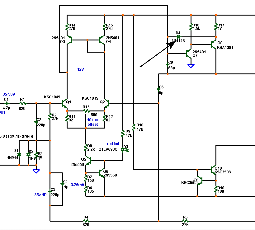

You mean put the diode in parallel with the miller (c9 - below) ?

I like the idea of the Baxandall pair as a VAS, but look at C6. The purpose of the Baxandall pair is to decrease effective Cob, yet you've just added a whopping 68p. I may argue that it does help cure problems by canceling nonlinear Cob effects, but how much Cob does the KSA1381 have? Is it enough to make a difference? Second, the MPSA42 is a very slow transistor with whopping Cob (IIRC), and Cob is at it's largest with Vcb=~0mV. Even a faster transistor may have significant Cob in this position. I also don't know if saturation could be an issue, though it could help to put a diode in series with Q8's emitter, raising Vcb(Q7), decreasing Cob (negligibly?), and steering clear of saturation.
Now all that aside, if you can get it stable, I think it still may be better than the Darlington VAS, but how much so, and do the pitfalls outweigh the benefits?
The best situation I can see in using the Baxandall VAS is where C6 and C5 are kept well away from the VAS output, quarantining the output switching high order distortions, and another, albeit adventurous, stability compensation scheme is used. Contact me if you're adventurous.
In the situation just described, I think the Baxandall CCS is a very good choice.
One last thing to consider. For the Baxandall CCS R16 is necessary. This causes Vcb(q3) to vary according to VAS current, and this invokes Early affect, decreasing the gain of the CM+LTP stage. It also makes the Cob of Q3 and Q1 less negligible because Vcb is no longer constant.
You may be able to get around this, if you can find a clever way to get Q7 to sink all the current Q8 takes so that current through R16 is constant.
Next, power supply ripple through R17 will inject straight into the VAS, decreasing PSRR. This may not be a problem but if it is I would bootstrap R17 to positive rail, filtering out hum.

EDIT: didn't see your latest post, yes, that is what I mean. Now that I look, I don't know if a 1N4148 will be able to take that voltage drop, and a larger diode might have worrying parasitic capacitance... Hmm...

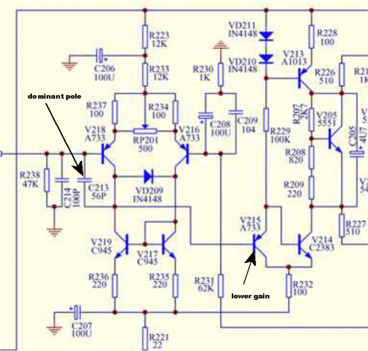

You lost me , Kean. I assume you are speaking of the FX VAS (R16,17 etc. ???) where is the voodoo CCS ??, you can email it to me.
On the real amp (the coda with the super pair), they set the dominant pole between the base of the first superpair tranny to the base of the non-inverting input transistor (56pF). I used a mpsa42 because I have 150v between rails , I was scared of the 2SA733's Vceo.
Schema is below , amp really works .. I have the real one in the house.

Edit .. Kean ,you are also right about isolating the input stage from the "dirty switching" of the OPS. By where they place the miller and the fact they take NFB from the drivers ..NOT the OPS , this seems to be the koda designers goal.
You could send me the "voodoo" CCS as a .ASC file !!
OS
