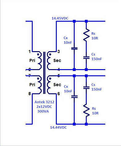

I reduced BrianGT PSU resistor value from 0R51 to 0R14.
I've read this should improve higher voltage but reduce rejection.
Added Mark Johnson "Quasimodo" filter, according from other members reported values.
This should reduce transfo ringing. I've got no scope, nor search more about how to measure values with DMM.

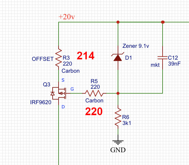

I purchased two Pass-AM cards from Sheffield Audio (Chinese).
The cards are well made with some good components and some really poor quality. Result, the card comes out with an offset of 94mV.
They used 8 poor quality carbon resistors with values very far from the nominal values (example: 340R for 220R marked).
To start, I changed the DC offset resistors (R3 / R5) and goes to 25mV.
What did you think of this use of carbon resistors by the designer?

Hello Friend. I can tell you something: if you think this amplifier has a problem, you should be more suspicious of the transistors than the resistors.
Hello Carlos,
At the moment, I don't think transistors have a problem. By contrast, after having unsoldered and checked each resistance, I can tell you that they are very far from nominal values.
For the moment, I just changed the resistors which control the offset and the result is spectacular. They was 240R and 340R. I replaced with 220 and 214. I went from 94mV offset to 4.5mV.

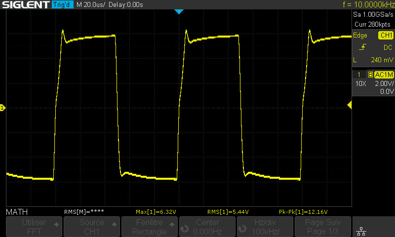

On the other hand, the measurements at the scope are not good. Square signals are distorted.
I ordered the resistances which I miss. Afterwards, I would take care of redoing the measurements and worrying about the transistors if there are still problems.
