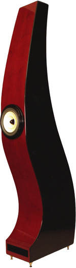

Teresonic Ingenium Silver Floorstanding Speaker with Lowther DX4 Driver Review | Dagogo | A Unique Audiophile Experience
The Metronome is just another incarnation of the mass loaded Voigt.
Indeed, nobody has ever claimed otherwise. It's using a slightly different expansion to those envisioned by Voigt, but they're all ML horn variants. Or tapped ML horn variants if you want to be really particular.
The Teresonics have been lurking on the fringes for a while. As usual, no measurements. I particularly enjoy the 103dB 1m/w rating for a DX4, which Lowther themselves rate at, er, 96.112dB 1m/w. Dodgy claims aside, they're quite striking looking bendy ML horns / Voigt pipes / whatever you like to call them -no reason why something along those lines couldn't be constructed.
The problem with Lowther drivers in resonant cabinets -- anything other than a backhorn that will compensate for the baffle step -- is that once you compensate for the baffle step, you wind up with a speaker that is 90-92dB/w/m. A DX4 probably is 103dB/w/m at the very peak of the classic Lowther hump, but once you get that tamed, you are back to 90dB. You have to remember that the Lowther drivers were invented for front horns. A front horn makes much of the Lowther rollercoaster FR go away.
Bob
Bob
Just because I had a few minutes with nothing to do, I read the Dagogo review of the Teresonics speakers . I though the reference to Helmholz' original paper of two centuries ago was a nice touch.
Then I when to the Teresonics and checked the specs.

.... they're quite striking looking bendy ML horns / Voigt pipes / whatever you like to call them -no reason why something along those lines couldn't be constructed.
Hmm, since they are tapered in two directions we should relabel them as curvy metronomes.....
(and construction is likely easier than the metronome - it is not the easiest to make the top and bottom nicely square on those)
