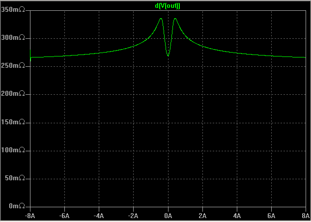

andy_c said:
The smaller the emitter resistors, the larger the optimum bias current. For 0.22 Ohm, Self computes 107 mA as the optimum. For 0.1 Ohm, it's about 210 mA. Go enough below optimum bias current and you get the peak at zero that doesn't dip at all. So what you had is essentially an underbias condition for the zero Ohm resistors. 100 mA is close to optimum for 0.22 Ohms, showing the dip around zero. That's why I was wondering about Jorge's bias current too.
It looks like Self's optimum bias condition also correlates with minimum variation of output impedance for a fixed EF configuration with varying bias. Makes sense - just two different ways of looking at the same thing.

janneman said:I have one question on one of your early graphs Andy. It shows the expected dips, but I noticed that the peaks were very, very sharp. I understand it is also possibly graphics-related, but such a sharp peak would be very difficult to handle by any nfb. If this peak was more gently, the nfb would be more effective.
Hi Jan,
Only have time for a very quick reply here - working. My early graphs had a +/- 20 A min and max on the current, while Evil's had +/- 8. So his look more spread out. I had to go with +/- 8 on the later MOSFET plots as those weren't even readable at +/- 20. Also, my vertical axis was autoscaled to blow up the full vertical variation, while Evil's showed two plots on the same graph, compressing them vertically somewhat. I could re-plot my orignals on the same scale as Evil's tonight and we could look again. It's hard to mentally adjust the graphics .

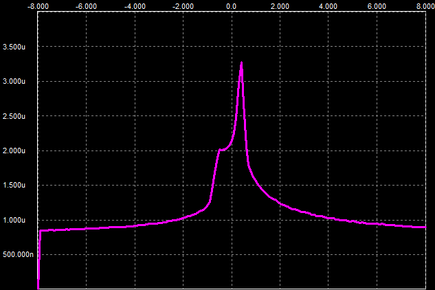

For comparison, here's the same simulation run on my favourite power amp , two pairs of lateral MOSFETs in the output stage, about 60mA Iq per device, lots of open-loop gain. The graph is the same sort of shape as those done so far, but much lower magnitude.

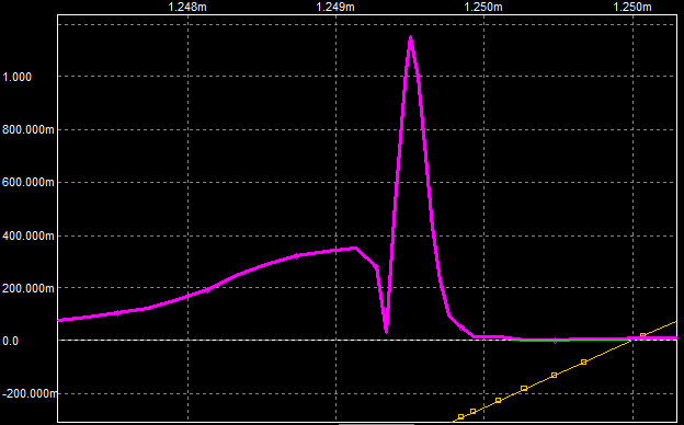

A slightly different measurement this time, on the same Sziklai output stage I used earlier: Output impedance (purple) plotted against time with a 10kHz sine wave current drawn from the output. Similar sort of shape to the DC impedance, but higher in magnitude.
The current (orange) passes through zero a bit later than the impedance dip. Unsurprisingly, this difference in time is roughly the same as the phase shift at 10kHz.

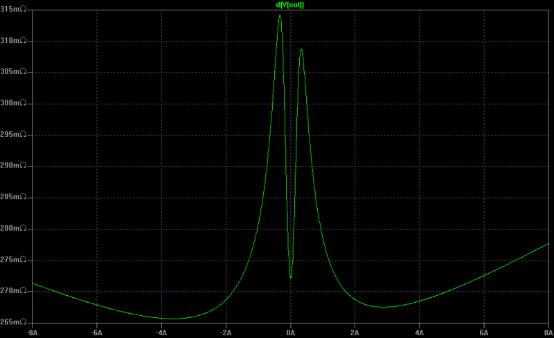

Hi Jan,
I'm reading your response again, and I'm not sure now if you're referring to the original BJT circuit or the later MOSFET circuit.
If it was the MOSFET circuit, I'll refer you to the orignal post where I discussed the sharp peaks. The SPICE models have discontinuities in the derivative of the Id vs Vgs curve.
If it's the BJT's you're referring to, I think the plot below will clear that up. I changed my original BJT circuit so it has only a single NPN and a single PNP to make it match Evil's circuit that he plots in post #237. I changed the current sweep from +/- 20A to +/- 8A. I also changed the y scaling of the graph to be exactly the same as Evil's in post #237. I also tried to size the graph so the graticule size matched Evil's as closely as possible. Below is the result. You can see they look very similar now.
You're right about the distortion. The more wiggles in the curve, the higher the order of the polynomial needed to accurately approximate it. And the higher order of the polynomial directly translates to higher-order harmonics when a sine wave is applied.
One interesting thing is that the underbiased condition has less wiggles than the optimum bias or overbias conditions, but the deviation from linear is larger. You'd expect it to have a higher overall distortion, yet have a distribution of harmonics that's weighted more toward the lower-order ones. OTOH, the overbiased condition seems to have the worst of both worlds. It has more wiggles like the optimum bias condition, but its deviation from linear can also be much higher than that of the optimum bias condition. You get both higher overall distortion, and a greater percentage of high-order harmonics too. Yet it's been said that listeners tend to prefer overbias. So much for the "golden ear" types I guess .
