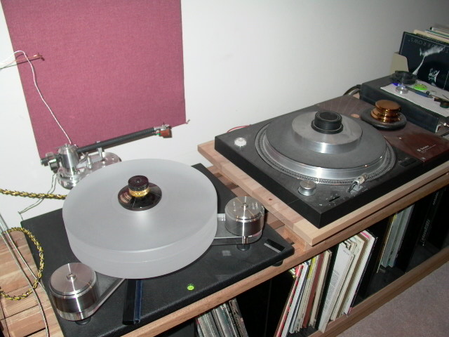

I am new here, I got pictures showing I use very thin elastic thread (from clothing material supply) in one condition is to use both hand turn start before switch on, ratio is 1 to 1 between plate and driver's pulley (real big pulley) and if weight well balanced will not have slip problem, Result ? this is the best (I did a lot test of different materials) can give more live of sound, rest all feeling dull try same size sewing tread (nonelastic) you will have the answer right away.even changing weights to the driver's plate, the sound quality will follow, worth to have a try, it won't cost much money and have a great fun.
I modified the DD Technics SL1100 by separated the power supply and changed the better VR for better speed control, and also cut a small grove to keep the thread in place
Tony Ma
