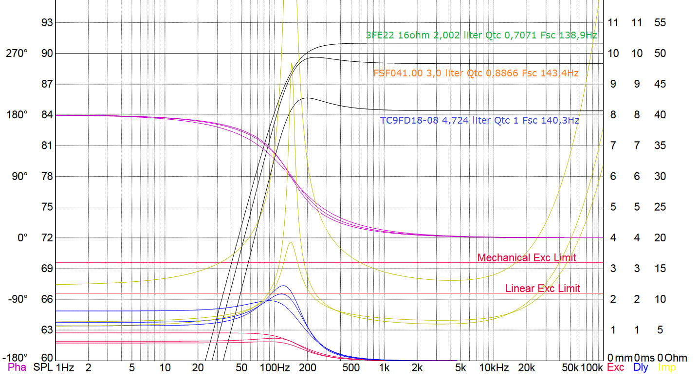

A quick glance makes the newcomer seem like a promising contender. Due to its size you would use 20 or 21 per cabinet vs 25 TC9s as 25 Lavoces would exceed a standard 8 ft (2.44 m) ceiling height. Even so, at 20 per side it has a combined Sd of 1080 cm2 vs the 908 cm2 of 25 TC9s. Somewhat surprisingly (to me), the Xmax is 2.2 mm vs the TC9 at 2.6 mm. Sensitivity is 89 dB vs 84 dB for the TC9.
X, wesayso, fluid, BYRTT, the usual suspects: would anyone be willing to run some sims for 20 Lavoces per cabinet? A somewhat educated guess on my part would think about 3 liters per driver would work but I’d like to see the science behind the possibilities. At its retail price of $15 USD you’d be looking at $600 for 40 Lavoces. I haven’t checked into quantity pricing yet but even the retail pricing doesn’t seem unreasonable. Is it as promising as it seems?

Volume displacement capabilities becomes very close between 20x Lavoces or 25x TC9. (combined Sd x X-max)
What I like about the TC9 is it's low moving mass, the somewhat smaller size, it's frequency response, the non stamped steel basket, the shorting rings and of course the fact that a lot more real life data was available for it (like IR response and FR curves from a lot more sources globally).
I'd still pick the TC9 in this comparison for array duty. Or choose an even smaller driver with enough x-max to compensate for it's smaller size. (or use subs underneath)
Are you serious about using this driver in an array? What would make you pick it over the TC9? I'd suggest buying samples from both and just listen. Whatever you like (or dislike) you'll get back on steroids in an array.

I don't have any reason to pick it over the TC9 at this point. It's a new driver and I was wondering how it might compare through simulations to the TC9, which you have proven is at the top of the heap in bang-for-the-buck line array drivers. PE is out of stock on the TC9 until October but I'm not in a hurry. Line arrays are intriguing to me, in large part because of what you have wrung out of the TC9 over the last few years. It may take me a couple of years to put a line array together. If Tymphany decides the TC9 should go end-of-life before I make the decision to proceed it would be nice to have another driver alternative to hand.
I appreciate your suggestion to try a couple of each. Small-scale testing as a predictor of large-scale results.

Thanks sharing info for that new device, that said think TC9 will always has it low cost blah blah blah against it as reason for let customers doubt its worth and probably wesayso and Pano would agree on that point, think most important is TC9 raw response is one of the smoothest in class then add a serius dead frame with excelent ventilation plus shorting ring feature, only if i have seen is a personal test with 4 other full rangers where the only one that had 3rd order harmonics depressed below 2nd order harmonic distortion was 10F, but wouldn't hang my hat on result without further investigation because it was a big cardboard baffle that maybe could flap a little and also i used a very old LUXMAN reciever as amp that could be responsible for some of that distortion profile. If you read xrk971 and my subjective review linked into post 1 and also read when ra7 had vistors from local HiFi club over his TC9 based array build thread it should be obvius this low cost driver can perform excelent.
Think 10F is too expensive in higher numbers than a pair, should i come to think of other that maybe could be brought up to TC9 like performance and be interesting is Faital Pro 3FE22 but in 16 ohm version, it needs only 2 liters for a 0,7071 Qts and is relative smooth provided its superior effiency that will make up for the less Xmax compared to TC9, one day i buy a pair of these to see if it corrected can reach up to TC9/10F and reason is as for member mitchba i think i become subjective familar how dampening influence sound and being 16 ohm we get better ratio into this feature provided amp can swing the higher voltage that was a everyday spec back in time, also it did compete subjective and objective well over at xrk971's comparison threads.
Below is simulation for sealed enclosure 1 watt input for TC9/FSF041.00/3FE22 (16ohms), FSF041.00 can also reach Qtc of 0,7071 and a bit lower extension but it will take 25 liters then so used 3 liters as volume for simulation.
Not much to add here, the TC9 is a tried driver, up to the task. Many other drivers have been tried, not all of them successfully. I do think the smaller SB65 is a very good driver for array duty, but it isn't cheap. It has a lot less surface area so it probably needs bottom end support.
BYRTT, thanks for running the sims. I realize this is run on manufacturer's data alone but we have to have a starting point for comparison, don't we? I had just finished reading the entire thread again (it's taking much longer each time) and I appreciate the reviews provided by you and Xrk971. I have no doubt the TC9 has proven itself as something way beyond a "TV speaker" when used in careful application by Ronald, ra7, fluid, Perceval, Pano, yourself, and many others. The TC9 is truly a gem.

As you see from BYRTT's sim, the TC9 would love a bigger enclosure too, as it's QTS is rather high to start with. I "only" have it in about a 2.1/2.2 litre enclosure space per driver.
Knowing your A4-sized footprint was a self-imposed design constraint due to room size and WAF (GAF?) what would have been your optimal space per driver without those constraints?
