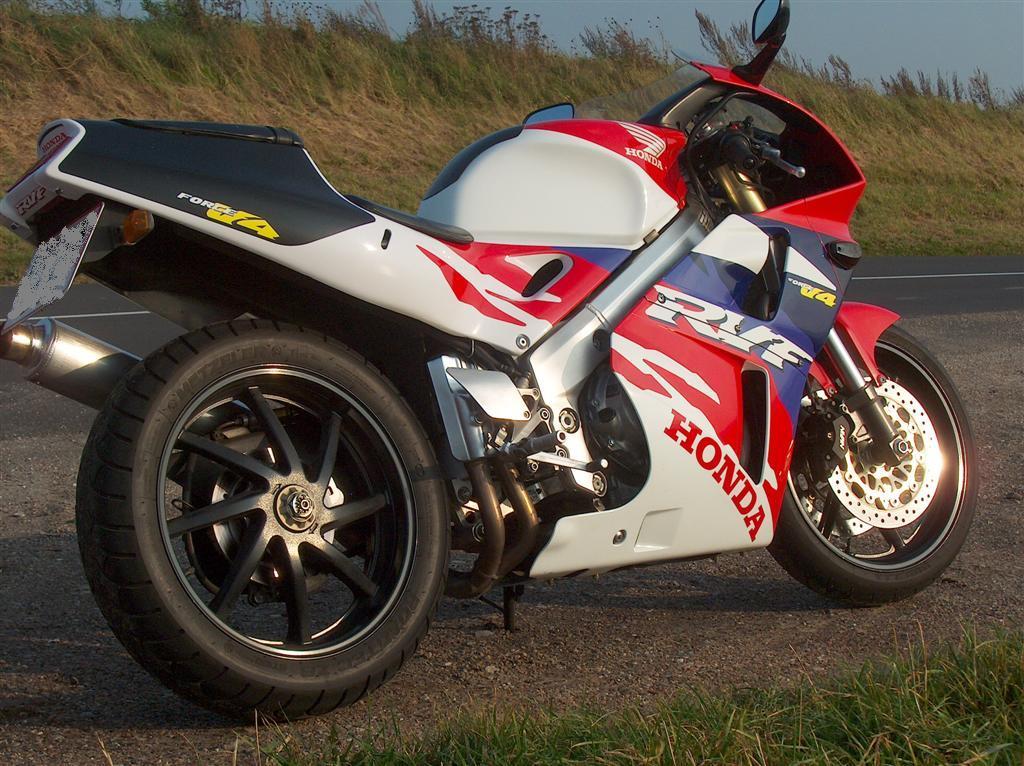

My summer ride:)
genuine 1994 race tech, at low cost
with carb and exhaust tuning
sweet sound and a sheer joy
goes straight to my blood every time
