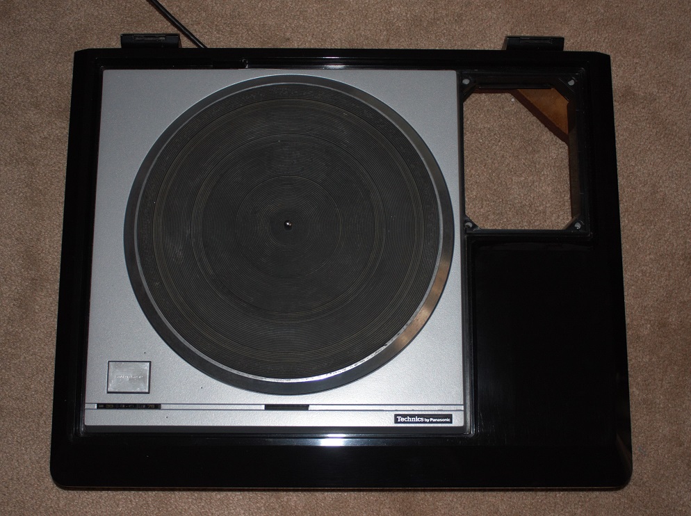

Irrespective of the fix for this, what does the box do?!
Allows remote start/stop of the turntable in a studio environment.

Appreciate all the help but I’ve decided to leave it and just use it. The visible part of the deck works just the same and I have room for the bits.
Although I have the guidance if I do take the back off and want to look into things (maybe if it ever skips a beat and I look at a cap refresh etc. As well).

You will probably need a resistor, won't do any harm.
For the 3.3V LED look at the current rating then divide the desired volt drop by the current.
If 3.3 V LED draws 10mA and your supply was say 6 volts. Your resistor would be 2.7/0.010 = 270R. A 1 watt resistor should do you. 10mA dissipated into 270R is 0.027 watts.
If its powered off of AC it will only light 50% of the time, i.e for each half cycle. Suspect this shouldn't be a problem.
If its too bright, increase the resistor value.

LEDs were mere lab curiosities when the SP-10 'tables were developed. You can still find the miniature light bulbs, but I replaced mine with an amber/yellow LED. Since the power light runs off its own winding, you'll need a series diode to rectify the AC as you'll likely exceed the reverse breakdown voltage of the LED w/o it -- a common 1N4002 will do just fine. Then you'll need the resistor mentioned above, the exact value dependent both on the output of the SP-10's pilot light winding and the properties of the LED. Also, IIRC, you'll need a small-ish LED, like 'T-1' size to approximate the size of the original light bulb.

Last part correct, but of course LED's are used in the speed selector buttons. I always replace the PSU bulb with a tiny identical filament bulb, it gives such a lovely glow and needs nothing extra at all.

Is there a filament bulb link for a like for like part drop in?
Yes, where in the world are you ?

So, the PSU bulb, in the UK it's available from http://cpc.farnell.com/ the 12V version that's a tad dim is AR70316 and the 6V version AR70317 .
