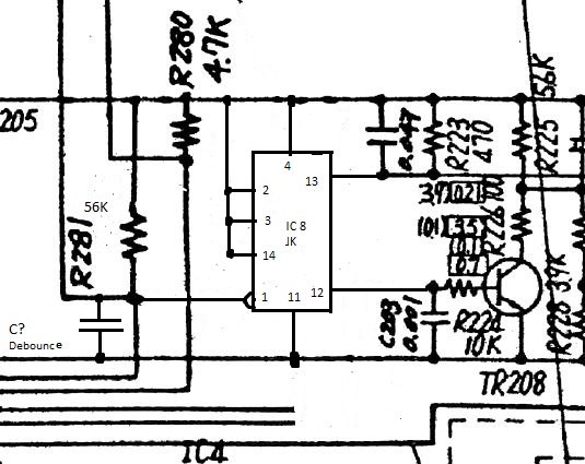

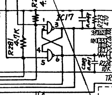

Thanks, my next move was to solve the stop start logic dilemma, it appears missing, but in reality it was always there minus some connections and debounce circuit. In fact there are two options either reuse the basic flip flop in IC 17 or use the redundant half of IC8 which has a spare JK flip flop.
I went for using IC8 and the JK flip flop. This is true to the Technics version with the logic already in service.
Photo 1 shows the original circuit.
Photo 2 shows the new circuit redrawn with IC8 press ganged into service.

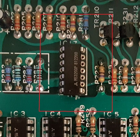

Photo 3 This shows how IC17 has been modified, I removed the IC and soldered a chip carrier to the board. I then snapped off legs 2,3,4,5 and 6 and replaced the IC in its socket. This renders the two unwanted gates inoperative.

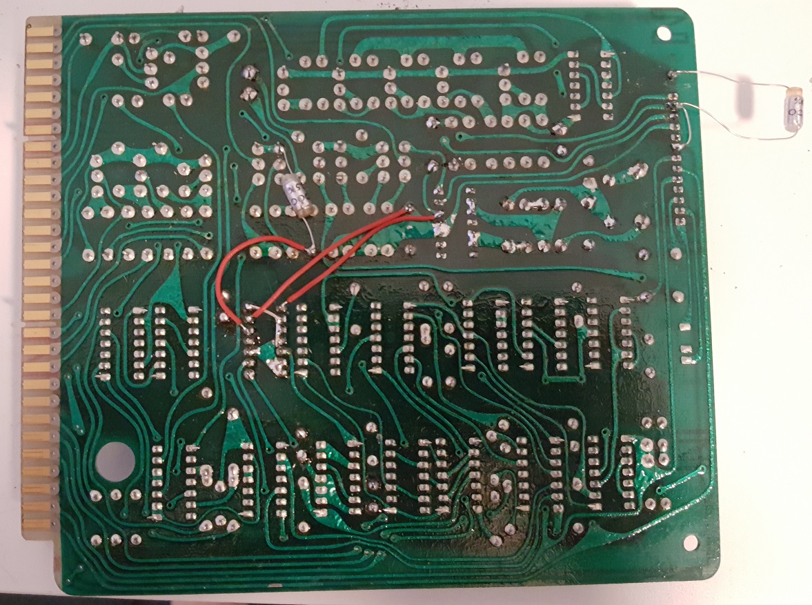

Photo 4 shows the wiring to connect IC8 and placement of C203. Additionally a link has to be connected from ST to VV to connect the clock input of IC8 Pin 1 to the stop/start switch. This is visible at the top right hand corner, also note the switch debounce capacitor connect across the stop/start switch to ground.

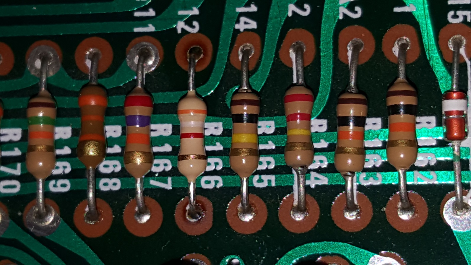

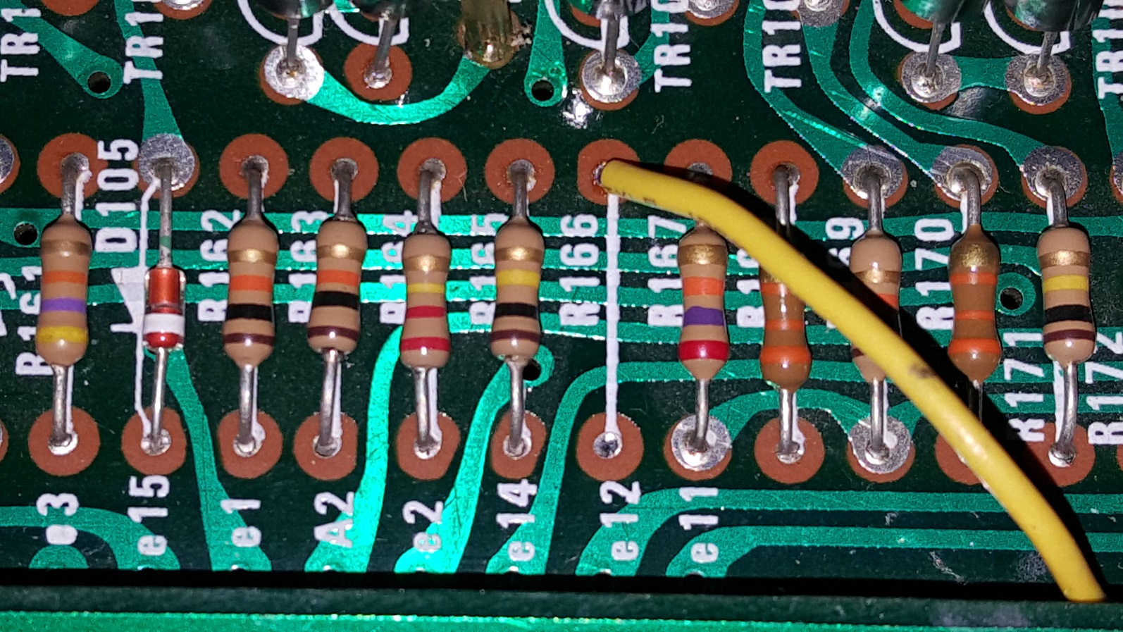

Finally the VV connection goes via the main connection board to the missing R166 resistor position on the control board. Essentially VV is really D1 and this can be traced to the controls socket on the main connection board and then via a single yellow wire from the controls socket/plug to R166. Totally remove the yellow wire by cutting it both ends. Then solder the correct resistor into R166 on the control card. Photos 5 and 6 show R166 pre and post mod.
I've yet to arrive at the correct values for the stop/start switch debounce RC combination. I will scope it with a decade box connected for both R and C. I started out with 56k and 0.1uF soldered in but reducing C to 0.001uF has got my in the ballpark, as I can now start and stop the turntable on most attempts.
All my controls work having reinstalled the switches and connecting the requisite wires from controls to the controls connection plug.
Its an efficient set of modifications as no tracks have to be cut or ICs dead bugged. That might change if the debounce can't be made to behave with the RC combo.
