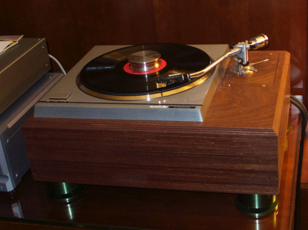

I asked Kent about this table, and his only correction is that it was made from Luan plywood, not Panzerholz. The Luan sounds better.

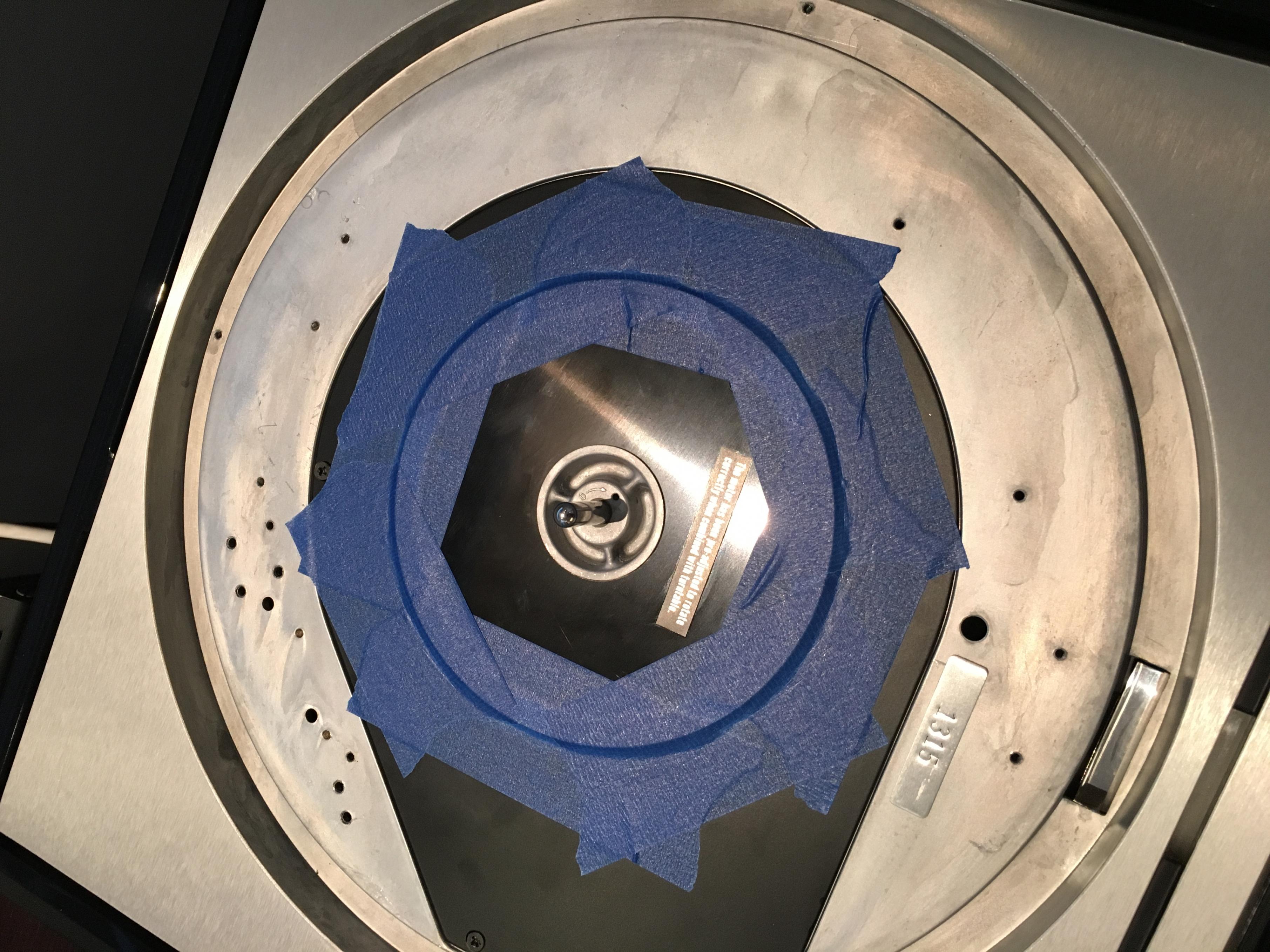

Shipping Bracket plans ?
Does anyone know where I can find a template for the SP-10 Shipping bracket ?
I need to have one shipped and need to supply the bracket.
I would greatly appreciate it if someone could email me one or point me in the right direction.
I tried the usual websites devoted to the SP-10 but so far no joy.
Thanks all
Skip: Thanks for pointing it out. I looked right at it and did not see it. My brain was thinking Shipping Template and did not see Motor Clamping Plate. My wife calls this looking like a man. You know when you are standing in front of the open refrigerator asking where is the Mustard and she walks up and points to it right in front of you.
Bon: Thanks for the feedback on the Ebay one. I saw it but too expensive for something I would use once.
JP.
I was thinking tape would be a good idea. and think this is how I will go. Some Blue masking tape so that it comes off without a bunch of adhesive residue. Worst case is nothing a little goo gone can't handle.
