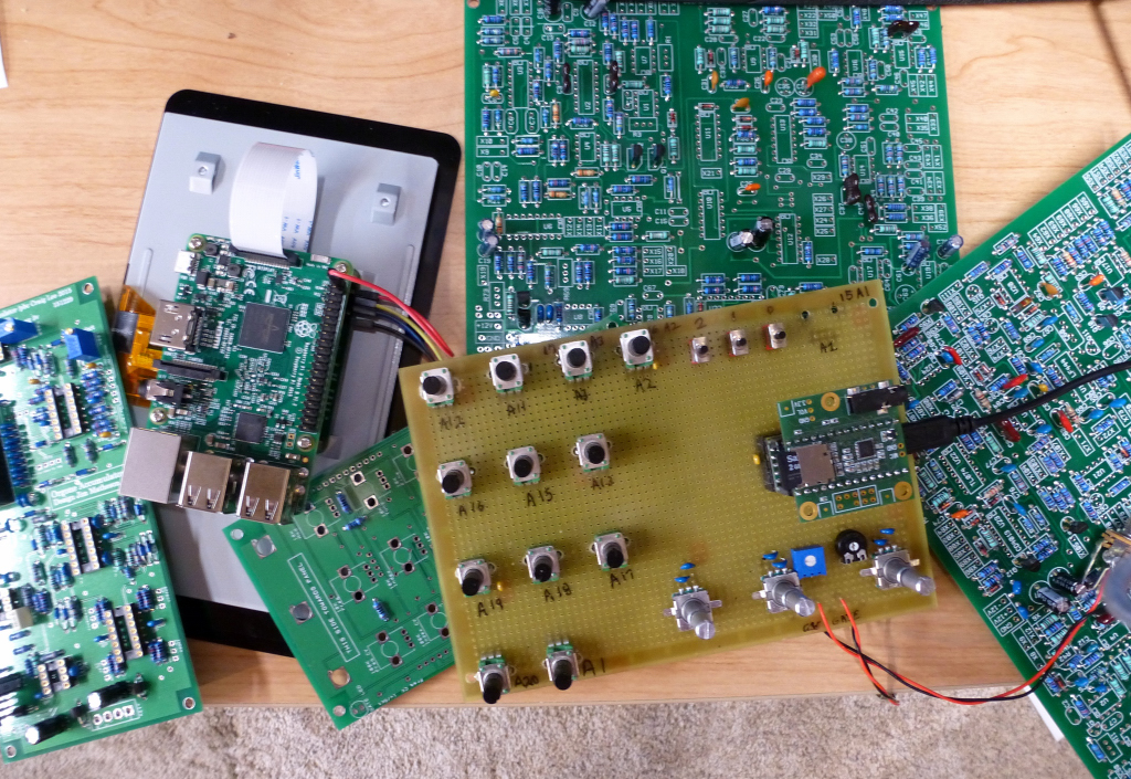

I have been "dreaming of wires" since I went to an ELP concert (or 3) in the early 70's. I started building a huge digital synthesizer with primitive RTL technology (individual gate and flip - flop chips) in 1971. I got a real engineering job that paid well in 1972, so I put my synth project on hold, and bought an Odyssey....then a few Korg's, a Solina, a couple of Rolands......I kinda had the Rick Wakeman look going back then.
Sadly all but the JV-1000 got sold over the years (life, and family happens).
My 41 year old engineering career ended about 2 years ago, so it's time to build that monster modular that I see in my dreams.
Technology has improved a bit since the early 70's, and I see no reason to build yet another Moog or ARP clone, so I have chosen my own unique route again. It is a mix of analog and digital technology, some commercial boards, some of my own design, all built around the 1V/oct standard. And, yes there are clones of certain well known modules like the Moog ladder filter. The cabinet (unfinished) holds Eurorack and RU based modules, and the "wires" are both 1/4 inch and 3.5 mm.
The big modular that I started in 1971 inside, and on top of an old Hammond transistor organ got scrapped 40 or so years ago, but I did save several of my perf board tone generators. I wonder if those 50 year old IC chips still work?
Some of the experiments will be carried out in this forum when I have something worth sharing. Right now it's just funny noises coming from a few perf board ideas, and a pile of commercial boards in various stages of completion.

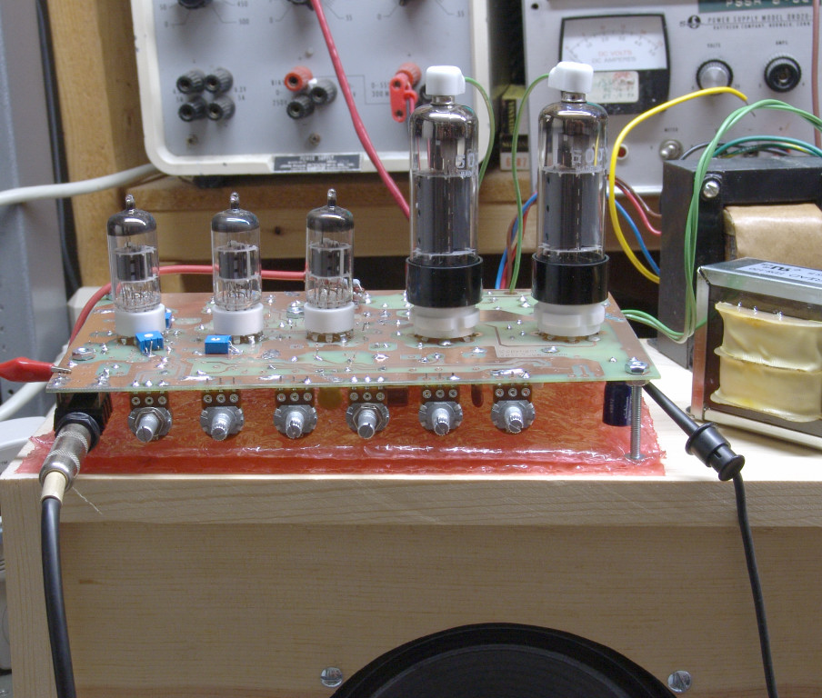

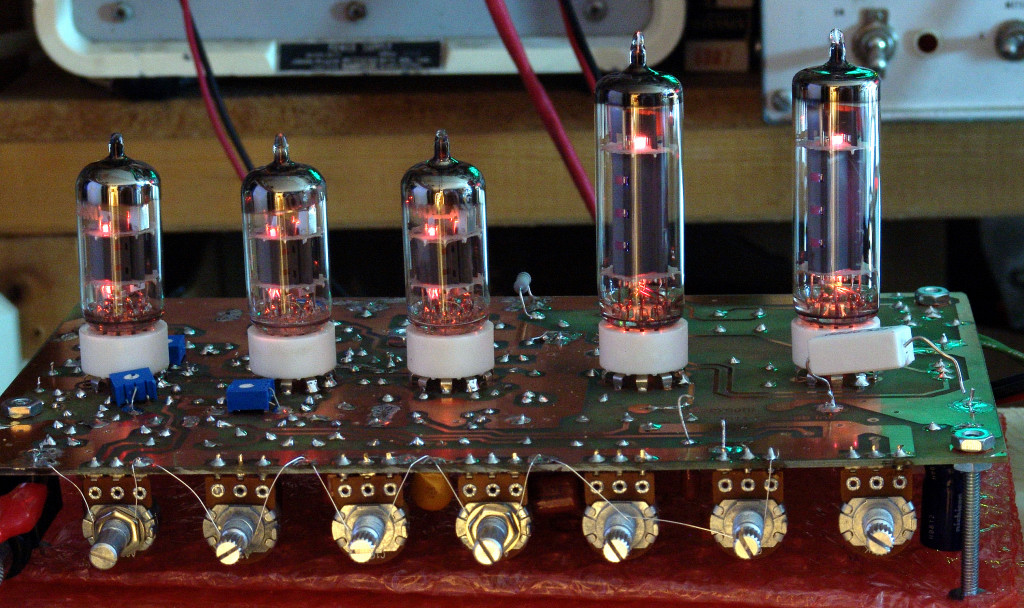

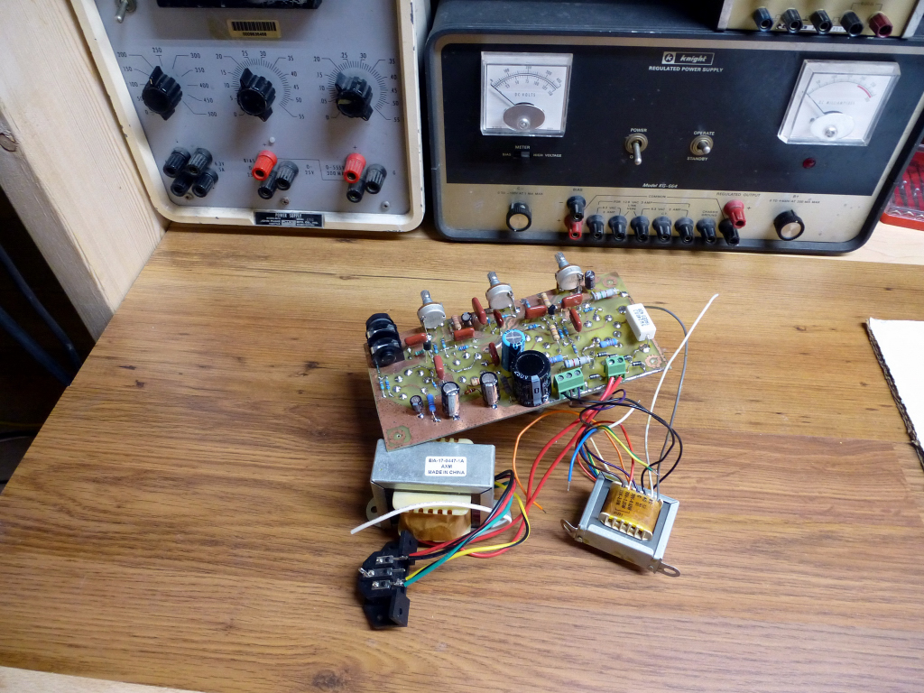

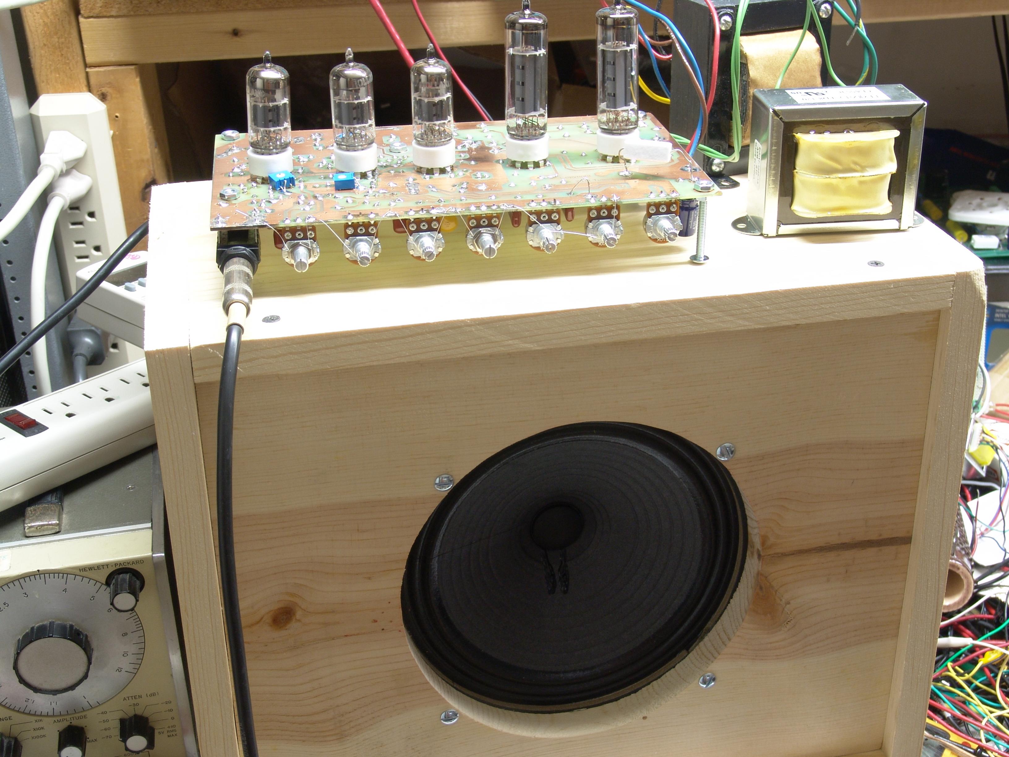

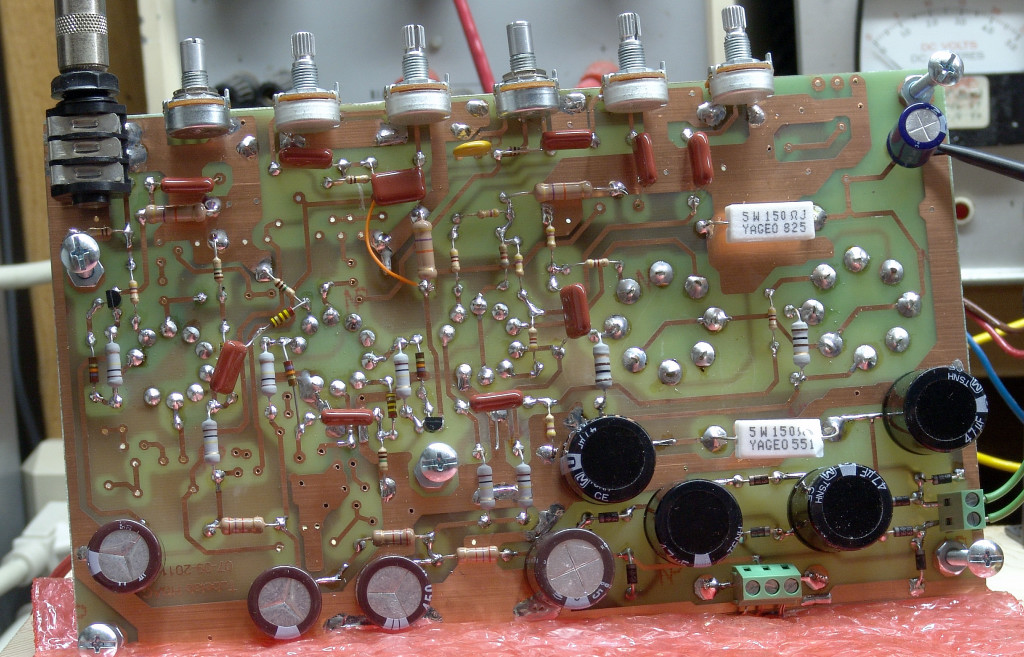

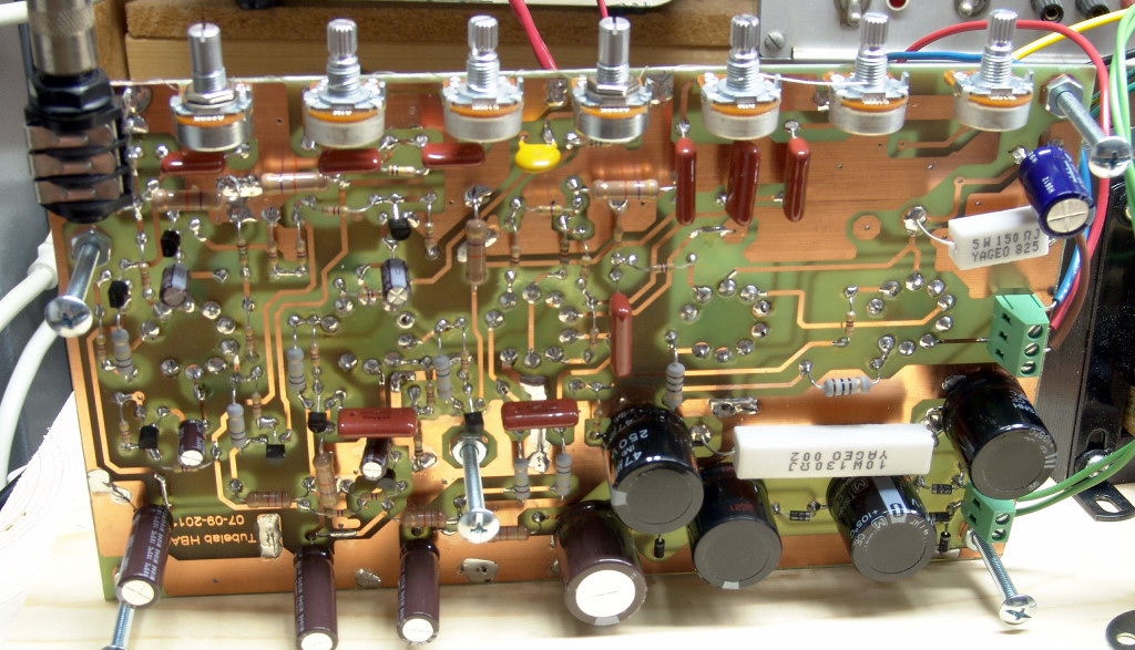

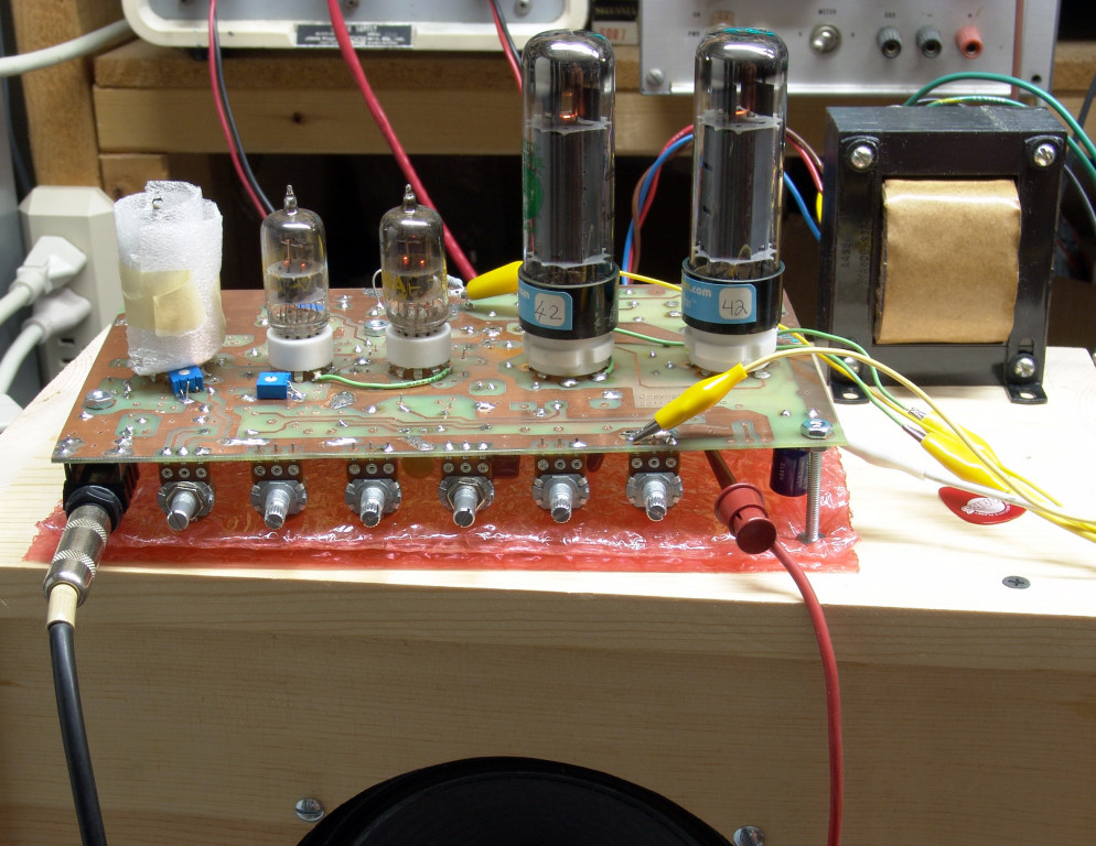

It started out as amp 1.0, a self split amp designed to run from about 135 volts derived from a tube rectifier and an isolation transformers. It sounded bad, dull lifeless, and rather wimpy. Nothing I did to it made it sound good, so I decided to kill it by turning the power supply up till it melted.....only it started to sound good. The little amp sounded OK (but not stellar) on about 300 volts.....but the tubes are rated for 150 V max on the plates, 135 V max on G2. They were glowing rather brightly.....
Several iterations, simulations, later.....an extra gain stage instead of the tube rectifier, 170 volts of B+, a big resistor on the screens for a "sag" effect, totally new single knob tone control.....Amp 1.4 is done, and I left it at that for the conclusion of the challenge. It still didn't rock.
A few years later I find the old amp, and decide that it's still not an amp that I want to play. I had done enough thinking, and trying to "engineer" an amp.......time for the old "George" method.....A box full of parts, a bag full of clip leads, a hand full of pots, a couple of those "forbidden" black plastic silicon tubes, and two days of playing with the parts.....finally, it ROCKS!
Amp 1.5 is the last of that design. I see no need to change it any further. I do however see a continuation of that concept. That little amp has character, now it needs a bit more power, and maybe two preamp channels.....

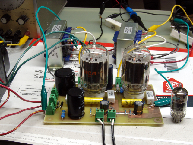

The first picture shows Amp 1.5 as it exists now. Picture 2 shows the "play with parts" method I used to get there. Picture 3, well people told me that you can't design an amp this way. Picture 4 shows the finished prototype, a small HiFi amp.

George, I have never seen quite that complex a rat's nest build added to an existing PCB! :D
Makes you wonder about all the amp builders who can only work from a physical layout, doesn't it? Without a mental picture of the schematic in your head, you simply can't do what George does.
I have done worse. I usually have a design in mind. I lay out a PC board, sometimes with just the basic idea in place, then add, cut, paste and hack away at it with flying parts, clip leads, additional PC boards or whatever to make it work, or I give up. Whatever is left over goes into the "box of broken dreams." I may get a new idea later down the road, and often these old boards form a place to start from. If I come up with a workable design, I lay out a new board and the process repeats.
This is an offshoot from the way we did things at work. I was a two way radio and cell phone designer at Motorola for 41 years. A cell phone can go through 10 to 20 board iterations before it becomes a product, and several more after it goes into production to improve quality or reduce costs.
In this case Amp 1.0 started out as a minimalistic design to prove a point....Yes it was a playable guitar amp with about $25 worth of parts in it, and it would have been sufficient for a person practicing or who liked a clean clear tone....I kept hacking, adding stuff, ripping stuff out and tweaking until amp 1.5 was the result. What the forum didn't see was the five different PC boards (1.0, 1.1.....) and the rats nest on each one to get there. Amp 1.0 had 4 tubes, a rectifier, a pentode preamp, and two output tubes. There was a 3 tube version, then three more 4 tube versions.
The clip lead rats nest seen in the last two pictures was an idea for a simple spud amp that was hatched and turned into a working amp in a single day with clip leads and a dead Tubelab SSE board. I drew up a paper schematic and laid out the PC board while on an airplane ride, made it when I got back, and it worked.
Sometimes I go the other direction. Amp 2.0 started out as an exercise in how to use all of the $100 parts budget to make a screamer. The schematic is in post #1760. I put every idea that I wanted to try into the schematic and laid out a board, actually there were two versions. One used the UL84, a series string version of the 6CW5, which is very similar to the EL84, and the other used an octal sweep tube. The schematics were identical except for the tubes being used. I started with a "Marshall 18 watt" schematic that I got off the web. I used tubes that had about half as much gain as a 12AX7, so I added a couple of gain stages and put a mosfet follower between each stage.
In that case many if the "wild idea" parts are not installed in the initial build. The minimum parts to make a working amp are installed, often one stage at a time until I am happy with the results, then the ideas get tested, one at a time. The amp had far too much gain, so most of the mosfets came out, and I removed a gain stage.
I liked the UL84 version a lot. It made about 20 watts cranked, and had a good tone.
I never got the sweep tube version working exactly right. In a moment of madness, I hacked the PC board to fit some EL34's and TV tuner tubes, connected it to a 400 volt power supply, and "tested" it with a real OPT.....Yes, the design screams and cranks out nearly 50 watts....there is hope for it yet. Note the "damper" on the first preamp tube and padding under the board. It was so microphonic that feedback occurred.
The sweep tube version has been found, but I haven't seen the other one in a few years. It's got to be here somewhere. I plan on revisiting it once I find it. Maybe amp 1.5 and amp 2.3 will meet with a rats nest together to make something really cool.
First three pictures are of the UL84 version with all of the parts installed.
The next three show the sweep tube version. Note all the empty holes in the board. It was built after the first board was debugged, so that all the stuff that didn't work, was never installed.
