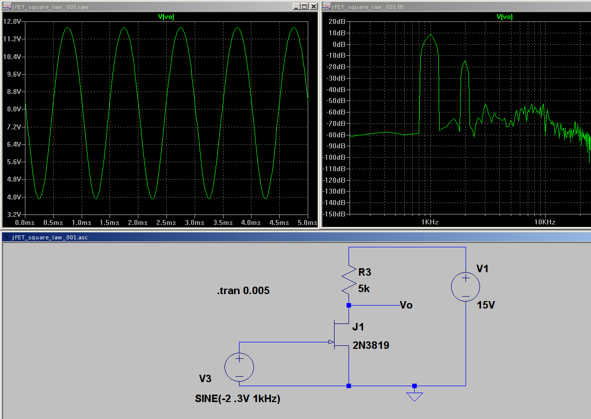

The theoretical voltage-to-current transfer function for a JFET is a square law, and a little paper-and-pencil math suggests that it should generate a good amount of 2nd harmonic distortion (and, within the limitations of the mathematical model, no higher order harmonics.)
Work has had me busy again lately, no time for soldering in the last few days, but I did throw a couple of JFET simulations together in LTSpice.
Simulation isn't reality, of course, but if LTSpice is even halfway accurate, it looks like the simplest of JFET common-source amplifiers (see attached pic) is all it would take to make a nice amount of almost pure 2nd harmonic distortion. This is the stuff that makes for a nice "clean tone" to a guitarist, based on my experience so far.
Drive the circuit a little harder (in the simulation), and the negative tips of the waveform start to compress as the JFET hits saturation. The Fourier transform then shows the usual picket-fence of harmonics emerging from the noise floor. Not just 2nd harmonic.
So there's a good chance that this circuit will transition from fairly triode-like cleans to slight overdrive as it's driven harder.
In LTSpice I cheated and biased the JFET by simply typing a DC offset voltage into the signal source; in reality one would need to add some additional circuitry. (The simulated circuit is entirely DC coupled, as it avoids having LTSpice simulate the relatively slow initial transient as all the caps charge up to operating voltage.)
BJTs behave nothing like this, by the way, in case anyone is wondering. Their exponential voltage/current transfer function makes nasty-sounding high-order distortion even at very low drive voltages. You can clean it up with negative feedback, but then you get the usual thin, sterile, cold, too-clean, solid-state guitar amp sound.

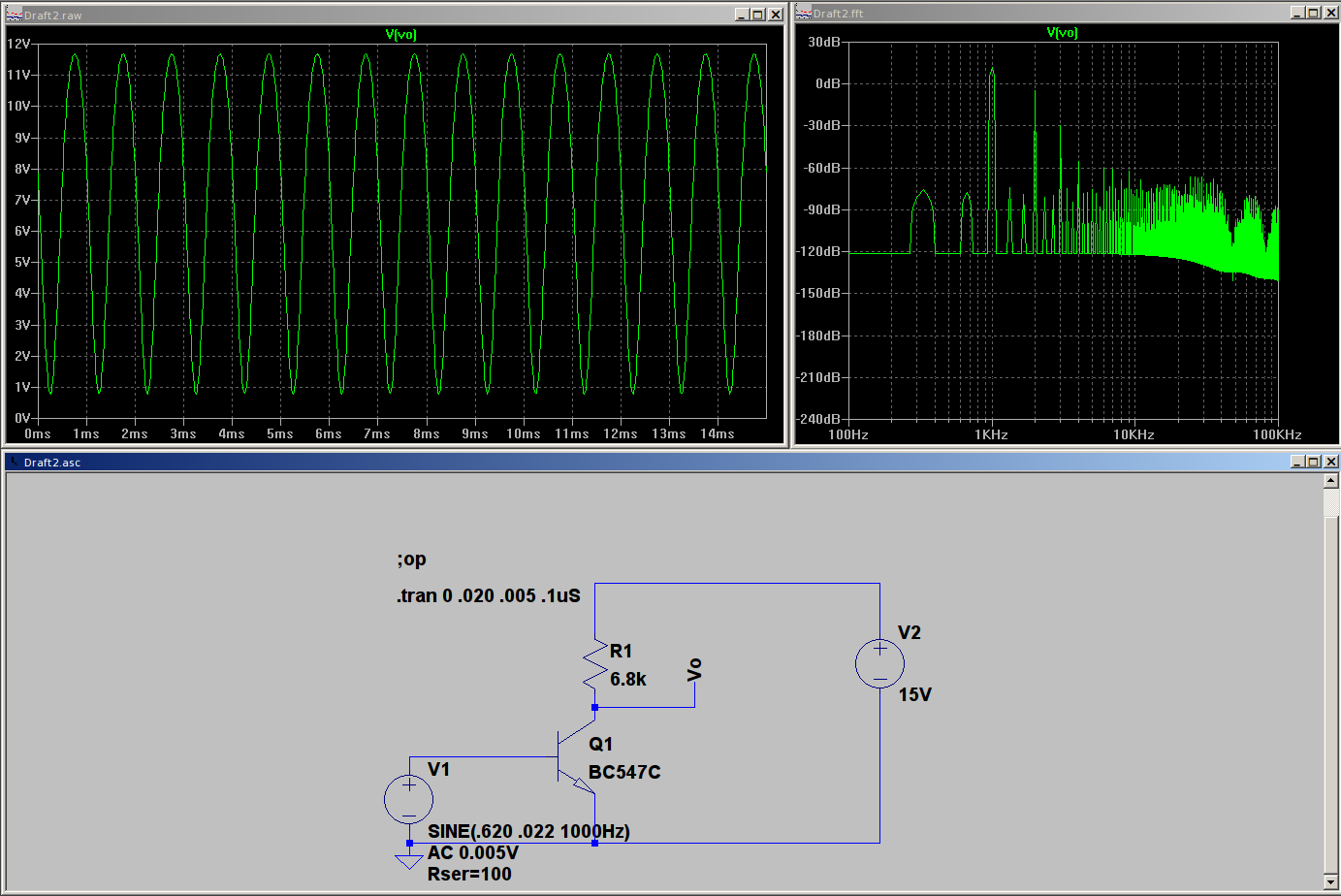

I know from experience that BJTs sound bad (harsh) when they begin to distort, and I know from theory why that's true (tight exponential transfer function generates a host of harmonics even for small input voltages.)
But I thought I'd let LTSpice loose on a single-transistor common-emitter BJT amplifier stage, to see what showed up, and to compare it with the single common-source JFET amplifier stage in my previous post.
As before, for simulation purposes, DC bias is generated by the input source, simply to avoid dealing with capacitor charging time-constants in LTSpice.
The attached screen capture is for an input strength of only 22mV (I think that's peak value in LTSpice). Even with this small input voltage, you can see a forest of harmonics, all the way out to at least the tenth harmonic(!)
You can also see a forest of non-harmonic frequencies, including sub-harmonics of the 1kHz input. There is lots and lots of intermodulation distortion going on here, in other words.
IMO bipolar junction transistors, and electric guitars, are a match made not in heaven, but rather, in Dante's ninth circle of hell. The two just do not get along!
Run an electric guitar into a BJT without feedback, and there is too much signal voltage, and too little input impedance, so you get nasty distortion and bad frequency response.
Run an electric guitar into a BJT with feedback, and you have sterile "too clean" tone, bursting into abrupt "too harsh" clipping, and there is still difficulty getting adequate input impedance.
