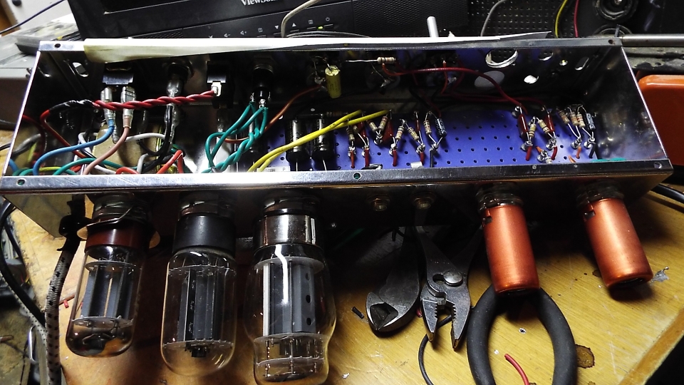

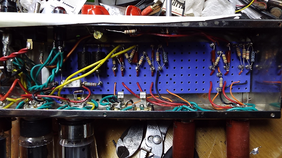

and here's a real rats nest for ya

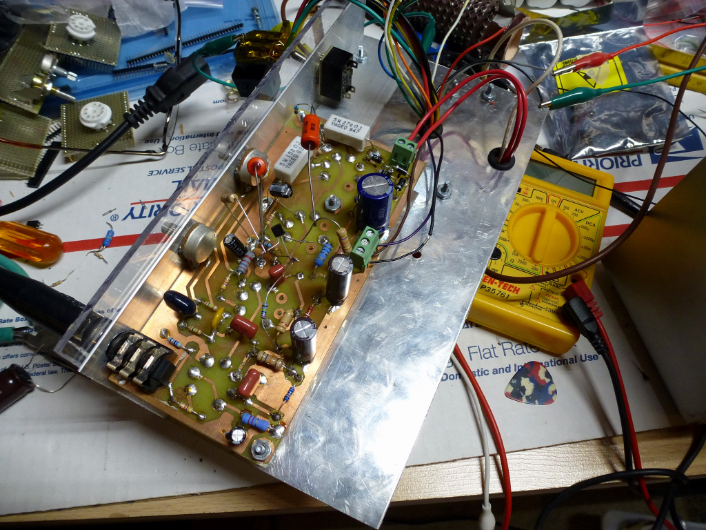

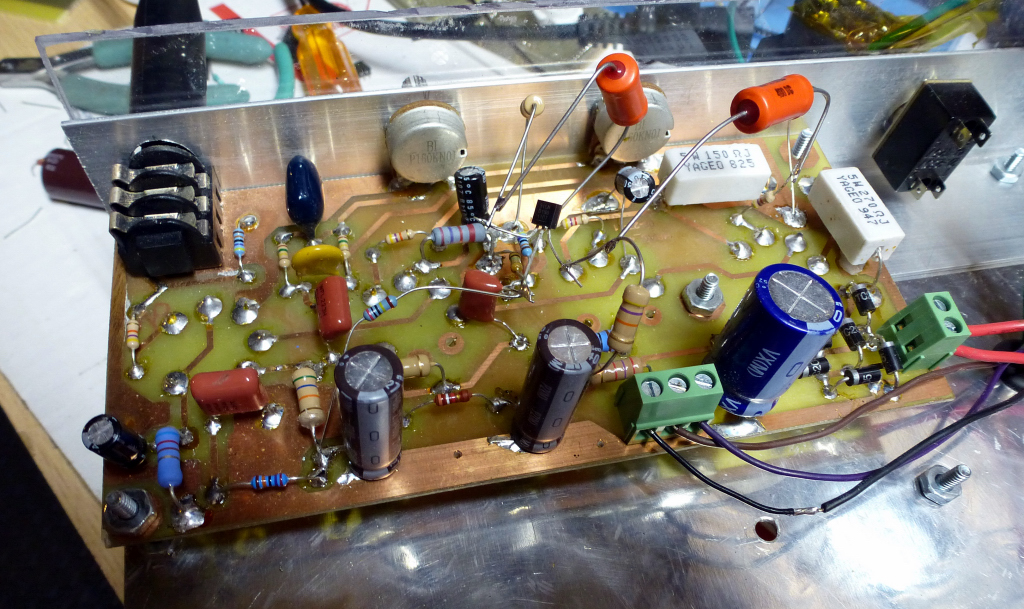

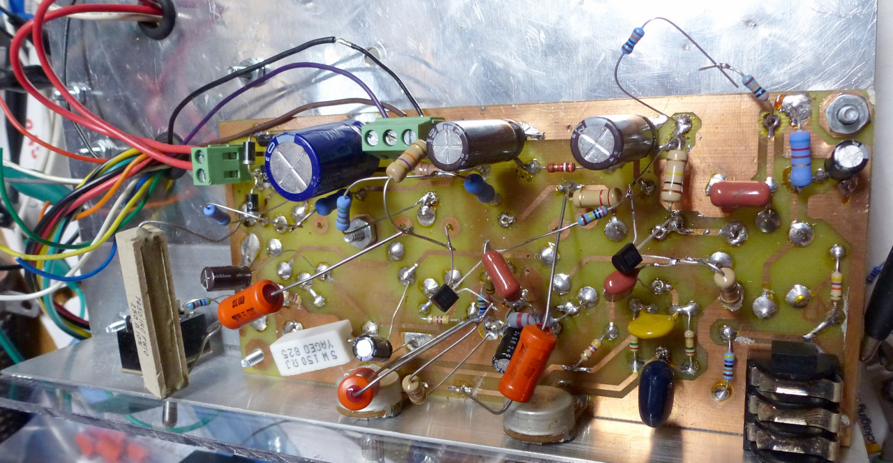

Yes, as threatened back in the thread somewhere, I stuck in the mosfet PI. It really fixed the amp up. The self split output stage wasn't clean and only made 1.9 watts. Now the output stage can make 4 watts at 2% distortion.....until you push it.

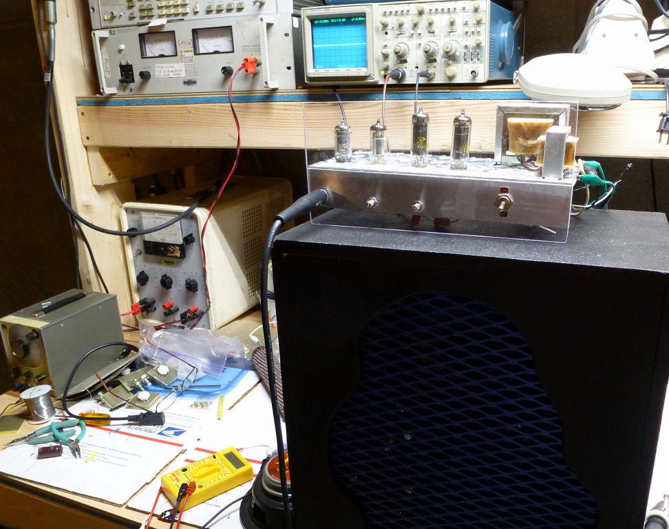

Sometimes a new shiny object will take over your mind, and reroute priorities. In this case it is an old and not so shiny object....Amp 1.4.

Well, last night I tried some random "circuit bending" with my little amp. The difference is that now I understand what I am doing. Well, positive feedback can make for some rather unusual sounds....More poking around today.

I spent the morning tinkering with the amp some more. I still haven't found the magic combination that will allow super nice clean tons, and still get nasty when cranked. The front end doesn't quite have enough gain. When I plug in my "Hammer of Thor" (DiMarzio pickups) it rocks quite well, but the $50 swap meet Squire Strat is clean with everything turned up all the way.
Tonight, I plan to move the volume pot to the right one stage and test some more.....
Maybe the right answer is to add a 5th tube.......
Have you tried lifting the tone stack ground
This simple circuit doesn't have a tone stack, just a single knob tone control. It isn't like any other control I have met, and I'm not quite sure where it came from. I think I found it in a vintage amp design, then warped it a bit. It will see some more tweaking before it's done. Yes lifting the .01 uF from ground does boost the gain a bit, not as much as I want.
The schematic as it was 4 years ago is in post # 1279.
I added a split load PI between the triode and the 32ET5's. It is wired up pretty much in the standard way, except there is an LND150 mosfet where the 12AX7 goes. I found this one day when I physically stuffed two mosfets into the 12AX7 socket on a guitar amp I made years ago. The gain stage didn't sound tube like, but the PI passes for tube sound since it has no gain either way.
