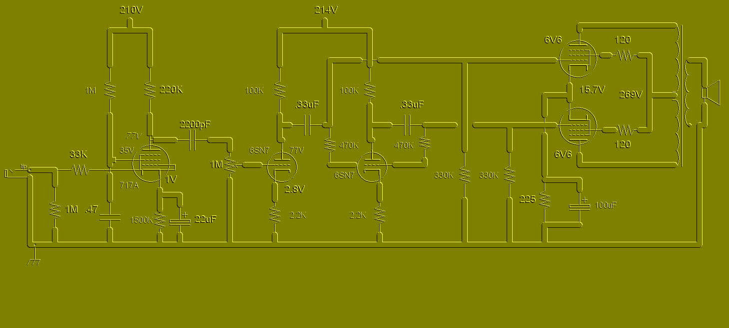

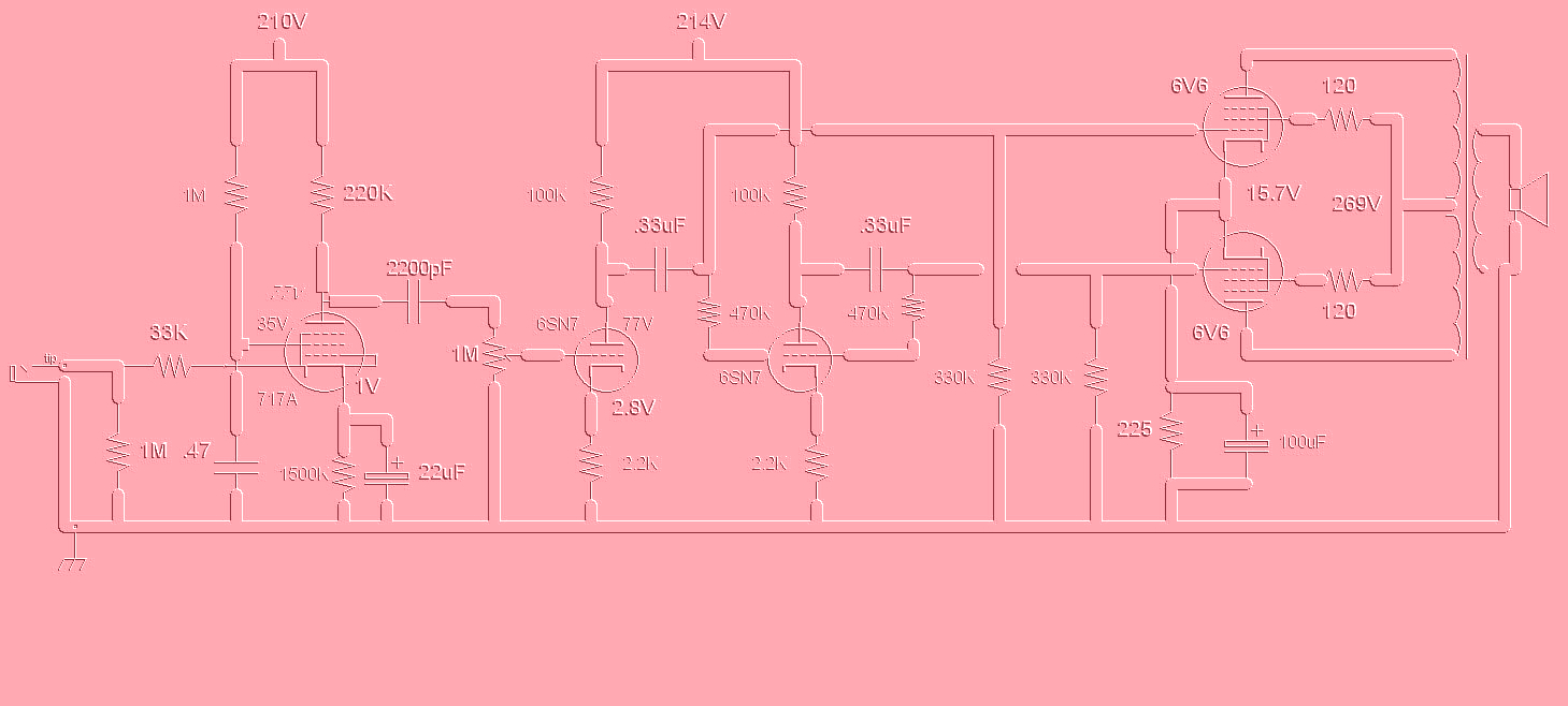

OK, here's my stuff. Power supply schematic is not ready yet. The audio file is just a guitar, an amp, a micro and a computer. No editing apart from crude copy and paste. I start clean, then crunchy and then volume goes to 12.
http://www.fileden.com/files/2012/4/4/3287729/717 taking off.wav
More details about the amp with my next post, probably power supply schematic too. This is a lot of work. Both are the same schematic, just choose your fav color (lol).

Thanks Wavebourn, I didn't electrocute myself yet. So far luck is on my side.
I see your first cathode resistor says it's 1500k - obviously you meant this to be 1.5k or 1500.
Yes, 1.5K. Big blunder.

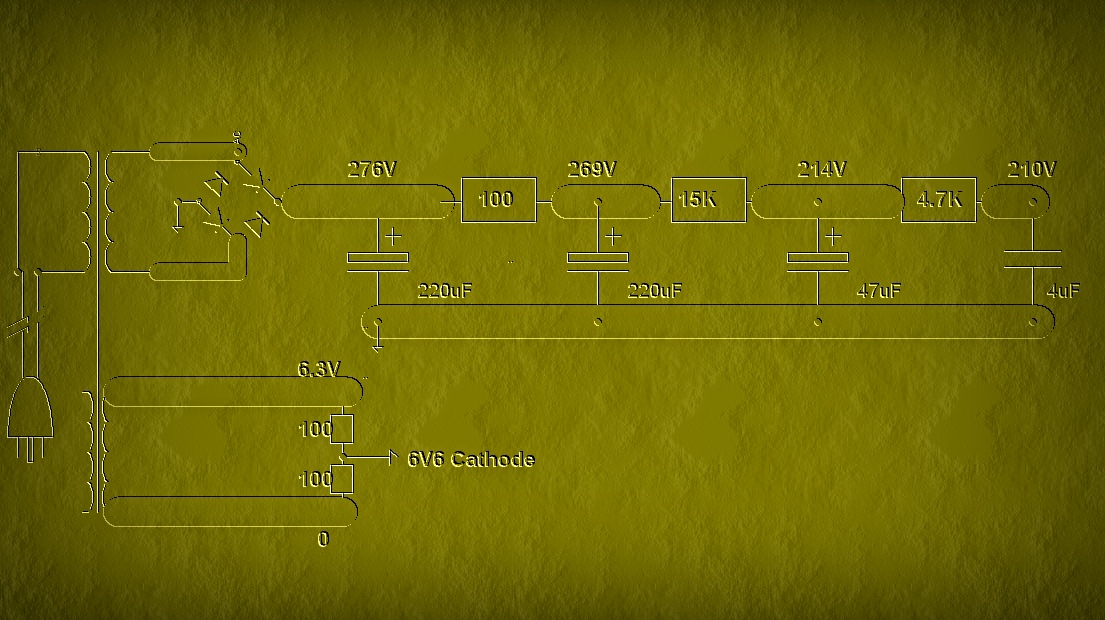

Power supply is here! I knew you guys couldn't wait so.......
Three more facts:
1. Power supply caps come from a dead PS, a dead CFL and the poly one is made here in Madrid. Proud of being crap, she is.
2. I did use my cheapest speaker for recording. Remember set up is under 100 dolla (guitar not included). It's a Celestion 12, can't remember its name...RockJunior or something. Ported cabinet.
3. Output transformer comes from a single ended radio. It has several primaries (0, 800, 1.6K, 3.2K) Center tap is 1.6K, serious mismatch in resistance, still, I don't pay the hum penalty.
That's all folks.
