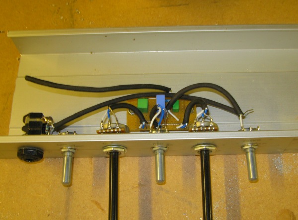

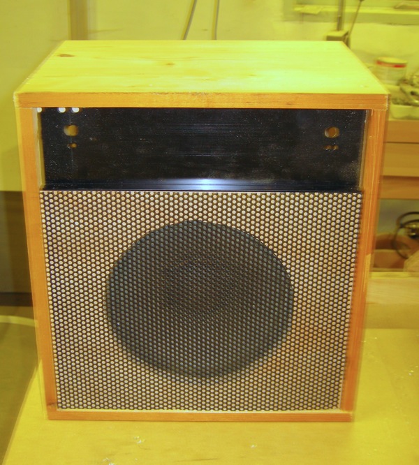

Pics as promised.
Firstly the cab, with a Celestion 8" speaker, no idea of the model as the label came off years ago, and then the old amp chassis with tone control. This chassis will be junked as it's too small to fit everything in.
I'll post pics of the new one once my camera batteries have recharged.

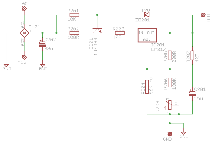

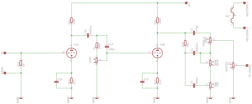

As promised, here's my working schematics - adjustable Maida reg so i can tweak the HV for the final design, and the worrking schematic for the preamp. I know this is a little off topic, but I'm posting this to encourage you folks to rescue me from chip amp oblivion.
I see one possible problem. The input impedance of the TPA1517 is 60K ohms. The tone stack expects something much higher. It will work but some value tweaking might be needed. The tone stack calculator will tell you if it needs tweaking, or you could put a cathode follower or mosfet follower after the tone stack.
Yup, I was pondering that myself. I'd like to keep the stack as is, so it's ready for a valve output stage, so I think a mosfet follower may be the way to go. A valve would be nice, but I only have one ECC83 in stock at the moment.
