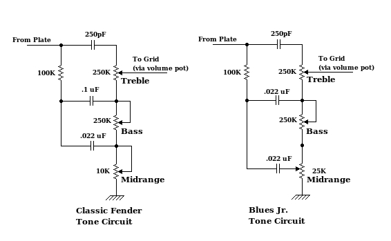

Does anyone know why the Blues Jr. tone circuit connects the midrange tone pot wiper only to the .022 cap whereas the old Fender circuit connects it both to the connection between the bass pot and the midrange pot and the cap?
I see that the Blues Jr. version prevents the bass wiper from being at ground when the mid wiper is at ground, whereas in the old Fender circuit, with bass and mid at ground, there is zero ohms to ground from the bottom of the treble pot. In other words, in the older circuit, with all tone pots at minimum, there is zero signal to the volume pot, whereas in the Blues Jr. there would always be at least 25k between the middle capacitor and ground. And because of the bass cap difference, the minimum configuration puts only .022uF at least 25k above ground (instead of the .1uF it would be with the cap in the older circuit).
Does the Blues Jr. not need as much bass boost/cut as the bigger amp? Because . . .
The Blues Jr. also uses a .022 for the middle cap (whereas the old
Fender circuit uses a .1 uF), and the midrange pot is 25k (instead of 10k as in the older circuit). I halfway understand that more than doubling the size of the bottom pot makes the Blues Jr. circuit somewhat equivalent to the other such that the two .022 caps add to .044 which is almost half of .1 and makes the RC product (in some settings) about the same. Still, it looks odd. In the Blues Jr. both lower caps are .022. In the older circuit, the middle (bass) cap is .1 and the lower (mid) pot is .022. The older circuit makes sense to me. The Blues Jr. is a question mark. But I may want to attach the .022 cap only to the wiper of the 10k pot, changing only that feature of the Fender original circuit. That way, some mid always gets though as a baseline signal. But perhaps its better if all three bands can go to zero. Any thoughts on this out there?
Anyone have any thoughts about the difference between wiring the bottom pot as a potentiometer as opposed to a rheostat?
--Tubekit
Classic Fender Tone vs Blues Jr. Tone circuits
Here are the schematics for the two different tone circuits.
Can anyone comment on the relative advantages or disadvantages of one circuit versus the other?
What would you expect to be the sonic difference?
--Tubekit

Is this the schematic that you're talking about:
http://support.fender.com/schematics/guitar_amplifiers/Blues_Junior_schematic.pdf
The middle control is a shelving circuit, as long as the pot is not set to zero ohms, the cap (C13) and mid control resistance determine the center frequency of the shelf. The mid control R also sets the height of the shelf. C13 is a shunt to ground through the pot. This shelf contour is very much like baffle step compensation but also probably provides some shaping for the speakers midrange response. It makes sense to choose the cap value based on the cabinet size and the speakers response curve. The mid circuit becomes a first order low pass when the pot is set to zero ohms, then of course the treble circuit with a low 250 pF cap allows some HF to pass.
The bass control is a first order high pass circuit where C11 is like an interstage coupling cap with the bass control resistance providing a variable cutoff freq.
The above assumes no interaction of the circuits and I've used simulations to get a better idea of what is going on.
I don't think it makes sense for the output to go to zero when the pots are set all the way down since they are intended to provide some shaping, not 100% attenuation.
This is a crude circuit and many are familiar with it as a result of the widespread use over so many years, but it seems to provide a significant improvement in the sound.

The smaller bass cap helps to avoid speaker excursion overload with smaller, fewer, or less capable speakers. The original .1 uF was sized a bit large anyway.
The Blues Jr. mod fixes the issue of zero output with the pots all the way down. The behavior of the circuit is a bit odd with the bass pot all the way down, especially as the mid pot goes all the way up - again it is a crude circuit.
With the mid toward the bottom of the pot it acts as a shelving circuit in combination with the 100K R, but toward the top with the bass down the two caps are in parallel lowering the cutoff freq of the bass HP.
Wow, beautiful! That was the kind of answer that I was looking for.
Yes, I thought that this was a mod that specifically addressed the single, smaller speaker in the Jr. It's just that with the two lower caps at the same value, the visual impression is that the bass control has been gutted, not simply "tamed".
"[midrange] toward the top with the bass down the two caps are in parallel lowering the cutoff freq of the bass HP."
That's the part of it that I understood. And with the increase in the Midrange pot from 10K to 25K that compensates almost equally for the decrease from a .1 uF bass cap to the combined .044 of the two caps.
Yes, odd with the bass down and mid up is what I expected, and want to avoid, since many people like a boosted mid which then effectively requires some cut in the bass and treble.
Hmm. I think I'm going to try the circuit with the original cap values and control excess excursion by not turning the bass all the way up. I'll stay with the 10K midrange pot, but connect it as in the Jr. circuit.
Or maybe I'll go to a .047 for the bass cap.
Somewhere in here I sense the possibility of a compromise between the two extremes of crudity.

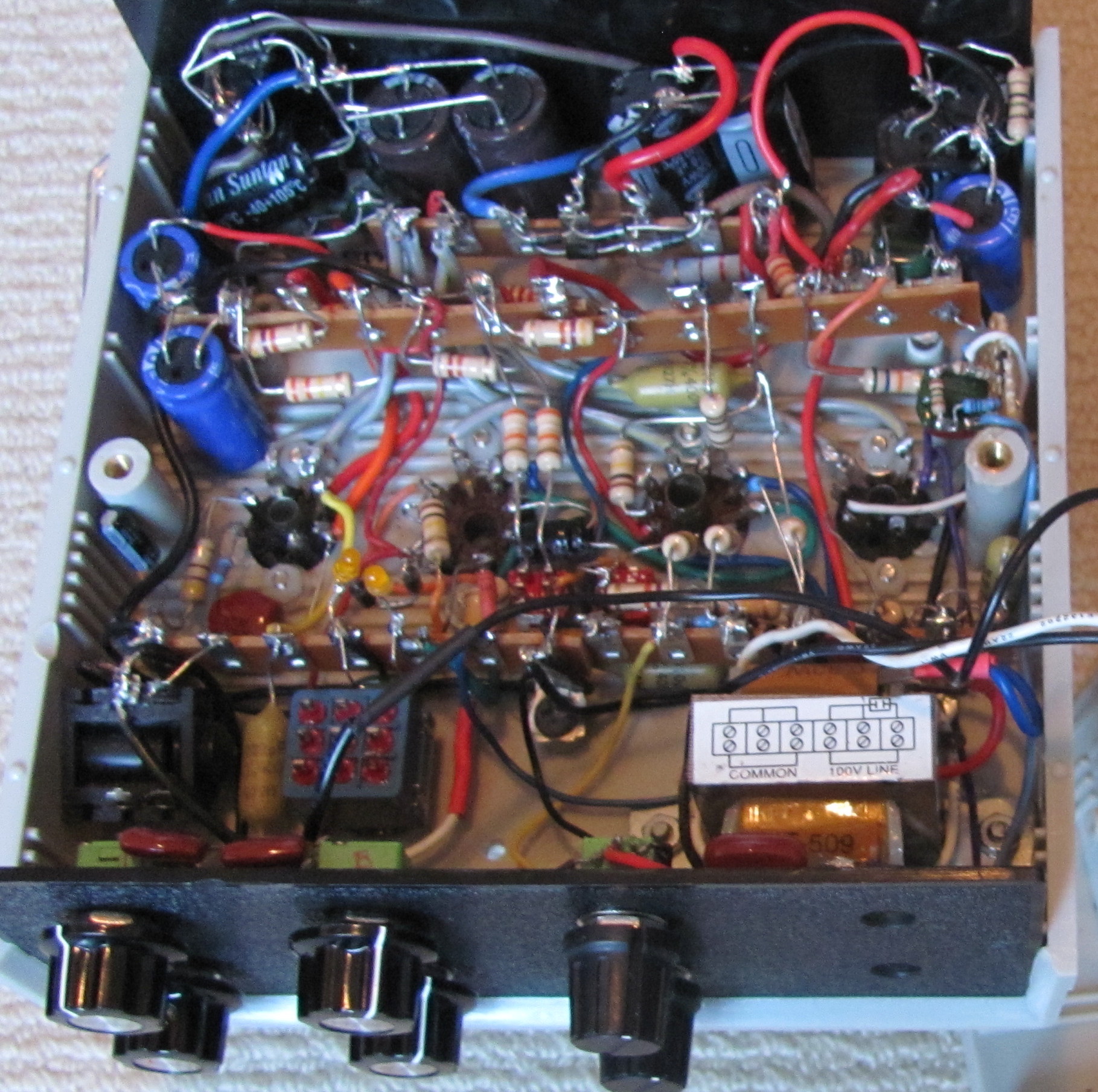

Since it has been quiet.
Not the best thing that I done but it is getting there. Bit of work to do on the other side of the circuit board and then start wiring up to the tubes. I have jumper wires in place for the plate, cathode, and screen resistors for the preamp pentode, still have to play with the values and it beats swapping parts on the board. The couple of parts that are standing off the board are also temporary till I pick up the right ones.

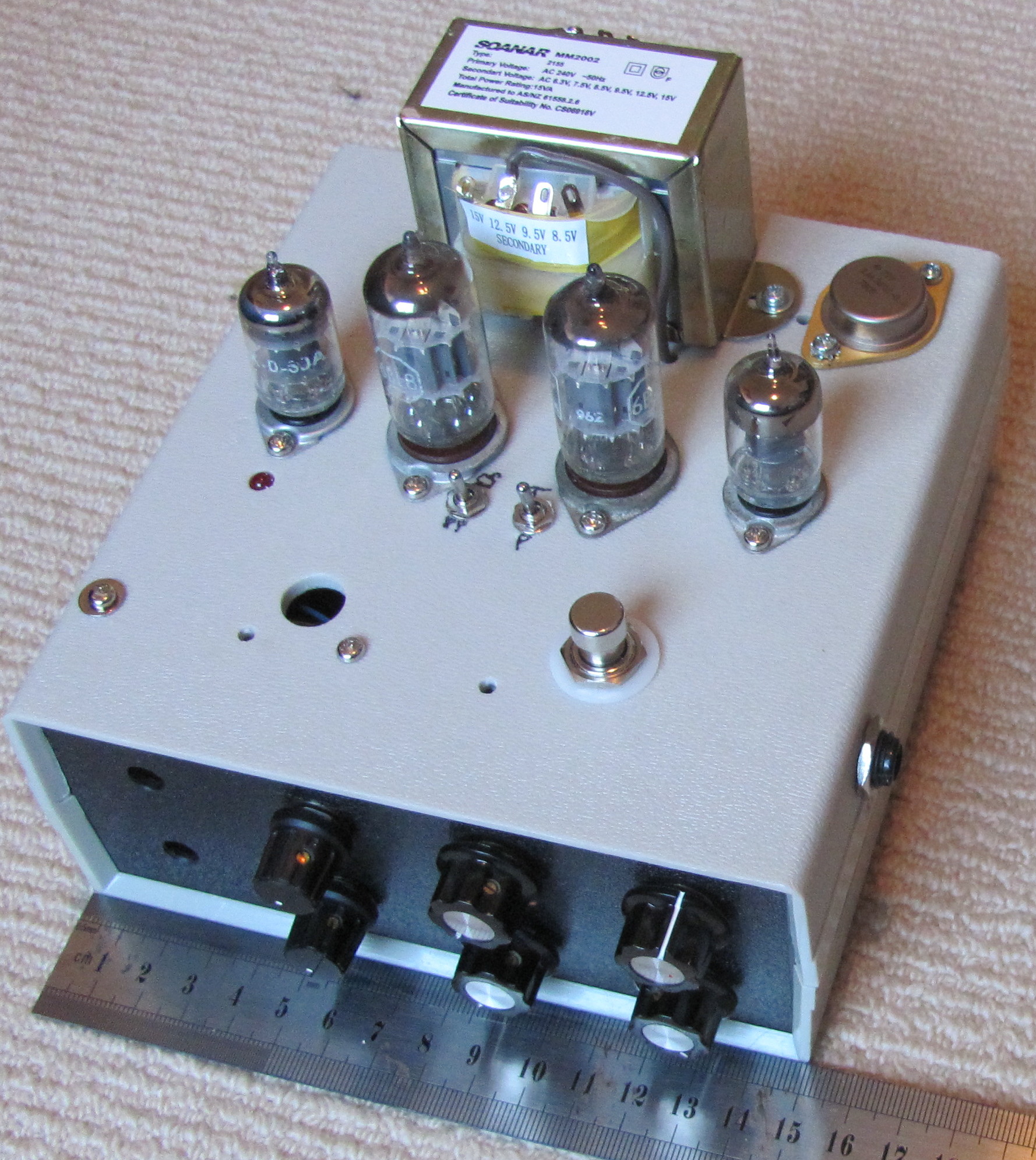

Thought I should check in for a few minutes and bring you folks up to date.
My entry in this contest was not going to be anything innovative. Due to my limited electronics background, I concentrated on building a solid, affordable variant of an established design. My circuit is simple; looking very much like a Fender 5C1 Champ or a Gibson GA-5 Les Paul Junior. Basically a 300-0-300 @ 75 mA power transformer, 5Y3, a lightweight LCRCRC filter section, and a 6SJ7 driving a 6V6 (or a 6EY6 in my case), into a 5K:4 ohm OPT.
Initial breadboarding was quick and easy, but then came the tweaking. All my iron was ordered new from Edcor, and this presented an unusual problem -- the inductors were simply too good. The XPWR014-120 power transformer, although rated at only 75 mA, is nearly twice the size of the vintage 70 mA Hammond and Thordarson transformers I have. The power supply simply will not sag. Similarly, the GSXE10-4-5K output transformers are huge compared to the original Fender and Gibson transformers. The output transformers refuse to overload and break up at maximum volume. Driving a Peavey Blue Marvel 8" speaker, the sound remains far too clean.
So I reached the point where I had a nice little four-watt monaural hi-fi, but a pretty unsuitable guitar amp (unless one was using it for acoustic folk or classical guitar, perhaps). I was about to tear down the breadboard and replace the inductors with something less robust -- and then everything got put on hold.
