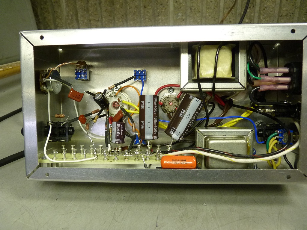

Here are the guts of the little 6AF11 amp.
Neat, compact, cool
Cheers, JimG
Very compact!
Nice job...
I used a compactron in an amp once and found it would be on the verge of squealing at full gain.....It took a quite a few iterations to eliminate the squealing oscillation but I finally got it out of there.
I have waffled back and forth on the compactron amp idea. I started one on perf board with sky wired parts and clip leads. It was a good multi frequency radio and TV jammer so thats where it stopped. I may revisit it if there is time but it doesn't look good. There are 3 pin comaptible tubes that fit. The 6AF11, the 6AS11, and the 6BD11. They are all in good supply and two are on the dollar menu.
My design uses two tubes. The high Mu triodes are the preamp stages the medium Mu triodes are the PI and the pentodes are P-P output. I get about 10 watts out of it cranked. No distortion numbers or clean power readings were taken since I never tamed it. I started a PC board layout but came to realize that trying to use two tubes with the signal going back and forth between them isn't a good idea. The layout could not be optimized.

Personally I hate doing ship-in-a-bottle builds. But whenever I have lots of space I get ideas of adding features and the space just disappears. That being said, I see room enough in their for a reverb loop (hint, hint). Just kidding.
I really like it for the compact size but it was difficult to wire. I had the circuit jumper-clipped together on the bench and had it working, but low and behold when I mounted everything in the chassis, there was that pesky oscillation again. Stupid wiring mistake on my part.

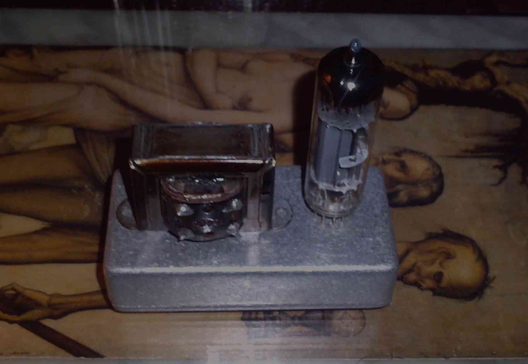

Then you gotta love this one. I have a soft spot for small and cute things but....damn, I'm beginning to think I bought too small a chassis. LOL. That OPT (believe it or not) was the partner of an ECL86 output tube (vintage reel to reel tape recorder).
That's what she said j/k
Is that a pedal box? I think I have a couple about that size setting here. I always planned on doing one of those 6021 sub-micro amps but never got around to it.
Yeah, that's for a pedal box.

Ah, the 6AF11... what a heartbreaker. I have come to the conclusion that the 6AF11 and it's ilk are not suited for beginner-to-intermediate builders, especially in high-gain territory. The issue is that triode 2 and the pentode are in close physical quarters, which can lead to feedback issues from plate-to-plate capacitances. Ok, so run them so that the plates are out of phase, right? That might work, except that the pinout puts the grid of triode 2 right next to the plate of the pentode. So your wiring must be immaculate to prevent all possible positive feedback between those two tube sections. An experienced designer could probably create a PCB that minimizes the pinout problem, along with a judicious use of grid stoppers and HF rolloff. Crazy wiring to an external board with slightly too long wires just doesn't cut it...

What I get from your post is that you don't believe the amp I built works.
It actually works well and sounds great, from low to full on, with no oscillation as long as the correct biasing and other values are correctly chosen. The wiring is not critical and does not have to be immaculate as you can tell by the closely packed wiring in the photo I posted earlier. I'm also using AC filament voltage. No noise or hum. Like I mentioned before, the circuit I built runs in triode/pentode and with or without negative feedback.
