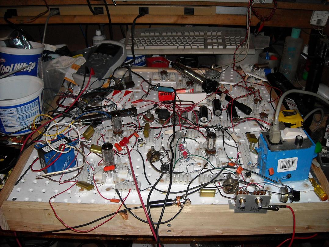

Glad to see another mess of wires. I am not as embarrassed by my picture now.Had to replace rear brakes on the truck today, Yesterday I don't even remember but I know I was not in the garage. Tomorrow I promised to do a cook-out and go to "Jonesboro Days"

350V and 375V were not very interesting after 20 minutes so I cranked it up a bit.
Seems applying 410V to tubes designed for 300V max, along with 16W plate dissipation on a 4W rated tube may result in faulty operation.
Although, after I killed power and let it set for a while and then powered it back up at 250 It seemed to run fine. They never did red plate, but one tube did start flashing.

I had a dilemma. What is it to be, a bedroom amp or a, well louder bedroom amp? The self-split worked well enough and was plenty loud either distorted or through an efficient guitar speaker. But using it with a measly little 8" I wanted a little more clean volume. I wanted to build the low power circuit for this contest but ultimately I want the higher power circuit. I did not want to do two builds so I have been delaying putting solder to part.
Well I think I came up with a way of having my cake and eating it too. Mind you to get the higher power will I have to use a bit of SS boost because I will loose a gain stage for the cathodyne PI. Now just to figure out how to do it with just one switch.
I'm still plagued by oscillations.
The amp has no GFB.
I suspect either layout (breadboard) or power supply feedback. When it happens I get the signal all the way back to the grid of the first tube.
Breaking the signal path at the output of the tone stack or any point after that stops the oscillation, but disconnecting the output of the first stage to the tone stack does not, but does reduce it.
It's really frustrating
The amp has no GFB.
Have you tried moving the feed for R3 back to V1?
I take it is high freq oscillation? Do you know the frequency?
You should suspect grounding also, keep the higher current output
grounding independent of the input stage grounding.
Did you consider having your gain control in front of U2? Not that it
would help the oscillation.
I take it those are triode and pentode sections of the 6DX8s, I would
think that it would be better to keep the triode sections closer to the
output stage since there is likely some leakage from the pentode to
the triode so the lower the gain the better. I'm thinking swap U1 and
U2.
If this is the issue, you are getting positive feedback through the leakage,
you could try swapping the drive for R31 and R32 to make it closer to
negative feedback. Still I think the previous solution is better - if it
works but you could try either or both.

Not sure if this would be helpful or not, can't see it hurting though. How about running without the first tube but with the tone stack and then shorting out each capacitor or resistor one at a time. It should not effect the circuit but then again you should not be getting feedback.
Boy I can not wait to hear your amp, looks like it has a lot going for it.
Got the power amp working and am getting 12.5W clean with 6V6s types (7408) and no feedback, 15W with a touch of clipping. Frequency response is 35 - 60KHz -3dB points and I made no effort to use large coupling caps so not sure how much of the low end limit is the transformer. I'm using the output transformer from this gutted integrated amp but also have one chosen for the final design.
