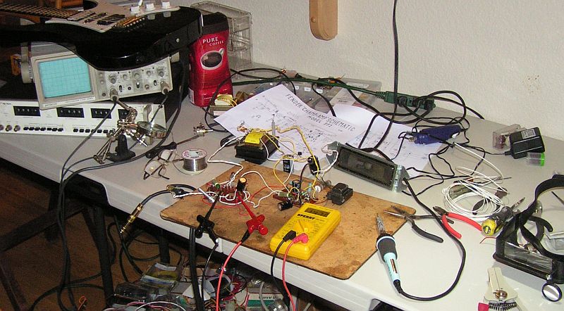

OK, well, I've been thinking about building a guitar amp for probably 20 years, much more seriously for the last 5 years since my son plays. This thread got me going to sort through some of my very old parts. I have a real lot of "junk" for a person who is not that into tubes. A friend gave me an old Realistic integrated stereo tube amp for "parts" many years ago. I told him several times I did not want it, LOL, but he insisted. It had 6BM8 outputs, and was a rather odd design so I gutted it to use for some tube preamp experiments and it has been sitting ever since. Today, it would probably go for $200-$300 at that site but who would have known back then!
I'm going to use this to do some prototyping and I had planned, years ago, to do something with a small 20-40W power amp for testing. I have a good number of octals, 5881, 6L6GTs so I cut the chassis to take octal sockets for the outputs. Rebuilt the power supply and am getting +380V no load, 340 at 100mA with 5881s in the outputs.
