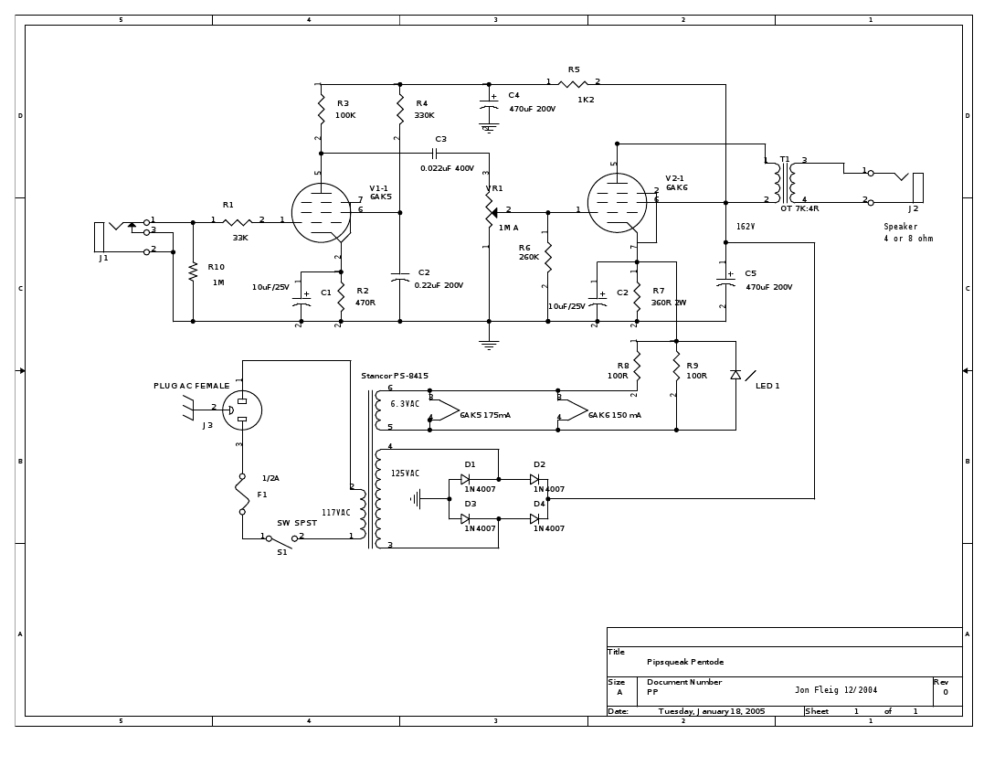

I just stumbled onto this web page: Pipsqueak pentode DIY guitar amp
Looks like a neat design, and his links to other successful low-power designs should get me back on track.

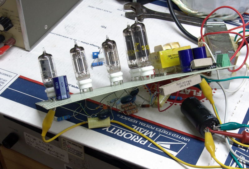

I put amp 1.0 aside for now. It's kinda dead. Amp 1.0 was based on old radio tubes that run from a 150 volt max supply. It sounded best right before it blew up on 320 volts!
I started building amp 2.0. Amp 2.0 is based on old TV tubes.
The parts in both designs were chosen based on world wide availability and at least 1000 of everything in stock somewhere.
