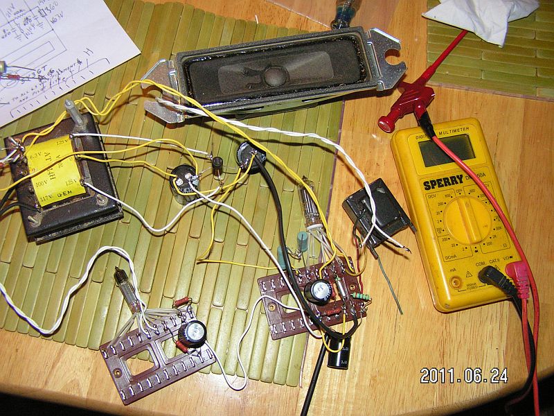

Just finished my quickie build, just bread boarded it to see what it would do.
I did not want to go SE because I wanted a cheap output transformer that anyone could pick up. I wanted to try a 70 volt line transformer, a 120V power transformer, and a 12V transformer for the heaters. Did not do a cost breakdown yet but it should get under the $100. Sounded not too bad clean although without a efficient speaker, used a 8" paging speaker that would be used on a 70v system, the level is just barely adequate. Used a 12" which is around 97dB and it is livable. Turning things up both are loud enough if you do not mind some distortion.
Not sure how much farther I will go, do not really care to compete, just wanted to give it a try.

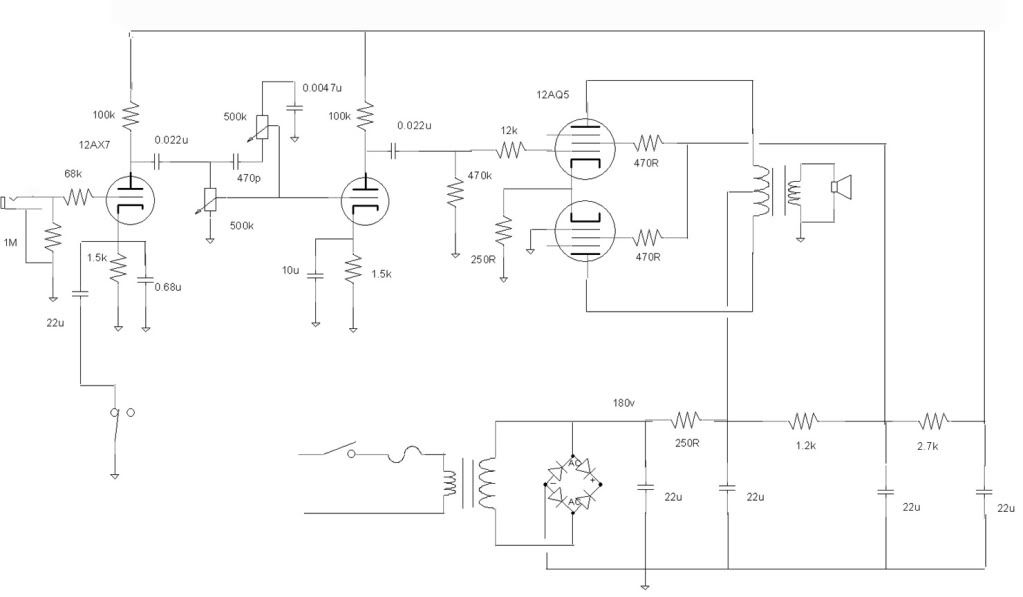

You might think about a bypass cap on the cathode resistor, usually on the 6AQ5's I use a 50uf/50V. This seems to reduce some of the raspy distortion and firm up the bass a good bit.
Fender used a 25UF on many of their cathode biased amps.
Remember, a bedroom amp will not be overly loud and distortion is generally sought after by the average player.
YMMV
YMMV
Look again... the cathode resistor isn't bypassed since it's a self-split design - it's the only coupling to the other half of the push pull output stage.

I would like to give the person the option to play clean or dirty. With another volume control after the second triode the amount of grit can be dialed in and the volume can be played at whisper levels. Might not be output distortion, but at those levels I am not sure how much it matters.
Bumped up the voltage to 220V, like it better. With a 12" (12" ET65 - 65 Watts | Warehouse Guitar Speakers) it gave a good account for itself. With a 10" (10" Veteran - 20 Watts | Warehouse Guitar Speakers) a few dB quieter and a less thick, more delicate sound, like them both. The 8" also sound ok, a little smoother and quieter, maybe 5dB as compared to the 10".
Tried it with a VVR to knock down the volume, need to change some values to get it down below 90V, tone stayed more or less the same but I do not think it is worth the effort and the added cost as compared to a master volume. Probably more value in having separate bass and treble controls.
With the 12" and the 10" you can get fairly loud if you are into a real distorted sound. I need to bump up the grid stoppers a bit for playing with the controls pegged. Mind you my lead dress does leave much to be desired as you can tell. All in all I am impressed what you can do with a 4W 70V transformer.

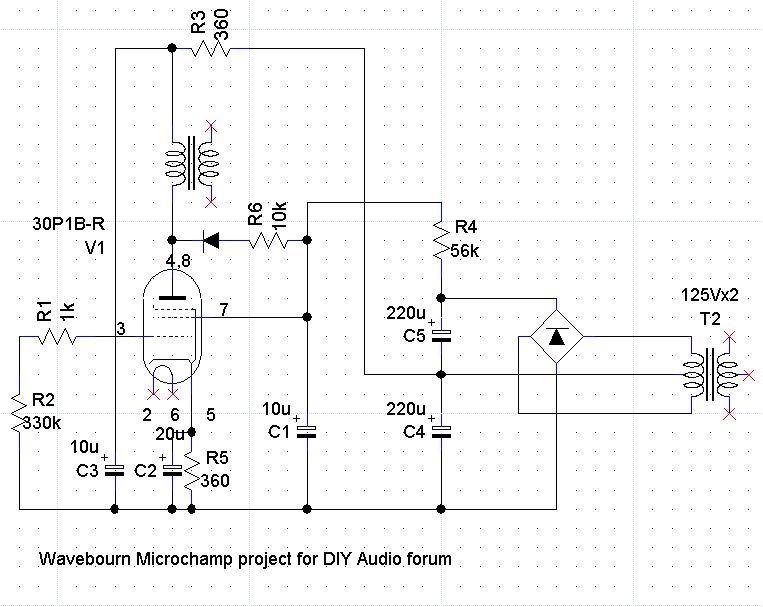

What input Z does that 70V distribution OT present? I'm thinking of using a 6.3 V (about 8V unloaded) filament OT which has two 120V primaries which would present around 7K P-P.
Estimating the input Z for the 70V OT:
Watts = 10 = V*V/R so V secondary = SQRT(80) = 8.94 Vrms
Assuming 70 Vrms across each half to the primary. So N1/N2 = 140/8.94 = 15.66
So NxN = 245.23 and Zpri = 245.23 x 8 Ohms = 1962 Ohms P-P
(which seems a bit low for a 6AQ5, but putting that into Circlotron mode would get 4x 1962 = 7848 Ohms P-P )

I looked at the transformer again, I was wrong, I am using a 10W rather than a 4W. I have a few and the funny thing is the core size is the same on them both.
Anyway the one I am using has taps for 2.5W, 1.25W and 0.625W. The ratio between the 2.5W and 1.25W is different than the 1.25W and 0.625W, I thought it would cause me some trouble but it does not seem to be. I measured the ratios but I can not find where I wrote them down now. For hifi the imbalance may be an issue but it seems close enough for R&R. I also have a 4 and 8 ohm tap so I can double or half my impedance. I also have a 8 and 16 ohm speaker that I am using. Not being one to sweat the details, I changed ratios on the tubes, going low and high. In the end it seemed any combination worked. I am in no danger of red plating the tubes so they seem to be taking what I throw at them. Not like I am trying to squeeze the last watt out of them anyway. I think you can get a slight change in sound but then again you also do with changing the voltage on the tubes. I also swapped out the 12AX7 for a 12AU7, less gain naturally, with a telecaster you can get a nice clean with enough breakup to make it interesting with guitar and volume controls on full.
I think the amp is more forgiving of the impedance since it is running in Class A rather than Class AB. Tried it in triode mode, still was able to rock out. Know that I know it has enough gain with a 12AU7 I think I will try a 12AU6 on the front end next. I am having more fun with this little guy than I thought I would. I have not even bothered to turn my scope on to see what really is happening. Maybe later.
Speco T-7010?
I think the 70V transformer is meant to tap it's rated power from a 70VRMS audio signal when loaded with the specified speaker load. So the various primary taps are by my reckoning:
10W => (70^2) /10 => 490 ohms
2.5W => (70^2) / 2.5 => 1960 ohms
1.25W => 3920 ohms
0.625W => 7840 ohms
Cheers
The constant voltage system is based on 70.7 volts in the US 100 volts elsewhere when the electrical codes don't prohibit it. The idea is that power is voltage squared divided by resistance. So 70.7 squared is 5,000 and 100 is 10,000. It made the math easier. So 1 watt at 70 volts should be 5000 ohms. A 5 watt transformer would have the 5 watt tap as the center tap and the common and 1.25 watt taps as the ends of the coil. The more turns the higher the transformer ratio and the higher the impedance. The center tap will always be 1/4 of the highest impedance value. Of course that ignores winding losses.
