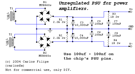

the RC snubber should be placed as close as possible to the diodes.
The film caps?? They are not meant to be Diode snubbers, but are
forming a Zobel network, that actually enhance the sound.
Don't ask me how it does that
Steen.

No, it should be placed as close as possible to the chips.
But it's not practical to use them on-board, and I think local bypassing is more important.
Small caps on the chips, as close as possible to the PSU pins.
The snubbers after the last big caps on the PSU.
Anyway, maby the snubbers will also work fine right next to the rectifier diodes.
On-Semi says to put them next to the diodes. The snubber compensates for the ringing caused by the transformer secondary inductance AND capacitance of the MUR860's --

Guys, the snubber makes a very marked (and positive) effect to the PSU and the sound of the amp.
That you can listen immediately.

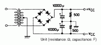

I'm using a STK 4152 II chip and the recommended PSU uses 2 caps of 10000nF and 2 resistance of 500 oms.
My amp is using 3300nF caps but I don't know the resistance values
So, if I change the PSU for the recommended one, should I install the snubber ?
See picture. It's the recommend PSU.
![apathic :apathic: :apathic:](https://files.diyaudio.com/forums/images/smilies/apathic.gif)

steenoe said:100nF film caps were also used on the pcb's. Have a look at the BrianGT boards used for this project.
Hi Steen, is this amp non-inverted?
Cheers
I picked the wrong file, that schematic missed a black dot that indicates that the two snubber caps join at the ground point.
Small detail, but someone may be in doubt.
I know someone will ask (nevermind... already did).
Here's the revised schematic.
