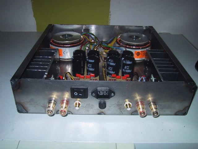

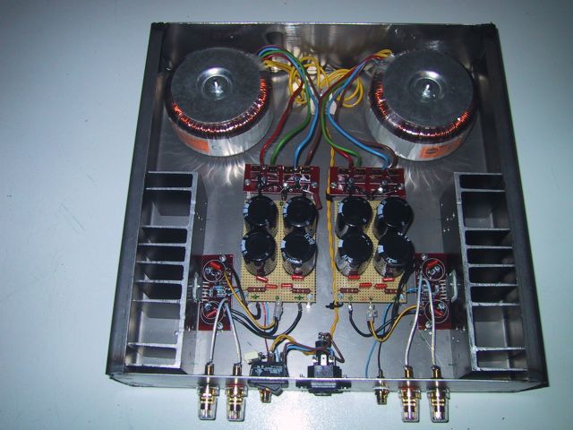

Well, that Norwegian guy isn't the only one to try that PSU.
I build two of these amps on the pic for a friend. They sound great.
Dual mono, 40000 ufd per channel. Otherwise made excactly like CarlosFM's
schematic. The transx's are 300VA each 2*22volt sec's. He is running a biamped system and sold the other poweramps right away, after hearing these two chipamps. He is impressed and so was I I am a little stunned after having heard the power they
are capable of delivering! Thanks Carlos for boiling all the available info down to something really good.
All that wouldn't have been possible without the 'snubbers'
Steen.

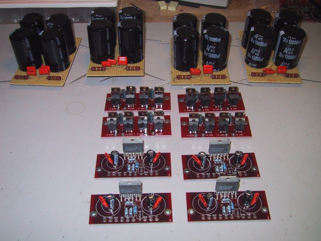

These 2 amps were made with 100nF film caps throughout.
That final schematic has been posted before.
CarlosFM, you must have spend quite a few hours soldering and listening Thanks for sharing your efforts with all of us
100nF film caps were also used on the pcb's. Have a look at the BrianGT boards used for this project.
Steen.

Here is a pic of the rearside of those amps, in case you care?
The binding posts were ordered from Taiwan, of all places!!
Very cheap, and very good quality. Can take a serious speaker-cable.
Steen.
