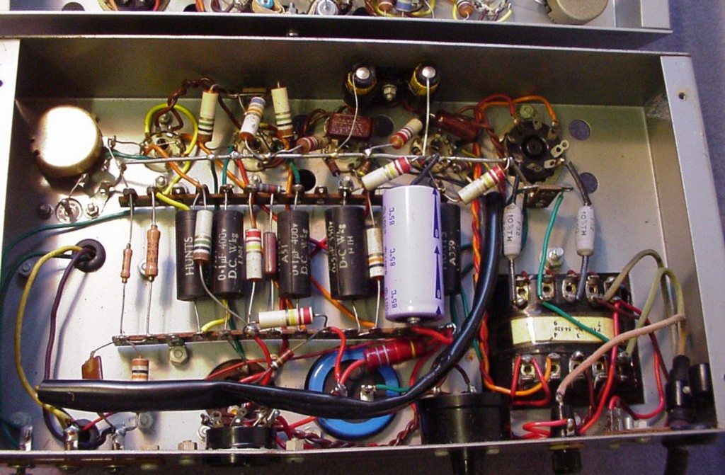

I had a pair and wish I had kept them - they were superb. I replaced all the caps with new (an easy job - it's all hard wired) and the resistors with equivalent 2W types to keep thermal noise down. I found a great improvement in the sound quality by removing the feedback resistor bypass capacitor - these things really sang! I didn't experience and problems with oscillation as a result but that was just my experience and I am no expert. I sold them to a friend to bring him into the valve community and he has enjoyed them ever since!

Nice tip on removing the feedback cap, thanks.
Is it the MA-12's you had ?
I just caught up on the thread, having started to look at mine again.
Issues with the chassis' resolved...
...simply need a bigger chassis / s.
Has anyone tried dropping in a few motor-run caps, here & there ?
Any good tips from peoples, on any aspect of refurbing MA-12's / Mullards, most welcome...

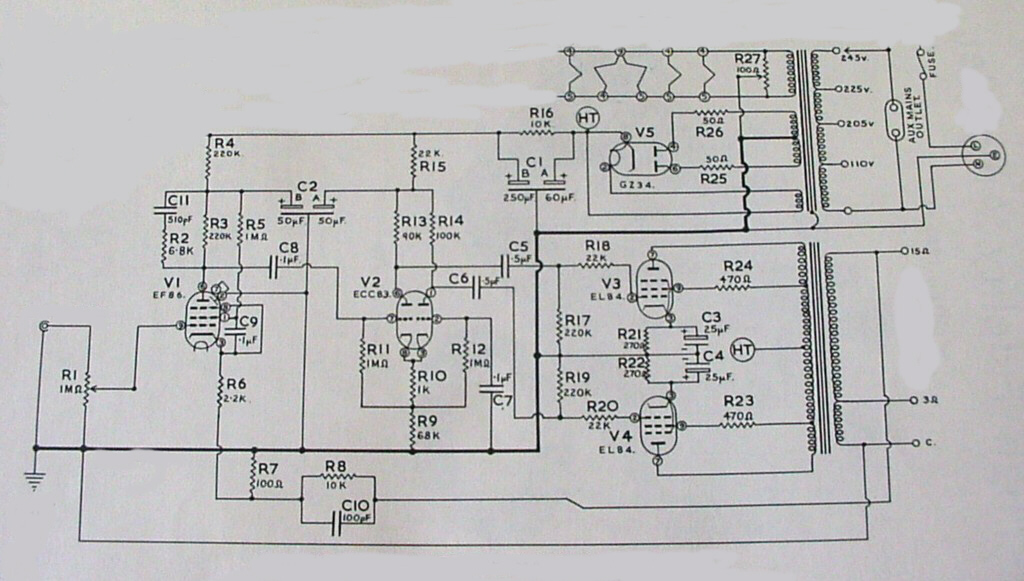

MA-12 Schematic...again...+ PICS !!!!
Hi Vacuum heads !
( there's no air, in there ! ) :eek:
Just thought I'd bung the schematic up again, as it was a few pages back.
4mm test-points near the valves...? :confused:
Mmmm...? :rolleyes:

Slightly concerned that if I add regulated heater supplies, the transformer might be a bit pushed.
When they were last 'fired-up' it did get rather warm.
Maybe a small extra transformer for the 'teeny-toob' driver heaters could be good ? :confused:
Mmmmmmmm..............? :rolleyes:

I have a full MA12 instruction manual (including a full sheet schematic I think)
I'll need to scan it - only if there is enough interest!
However, I'm looking for a replacement output transformers for my MA12 pair (and TBH the mains tx too) Any ideas if there is an "off the shelf" - the OP tx is marked as as a RADFORD and not a mullard.
