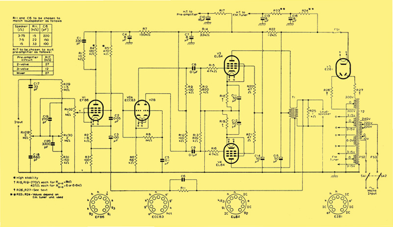

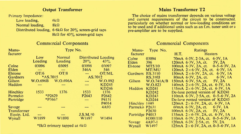

Simon, since the transformers are PP you need to stick with a PP design, or buy new iron.
You can measure the transformers to determine the turns ratio, and thus the impedance matching.
The Mullard 5-10 article calls out different Hinchley transformers (5133), but in all probablilty the 51/507 are similar. Easy enough to measure the UL tap ratio along with the rest of the characteristics. They could be 25% as that tap ratio is listedin the 5-10 article, but most likely will be around 40% (43%) as that gives lower distortion.
Too bad Tamura does not have any historical info on their web site (tamura bought out Hinchley and discontinued the audio output transformers from what I find on the web).
You have the resistor values from the Mullard schematic (exact copy right?). So why not just triode strap the EF86 to reduce the gain a little bit and rebuild the thing with the rest of the design intact? Seems like it would make a fine little amp. You could tweak the FB if you like as well. That is what I would do if they were mine.

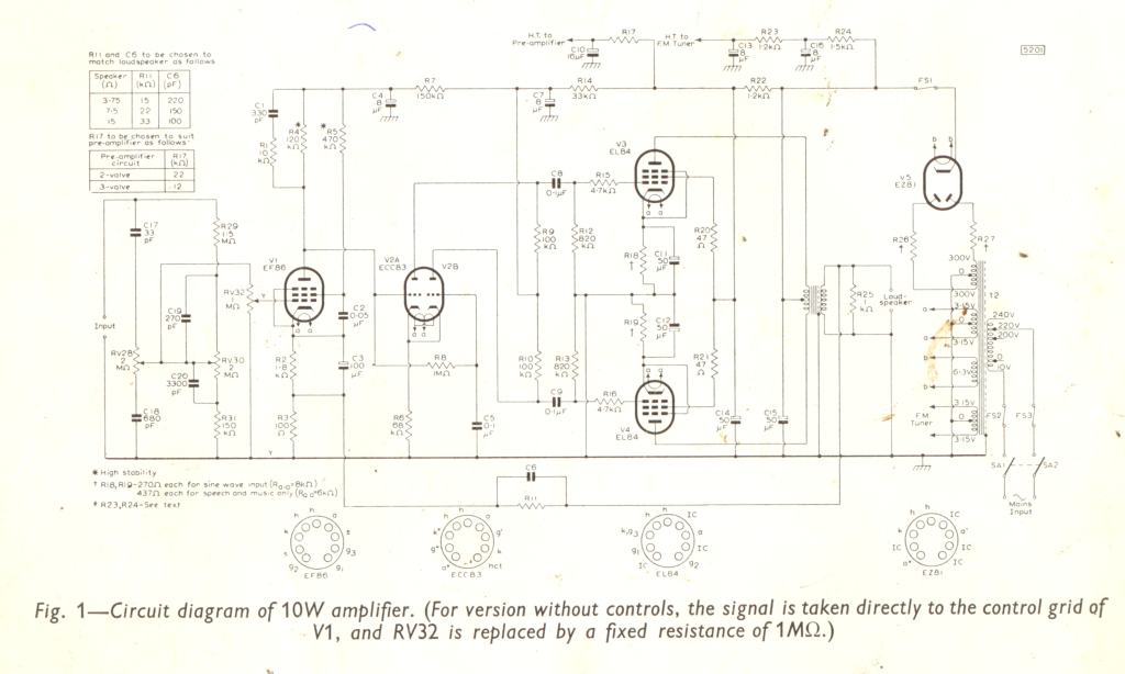

It's still being assumed that these MA-12's are Mullard 5-10's, although still don't have a 'Heathkit' schematic or constructors manual for them.
I do have two very poor copys of the Mullard 5-10 schematic however, and I guess even if there were tiny differences in the schematics, the iron and tubes are the same so this would not be a problem.
If I can find details of the triode strapping mod, I will redraw the poor quality schematics I have, with this mod, and what I can see in the schematics I have and from looking at the amps.

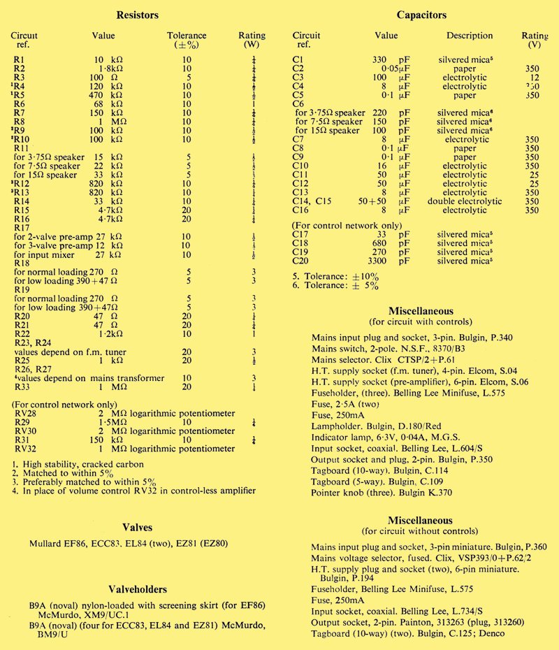

Resistor values are interesting, most (but not all) are readable from the schematics.

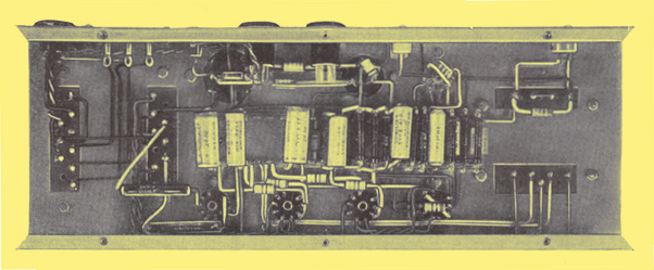

Inside the amps, stripe colours have faded a bit and paint flaked off.
I don't have a lot of experiance with older resistors and the value 'drifting' some report so I am unsure whether to replace these or not.

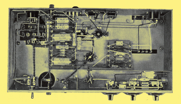

The diyer who made these obviously got them working just fine, but the construction inside is an absolute mess, and replacement parts have also been thrown in ad-hoc as well (would be nice if they weren't deathtraps !).
I am thinking a new chassis for the amps would mean I could get connector and capacitor mounting holes the right size easily, and space out the layout a bit more and improve the hum situation a bit.
This would obviously loose a bit of the 'look' of the amps, but since the Mullard 5-10 was a 'generic' design produced in a thousand different ways, I don't feel that sentimental or nostalgic about the chassis, if I could benefit the amps by making a new one, I think I probably should.
I almost feel like a keen diyer back in 1954 at the moment !!! a lot of whom would have made their own chassis.

Thanks for the tip on the replacement caps.
Hi The Gimp
Thanks for the tip on the caps.
I am making a parts list for the amps and I think your right, switching on with leaky lectro's and melted wax is not a great move.
I have probably got some of the small values in my parts box already, so I will have a sift through to check this out.
The big'uns I will have to order in.

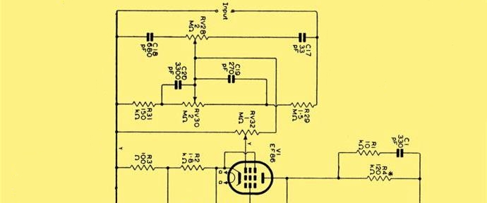

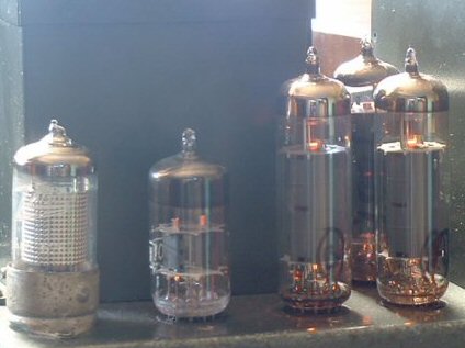

Reconfigure EF86 or new input tube ?
Hi Scott
It looks like stick with the original Mullard design, and reconfigure the EF86 or find a new input tube like the 12BH7 or similar you suggested is the way to go, keep the feedback, but reduce it.
Some of the Russian tubes like Salas used in his 'valve itch' look interesting, either B9's or Octal, he says they are very low microphonic, and good prices as well.
Could chuck in a 300b at the front just for laughs I suppose !!!
Cheers ...Simon...
Simon,
You could drop the ef86 from the amp and replace it with a 12bh7 or similar lower mu tube. With the lower mu tube, the GFNB can be minimized to a decent level. The input tube is nice to have as it provides a convient means to inject the GNFB.

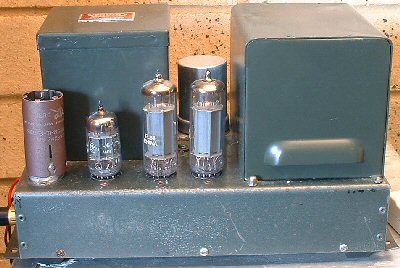

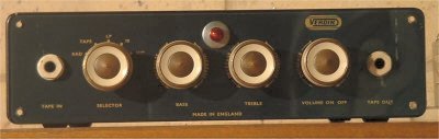

"What's 'The Verdik' on the Verdi ?" or "What's the Verdi on 'The Verdik ?"

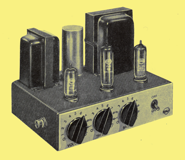

Hi teeny tube amp fans...
If the EL84 was good enough for The Beatles, then it's good enough for you !...
Just found another Mullard 5-10 clone for the collection...
So I thought I'd share a few pics & see what the verdict on 'The Verdik' is...
£52/10- was pretty big bucks back in the day...
So I'm guessing the venerable valved 'Verdik' was total 'high-end' kit.
It was NEW and Ultra-linear, with grain-orientated core transformers, 0.1% distortion -- & a wiz bang EF86 preamplifier as well (even had a analogue tape in/out, cool !).....
Nice pop-rivet work on the chassis, shame they didn't chrome it up a bit if you ask me.
Never mind, it's not for putting on a pedestal like a Faberge egg,. it's for listening to music with.
My verdict would have to be 5 ***** .Looks like a winner.
Anyone got one I can audition for a week ?.
Cheers...Simon...

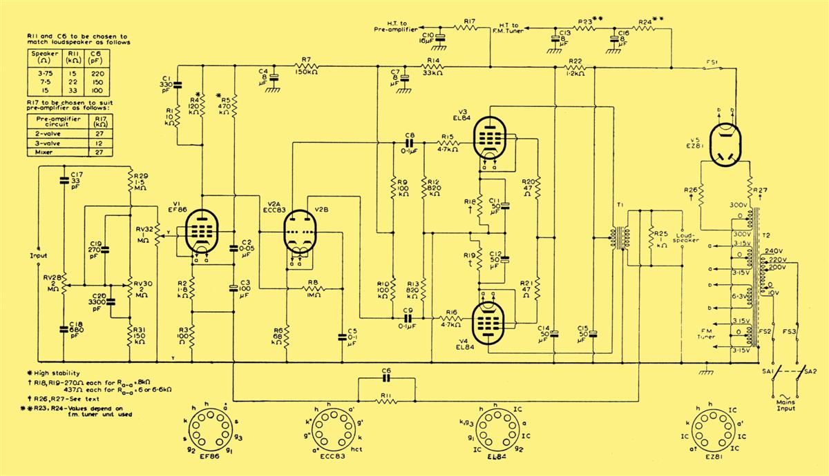

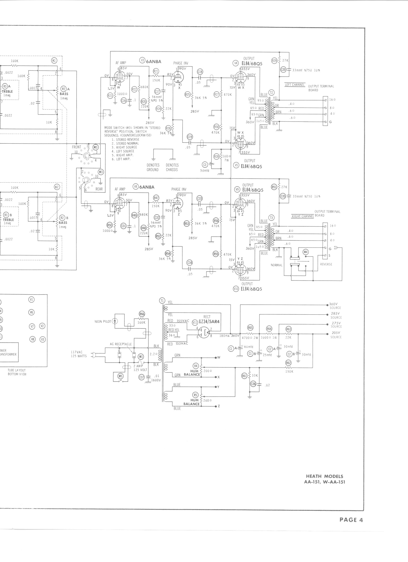

Bad resolution on the schematic in post #43, try this one.
This schematic is VERY clear and high res of the Mullard 5-10, sorry about the last one it looked like pea-soup fog !.
Simon...
Simon...

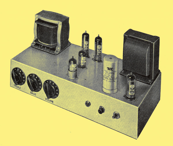

That's a cute little amp, just an unfortunate name. They really packed everything close together didn't they.
jeff
jeff
Linn would love the naming.
I'm surprised they haven't used it for something.
jeff
The world's teeniest, tiny tube amp !
Hi Jeff
They certainly did pack it in on that one.
You should see the inside of my MA-12's, deathtrap waiting to happen.
Heathkit certainly didn't want to waste any steel on that one either.
They should have made it out of the dreaded carbon-fibre, at least it wouldn't be 20% iron oxide by now !
The 'Verdik' looks pretty tough though, it looks like someones been giving it a bit of a bashing.
Have you busted a chain-stay for my tonearm yet ?
Simon...

Here's a close-up of the EQ & volume control.
RV 28 - Treble = +10dB to -10dB @ 10kHz
RV 30 - Bass = +11dB to -5dB @ 20Hz
The input sensitivity is 40mV without EQ section & 600mV with EQ section.
Feedback from the output transformer to the EF86 cathode is 26dB.
According to most data sheets I've seen the EL84/6BQ5 is only good for 300 V on the plates and screens. The schematic for the AA-151 here shows 355 V on the plates, and 360 V on the screens - Yikes! All I can figure is either the plate current is low, or those poor tubes are being beat to death!
Am I missing something here?
