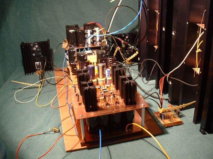

The front end circuit boards are double-sided, 1oz, 6" x 6" with top and bottom ground planes. I went optical for those. There's not enough money in the world to pay me to attempt that with that ridiculous toner transfer thing. Beneath that is another 6" x 6" board, again double-sided, 2 oz, that's populated with some of those caps you sent. (Whew! Good timing on that. Thanks.) That's the main cap bank for the output rails...160,000uF per channel.
Behind that is another pair of boards, both single-sided, 1oz, 5" x 6". The top one is the Tamura transformer, rectification, caps, and regulation for the front end with a take-off for the rail for the output regulator. The board underneath has the output regulator and after-regulation capacitance for the front end rail.
Finally, there's the Plitron. Straddling it on standoffs is a double-sided, 2 oz, 5" x 5" board with the main rectification and first bank of caps (more of the ones you sent).
For prototyping purposes I've got the output devices, Gate stoppers, and Source resistors on individual small boards. This allows me flexibility in placing the devices on whatever heatsinks I can get my hands on and also allows me to add more devices if I feel the need. As the schematic shows, I'm using two pairs of outputs at the moment. For a while I was debating going to three pairs and lowering the bias. The tradeoff between Gate capacitance and heat dissipation eventually tipped towards two pairs of outputs. Once I get straightened out, I'll make another run at having someone build me proper chassis. Once I have that in hand, I'll make final boards for the bias and outputs. Probably double-sided 2 oz.
The bias board is separate because I wanted to be able to swap bias circuits in and out. I've still got the original bias boards, which used IRFD110/IRFD9110s, but they're non-starters. As I began pushing the second stage harder, I went to IRF610/IRF9610s so as to have the TO-220 case. The Vgs thing bothered me, so I made another bias board with MJE15030/15031s to get Vbe instead of Vgs. That's the one that's on the schematic--a straight adaptation of John's bias circuit. I also did an auto-bias variation of John's that uses the value of the Source resistors to set the bias. The "normal" John one and the auto-bias are the main contenders. I have not listened to the auto-bias circuit; it's only been bench tested.

Hi Grey, interesting circuit!
I`m curious about something:
1. What`s the iddle current of jfets and "second" stage folded cascode mosfets?
2. Have you tried to make a plain second stage folded cascode without cascode (without Q15 and Q16) and is there any diference in bandwidth and sound?
3. Have you tried a low feedback mod (6dB at least)?

1) The front end JFETs, the 2SK246/2SJ103s, are all BL grade. The Idss of the parts I put into the circuit was on the lower end of the grade. With the front end bias resistor (R19) at 47.5 Ohms, they run at something like 5.5mA each. It would be nice to have higher Idss parts, but I ordered 100 each of the N-ch and P-ch and all of them were clustered at the lower end of the BL range. Bummer.
The thing you've got to keep in mind is that, lacking feedback resistors, everything you do changes the gain. If I lower R19, not only does it increase the gain, but it also means I have to rebias the folded cascode...and so on. You can't just change things at random; you have to consider the ramifications on down the line.
2) In the beginning I was using parallel J310/J271s in the folded cascode position. Even in parallel, the Gate capacitance wasn't a problem with the JFETs, but I couldn't run them without cascodes over them to take the voltage swing. At that point I was using IRF610/IRF9610s for Q1, Q2, Q15, and Q16. When I went to the Toshiba MOSFETs for the folded cascode the voltage problem went away instantly. So did current limitations due to the JFETs. The cost being increased Gate capacitance. I kept the cascode in place to manage that capacitance.
You can do without Q1, Q2, Q15, and Q16 if you want, as long as you use parts that can stand the voltage swing and current in the folded cascode position. Bandwidth will decrease and distortion will increase. If you intend to use feedback you can deal with that. Since I had decided to go for a non-feedback circuit by that time, I kept the cascodes.
Candidates for MOSFET substitution would include Hitachi/Renesas, Fairchild, and IRF/Vishay. Smaller current parts will tend to have lower Gate capacitance (Ciss), which is all to the good. This is not a good place to start throwing in TO-247 100A MOSFETs. The Toshiba parts I used are 1A devices. Power dissipation is a little over 2.5W and is the parameter to keep an eye on. I've got the driver devices heavily heatsinked.
3) No, I haven't tried feedback on this particular circuit because by the time you've changed all the things I listed above to prepare for feedback, you've got a different amplifier.
For example, removing the 500 Ohm load resistors at the takeoff points for the drive doesn't just increase the open loop gain, it raises the output impedance of the front end dramatically. This will interact with the output devices' Gate capacitance. A typical global feedback loop will not solve the problem because it will go from the output to the input. The node between the drivers and the output devices is internal and won't be affected. To lower the Zout of the front end, you'd need local feedback. It's not that it can't be done, it's that you no longer have an apples to apples comparison. Playing with variable levels of feedback is easier to do in a tube circuit.
John is welcome to comment if he chooses. As I've made clear, this circuit is directly derived from his work and he's had a lot longer to think about the sundry options available at any given point. I'm sure the circuit differs substantially from what he might do, even given the same active devices.

The way I described it to my wife was that I wanted to take these pictures in the same way that you would a pig in a bikini. So we used a green backdrop and tried to light things nicely, etc.
Okay, so it's still a pig in a bikini. As I detailed elsewhere, my plans to get myself a nice chassis made ran afoul of reality.
I've never tried to post a picture here, so this may or may not work. There should be two pictures--one of the whole amp and one of the front end.
Grey
Grey
