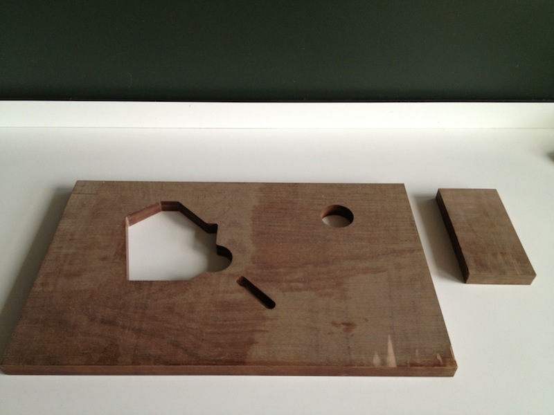

Suggestions for Plinth/TT design
Hi all,
I have just gotten some materials, i.e. some Acrylic 600 x 70 x 25 mm
some plywood various sizes 15 mm thick.
I want to use a couple of 300 mm + 9" arms.
I quite like the idea of making pods but finding suitable outer pod vessels is proving difficult.
Any suggestions please

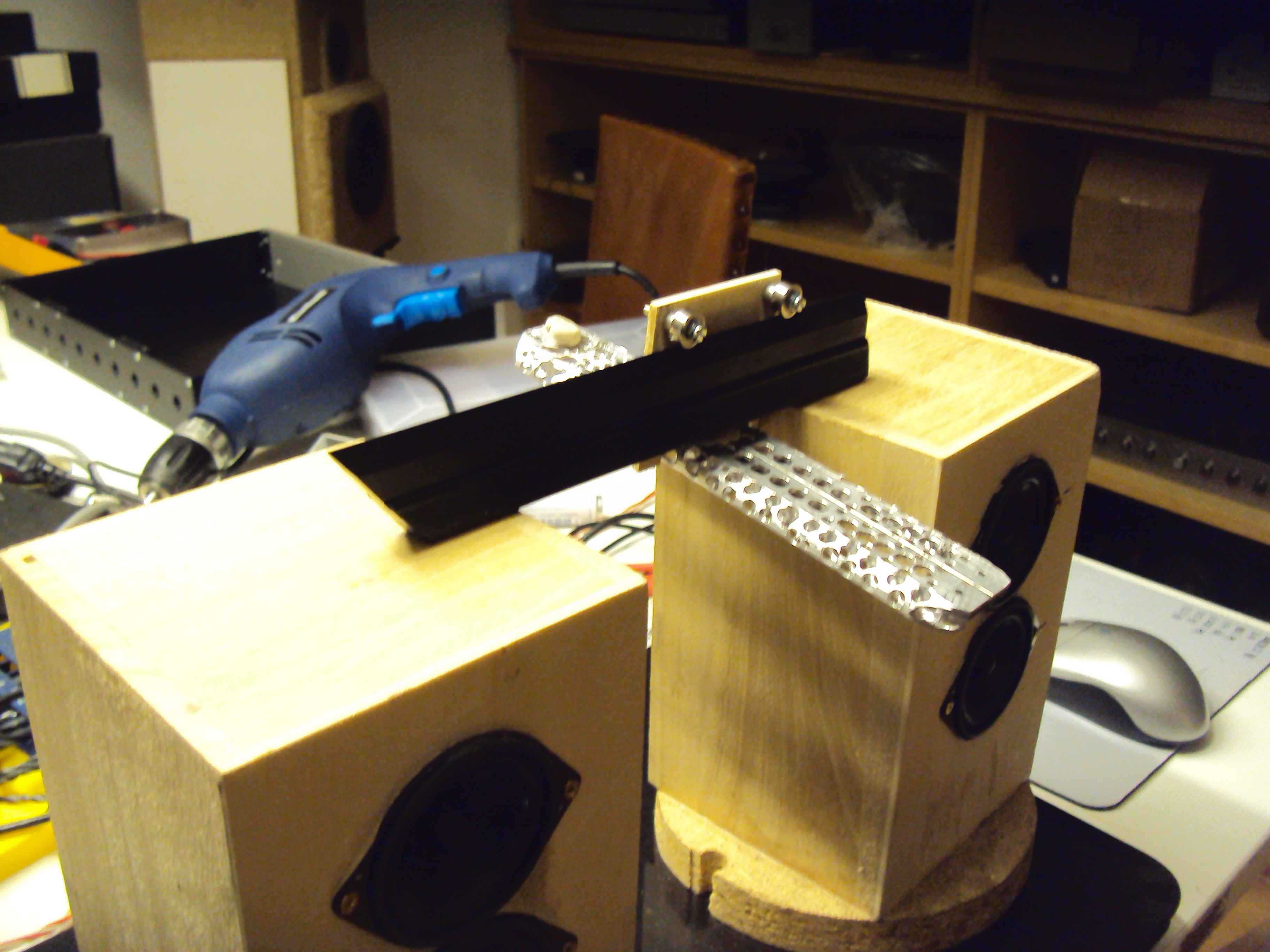

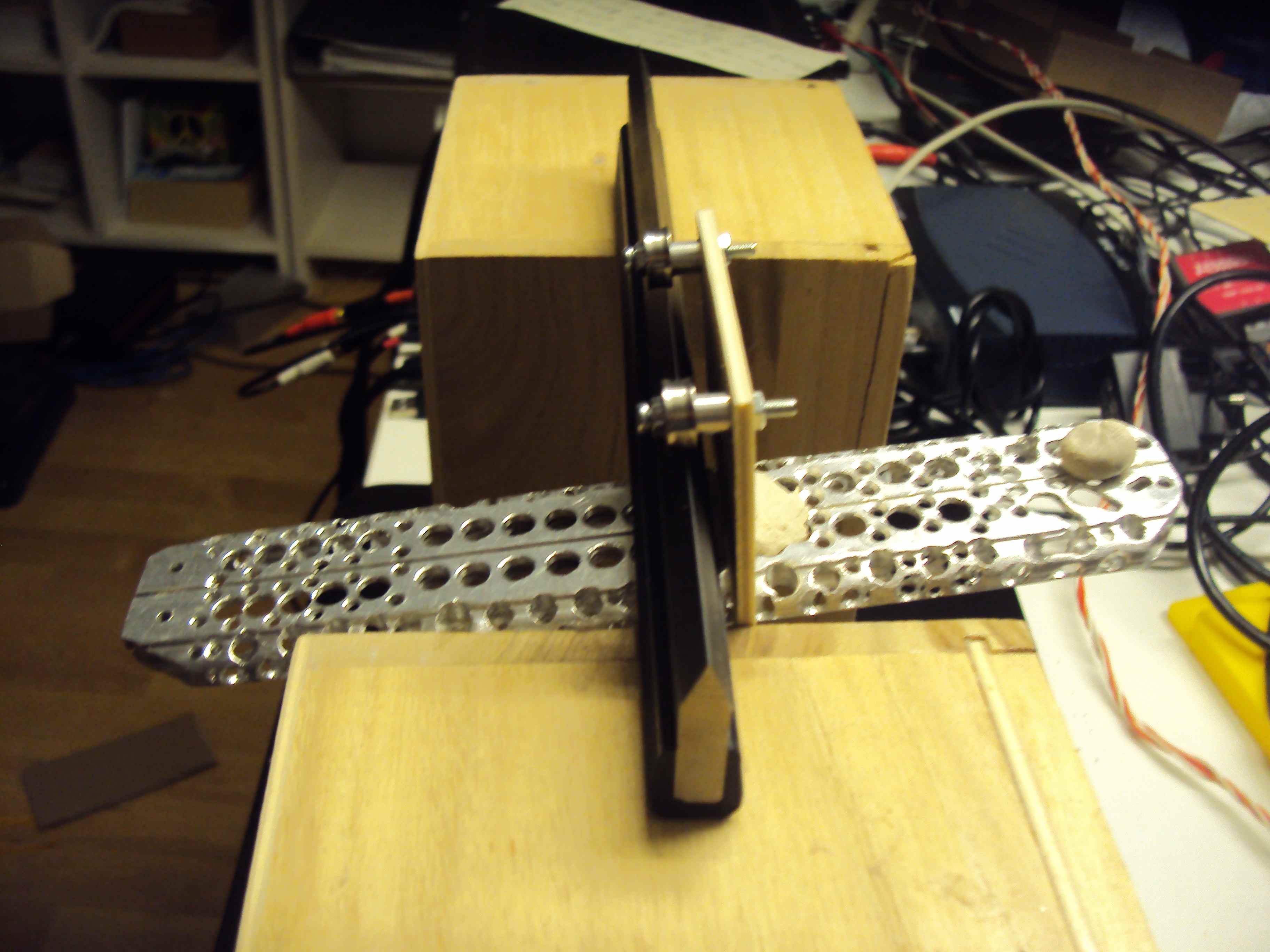

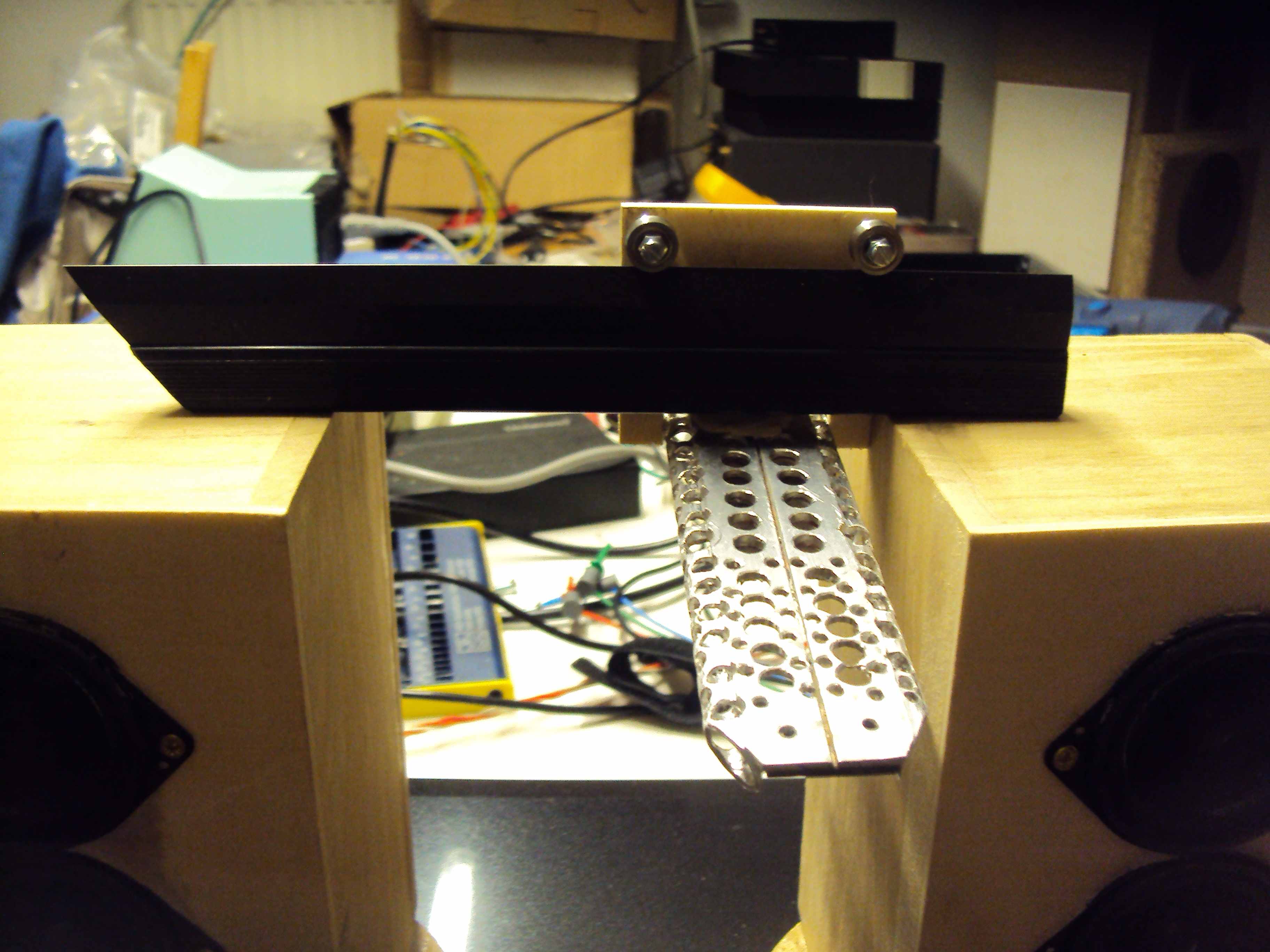

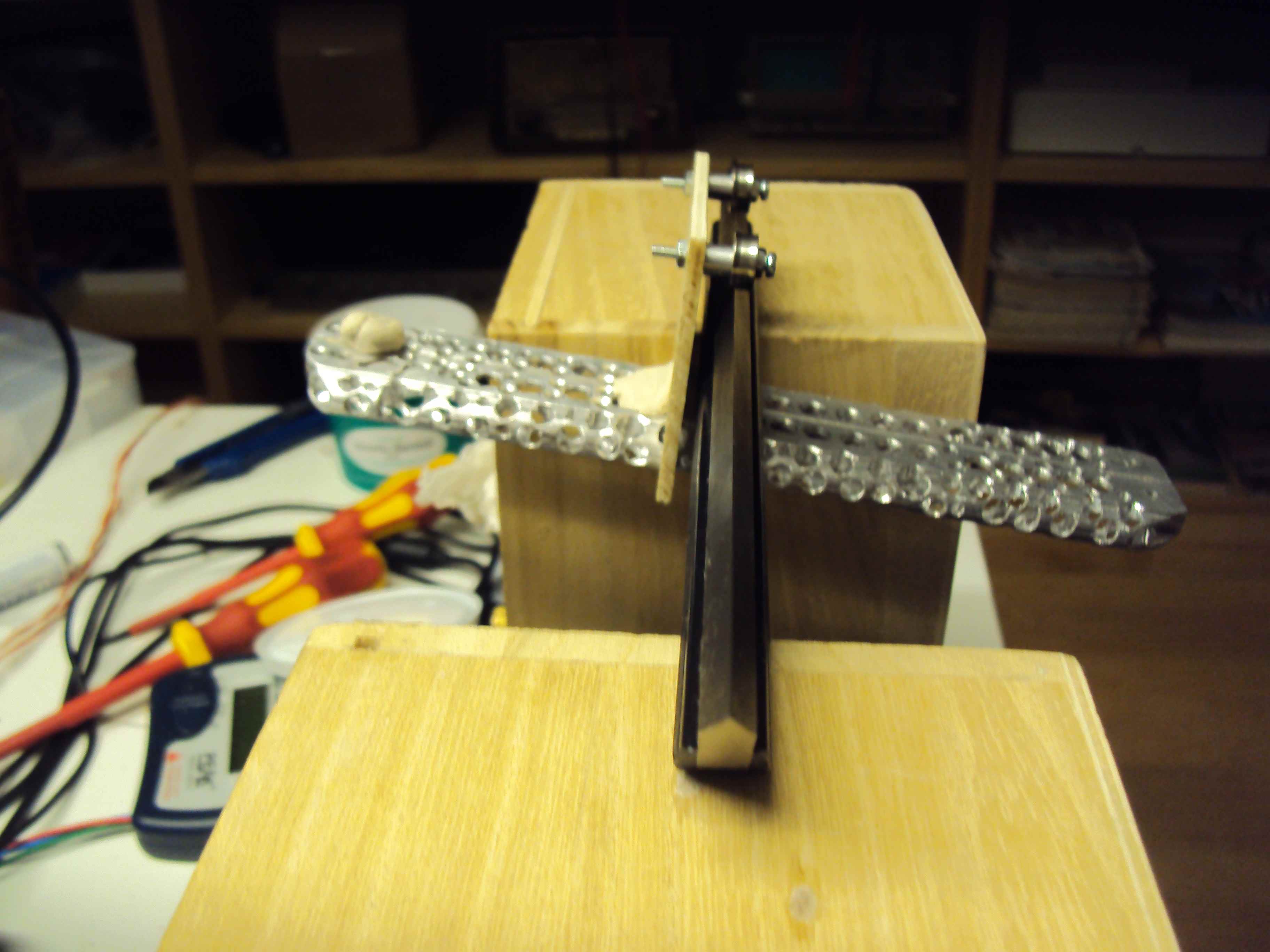

Today i came a big step closer to a functioning DIY tangential arm.
For the moment i gave up on the magnetic floating idea. It is just too difficult and maybe even impossible.
I discussed several possibilities that use ferro fluid with Michael Boresen and Frank Schröder and a captured bearing is an option. The problem is to find materials where the ferro fluid does not stick to or it ends with a dirty mess.
So back to the rollers. On another thread there are some successful builds that use tubes,
mostly from glass. There 4 rollers are needed. The Opus 3 Cantus is an exception. It uses only two rollers but needs a tube that is cut open in the back so the rollers run INSIDE the tube. I like the simplification of using only 2 rollers but i wanted to avoid the tube. Then the idea hit me to use a knife edge instead. First i wanted to use the blade of a cutter knife but Frank Schröder had a better idea. There is a measuring device to check for surface straightness and blemishes that is called " Haarlineal" in German. It is an extremely straight hard metal rod. With this rod and two rollers it can be done easy. I build a fast prototype that is already moving smooth. Dimensions and materials will change and there is more to say about the rollers but i hope that you already get the idea.
