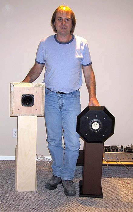

A level 0 with a proto sB... it has no official standing because you wouldn't put an sB on a Level 0, you'd make a Level 1 1st.
attached is a pic of the 1st session, DavCan -- note that he is taller then most people -- embracing A126 and FH-proto
(BTW those protos, sans sB and nicely finished in walnut veneer are available really cheap)
dave
I'm 5' 11'' and now the hair is gone (should have shaved the head long ago lol)...
