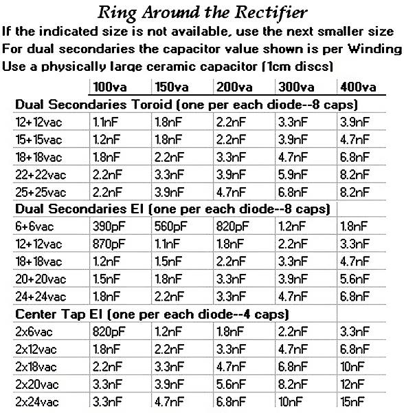

You can probably drop another volt or two by snubbing that bridge rectifier. Chart is attached. In my own use, this has reduced heatsink expense disproportionate to voltage drop. Doing this can let you use LM3886 (solo) / TDA7294 if you wish.

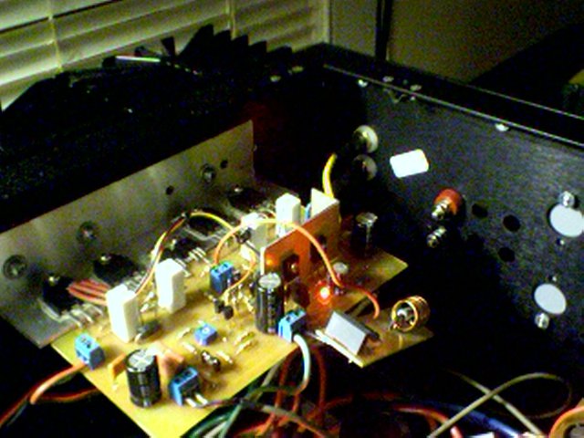

It lives !!!
The suspence , will it work or will I have a pile of burnt sand ? Almost did that , soldered the EMF output diodes backwards :hot: ,
luckily I powered up with 2 47R resistors (white and green wires).
Right off the bat , with the Vbias and offset trimmers centered,
I got 1.15V between driver emitters (+ - .57v) and 2mv at the
output (wow). BTW , the drivers are acting as the outputs (2 -33R
2w resistors under board).
I was worried about the driver temperatures , but they run rather
cool , even when I crank the bias. The VAS is a reclaimed piece
of roadsign :devilr: to cool the KSA/C's (perfect warm class A).
I must decide whether to ground the driver heatsinks , I don't
appear to be oscillating , but I want perfection with this one.
Tommorrow I will be able to audition this big symasym after
mounting my 16 OP devices. IT is hard work to build these larger amps.. :eek:

Today I got all 16 OP devices in and all works well. This is my first 4 pair BJT amp and it brings up a few questions :confused: .
On my 2 OP pair amps I biased by device (12-13mv/.22R - 60ma per device) giving a amplifier total of 250ma. My dilemma is with 4 pair
can I halve the bias per device giving me the same 250ma or is the individual device bias what matters? Simulation says my THD does not change much between 30 and 60+ ma but being in a
hot environment I like cooool.
Also , with the huge heatsinks and 4 pair ,the bias starts out real low (20-25 ma) then slowly increases to 65ma - 18/19mv /.27R ,but this takes a half hour. After this it stays at this level and even backs off a little (1mv) , is this normal and is it caused by the oversized heatsink?
The new amp has .27R emitter resistors (got a deal on 50 of them) and estimated .02C/w heatsinks (stealth class a).

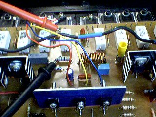

Question: If the sum total of the resistors in parallel on the larger scale amp results in a smaller total figure than the smaller scale amp, then doesn't that act like you'd used half value resistors (more heat) on the smaller scale amp?
EDIT: I'm trying to say, maybe since the 2x parallel amp uses 0.22R then the 4x parallel amp needs 0.44R? That and match the output transistors too?
by andrew T. -you're amp is telling you it is in trouble.
It could be that the heatsink is too small, not too large.
Trouble is what I don't want. The heatsinks are 2 of the stealth 7" X 5" thermally coupled together. When I increase to crazy bias (50+ Mv per device) the heatsink still barely gets warm. Originally 2 of these HS's were used for 4 IRF V mosfets biased between 1 and 2A apiece (they got hot then :hot: ).
What is different on this amp is the fact that I now have the drivers on separate heatsinks. I have seen this on the leach and many other BJT EF amps but again I am on new ground here. When I first turn the amp on The MV's go from 5-6 to 15-16 rather quickly (2 minutes). After that it will slowly rise to 18+mv and stay there overnight(that is where I have it now).
A strange thing I notice is that if I blow on the driver heatsinks the bias will drop for a few seconds and then recover to it's
original levels. Andrew, I did take your advice and I am now shooting for 18-20MV Re.
After looking at the leach for reference , I do have much larger heatsinking by far :eek: for both the drivers and the OP's, how
does the leach do it and is there a reason (drawback or difference) to using separate driver heatsinks? !!

Andrew , you got me worried. :bawling: So I took a hair dryer and heated the main heatsink to 135 dg. F (with big hairdryer -heatgun, tested w/ new T probe on multimeter) .
The per device voltage dropped to 16mV within 30 seconds, after I removed the heat source, it rose to 18mv after 2 more minutes.
So you know what I am working with , here are the HS's..
And here is where I'm taking my T-comp . from the top of one of the NJW's.
(to-126/2sc2690 - below red probe)
I did a second test and heated :hot: the drivers to a similar temperature and kept it there (left heatgun on low).
The mV's went up to 20+ quickly , but did not begin to decrease back to 18+ till after 3-4 minutes. At this time the main heatsinks began to feel warmer. This sort of makes sense as the 2 parts of the EF (driver and OP) have different heatsinking. this is the variable that confuses me with the leach and sloan amps (separate driver HS) does it matter if the Vbe of the drivers is independant of the main OPS/Vbias ?

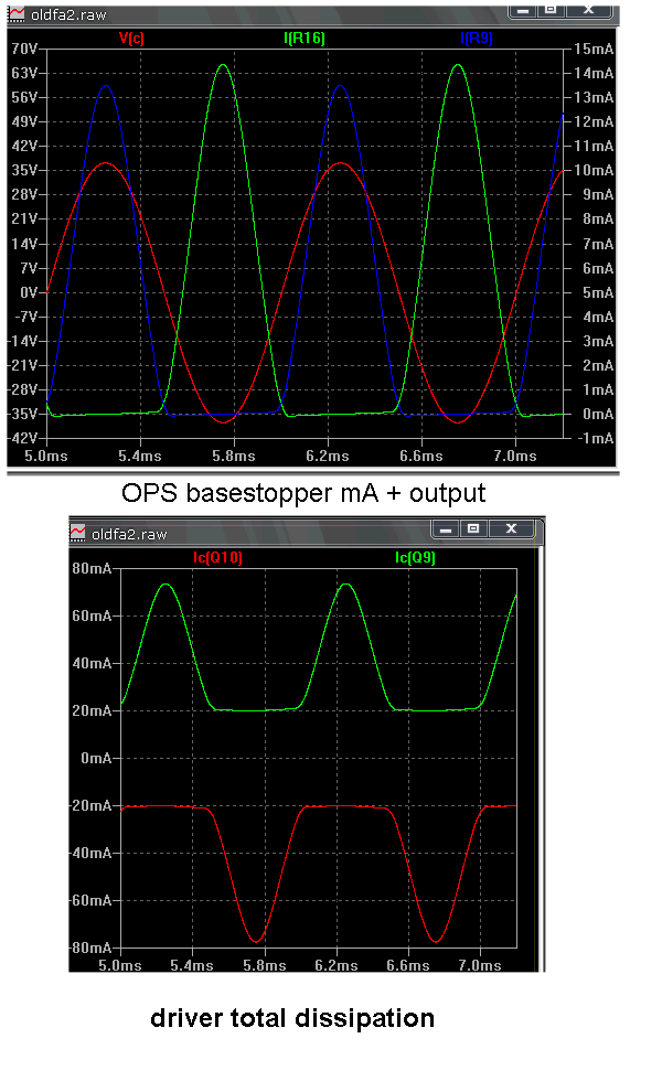

Am I right in calculating that each driver is dissipating 2W?

By andrew - Am I right in calculating that each driver is dissipating 2W?
(attached) is the total estimated driver dissipation in mA and the amount of current going to each basestopper. These were simulated whith a worst case 2R load ( beyond the expected SOA of this OPS) In text , the drivers are biased at 24ma idle with a 68R type 2 EF emitter resistor.
I wonder if the drivers are rising in temp as the amplifier warms up.
After the first minute they reach 39C (104 ? F) on my Tcouple , after that ,they stay there. All my tests so far have just been at idle, cooling and heating the drivers and main heatsink as much as I could , the biggest bias variation I could produce was between 15.5 mV and 21 mV and that was done mostly by heating the drivers. the variation was less when heating/cooling the main heatsink.

By rafael luc - I'm trying to design an amp with this topology, I tried such compensation Miller, 2 cap base/collector in Q2 and Q3. But noticed that in 20Khz, IC-Q2 and IC-Q3 are in same phase.
I haven't seen that , {attached} is my Q2/3 current phase. It seems to be fully out of phase at 20Khz. if it was not, the CM at
the bottom would not be able to run the vas (would not work). As you can see Q2 is perfectly in phase with the CM. This also seems to hold true at LF , too.
I listened to this one for a while in prototype form , and it really is impressive with cymbals , brushes , especially vocals (abba, WOW) , while it also is very stiff and solid in the bass department as well. Can't wait to hear this one , more refined compensation, matched pairs , more outputs...:devilr: , but I must test,monitor,
burn in these 2 well before ever hooking a speaker up to it.
