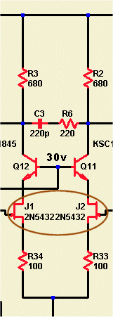

By roender -Now, try RMI-FC100 ... it was designed as a direct competitor to Symasym, which was my reference in development. Or try abomination but if you have jfets, replace the BJT LTP transistors
Those are killer designs ..the RMI /abomination. I did try MJL's
new iteration of the RMI and it sounds SO close to this one
with BJT's. Not better or worse but nearly identical. All this
with double the components. I did try the fet differential (attached) and got "silkier" vocals. Used a pair of dual fet's
scavanged from a old pioneer.
With this amp I had to change my method operandi (MO) , no
more relying on simulations and scopes for the final say on the
project. LT shows a small increase in THD20 with both the 10pf
VAS FB and the addition of the cascoded Jfet's.
, but the soundstage/sound is improved. LT is good for avoiding
a catastrophe or seeing what will not work outright , but the
real devices seem to have thier own ideas.
(I initially designed this amp WRONG with the help of LT )
OS

ostripper said:I did try the fet differential (attached) and got "silkier" vocals. Used a pair of dual fet's scavanged from a old pioneer.
OS
Specifically which FETs and did you have to make other changes? Iq for BJT vs FET OPS?
By samuel - Specifically which FETs and did you have to make other changes? Iq for BJT vs FET OPS?
Dual Jfet 2sk129 , possibly obsolete now, in simulation most Jfets
AND mosfet duals or singles work good with proper degeneration.
The rest of the circuit stays exactly the same (the 2 680r's)
just add the 30v cascode , add fet's , "tweak" the degeneration
resistors.

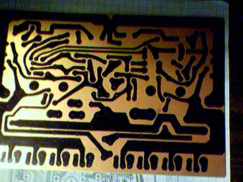

As far as MOSFET outputs , I am serious about making the next board universal ,
accepting both BJT's or vertical MOSFETS (SK-XXX or IRF - XX).
Just add the pads for gate protection ,use 300r-470r gatestoppers.

Re: All done for now , best sound I have heard yet.
The design looks fantastic!!
An additional test is to compare its perceived clarity with a an "ordinary" amplifier (especially compare with one that doesn't have paralleled output transistors). Either outside or on the opposite end of the house will do fine for the test. Clarity at close range is one thing, but clarity at a longer-than-normal range is a different thing. I think its good to check this on powerful amplifiers.
ostripper said:. . .
I let it play day after day and want to try out oldies to hear
"new sounds" that they contain (hidden finger sounds +
other environmental sounds ..)
Full power , endlessly , no heat (those heatsinks don't even get warm at 200W ALL DAY)
I am finally so happy..
OS
"SUPERSYM"
Just could not think of a better name...
The 8 device PCB design attached will make it even better with 6800uf rail caps and a better CCS (VERY fat current traces).
This amp is the "bomb". I juryrigged 2 more pairs to one of the prototypes and bottomed out my peerless sub.
that happens at 400 watts. With 4 pairs of NJW 0281/0302,I did 50V RMS for extended periods into a 8R load. For 4 ohms,
I did not have any problem pushing the peerless all day , but for straight sine wave testing I would be concerned with SOA.

All hand done again , my brother laser printer sucks at making boards but I will make the hand made ones match
the best around here. (attached)
It is similar to Mike B's "symasym" or ampslab Bi240 , just ported out to fit the genesis Stealth PS / case.By DWB - The design looks fantastic!!
Even at this power rating , the amp is still cheap (12$ for OPS ,5$ for all the small signal devices , 10$ for all the caps + 20$
for the rest). 50$ X 2 isn't bad for this much power.
