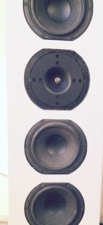

Looks great! I really like how the waveguide you are using matches the shape of the other drivers. Did you flush mount the drivers? It is hard to tell in the picture.
Thanks!
Yes they are all flush mounted. As the tweeter is about the diameter as the rubber ring on the others it was rather easy to get it look "right". There is a thin small black coloured washer/ring between the tweeter and the outside shape. Works pretty well.
Plays really really well!! (Although I am in silence looking forward to the MKVII maybe with an enhanced tweeter with som more crispiness, as I am in some way spoiled with magneto/electro-stats and Thiel tweeters) :)
Interesting look. Noticed it straight away.
Well, here is a close-up that show a little bit more. Sorry to say, the light and the Iphone5S together doesn´t make a good picture. With less glitter and even from any distance it actually look pretty good. The "white" and grey dots/lines etc in the picture does not exist IRL.

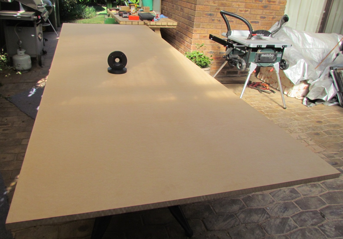

The attached photo is Day 1 of my Elsinore project.
