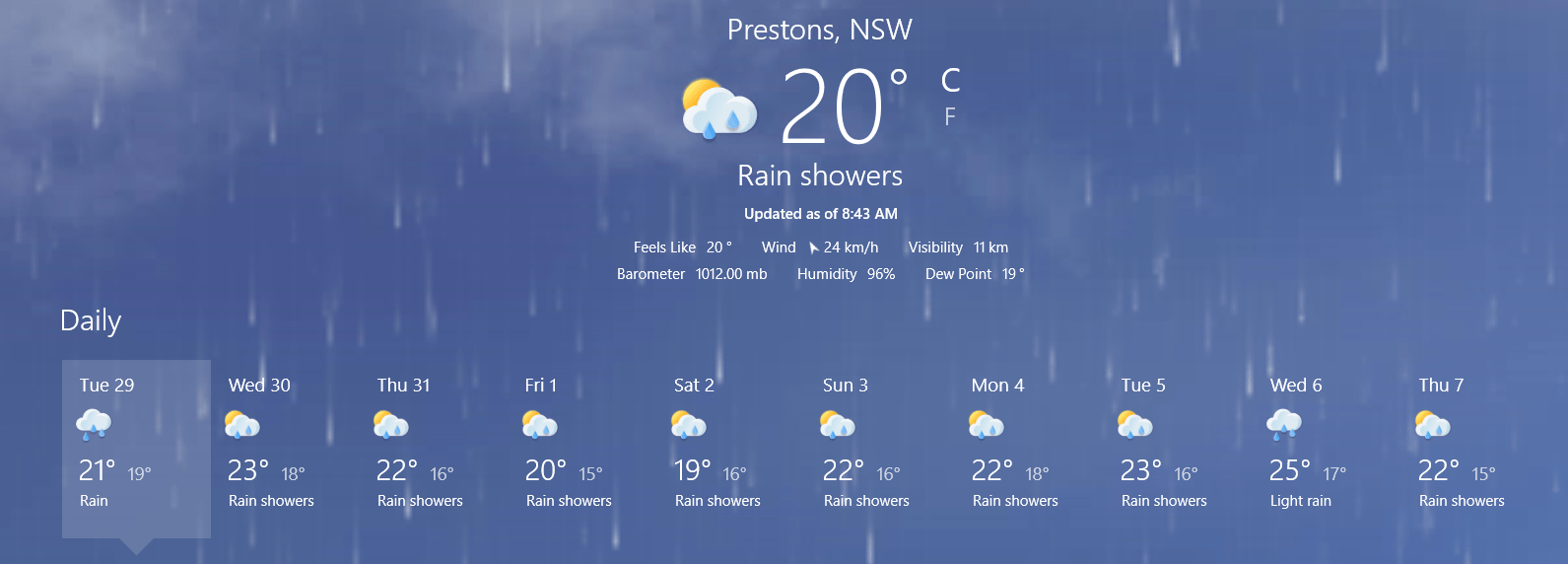

You guys may have heard about our weather down here. It's been rain, rain, and more rain. This is our forecast eahead:
Ten days of rain ahead.
This time of the year we are mostly sunny and not much rain.
Thankfully, the worst of it is up north of here. The neverending rain is like nothing I can remember. We are seeing the damage caused, it is all over the place and we have been fortunate. It has made a mess of our roads, hard rain makes the surfaces crumble and you have to look out for holes.
By the time the rains are gone and we get the usual sunny skies, I will be ready. Will be able to set up the equipment outside and start doing the acoustic measurements that will alow me to model the crossover. I may at that point need to buy parts for the crossover if I don't have what I need here. We shall see.

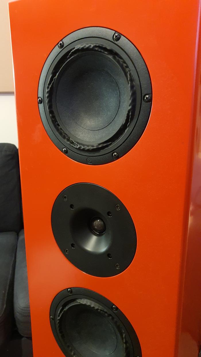

The "ULD" speaker boxes have been assembled. The "ULD" moniker is what I have settled on and that is how Purifi describes the drivers, as "Ultra-Low Distortion" and below shows where we are up to.
Elsinore Mk6 "ULD"
Not bad for a quick picture using my Note 10 phone. It looks even better in real life.
Yes, the boxes are done, the internal damping all fitted, part filled and part lined. The instructions for that are not likely to change. The port is 150mm deep and it will now be interesting to see where the box tuning will end up. The aim is a bit under 30 Hertz and maybe as low as 28 Hertz. The port length may yet be tweaked.
To short-circuit any recurring topic, will the tweeter be good enough to match the quality of the Purifi drivers, keeping in mind the utmost importance is very low distortion. The resounding answer is yes.
Even stock it is a top-class soft dome tweeter, it has design features that were influenced by Russell Storey of Stones Sound Studios, right down here in Australia. But an additional level of performance is derived by using a waveguide and good crossover design. Besides, I know this tweeter like the back of my hand!.
The waveguide is not used to increase the bandwidth (this entices using very low crossover frequencies), but here it is done for the most basic reason of all, to reduce distortion. Yes, the waveguide has other advantages and thank you very much we will take them too, but the rationale here is distortion reduction. The crossover additionally reduces distortion by using a carefully tuned "Q" LC null at Fs that minimises and virtually eliminates excursions of the tweeter. It goes from 1st order into 5-6th order in two octaves.
Brian Gurr in Auckland rebuilds electrostatic speakers and is ultra-sensitive to HF distortion and his pair of "NRXC" Elsinores, he says the top end is right up there with his custom-built electrostatics. Yes, it is that good. It will be right home in this design.
There are six Teflon/Silver/Copper wires coming out of the back. The crossover will be developed externally first and then later into the base of the box.

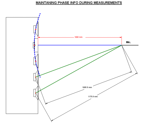

The farfield acoustic measurements have to be done outdoors. When that is finished, then all the data will be edited in Clio, merging and summing nearfield and farfield measurements. These and the electrical measurements (impedances) will be imported into SoundEasy and here the very strictly (and calibrated) collected data will be put to good use and we can construct the crossover and model/observe the behaviour of the crossover. BTW, the acoustic response will be referenced to 90dB-SPL @ 1 Metre. But the actual acoustic farfield measurement will be made at 2 Metres. This is because I want to capture the driver integration and the relative phase differences at a distance where beyond I am confident that it will be similar to most people's listening distance. So if the stimulus is 1 Watt @ 1M, I use 4 Watt @ 2 Metres or +6dB. But the main drivers will not see the full 4 Watt but 2 Watt, but the tweeter will, so some care is needed when doing that measurement. Very low frequencies need to be kept out or damage may happen.
(Above: These were also checked and modelled at 2 Metres)
On Axis Versus Off Axis:
The acoustic measurements will be taken (1) on axis, (2) 15 degrees off axis and (3) 30 degrees off axis. So when we model the crossover in SoundEasy, we are actually doing it three times side-by-side. Yes, I am running the programs at the same time on a wide-screen computer monitor. This way we can monitor what the crossover is doing across a sixty-degree arc in front of the loudspeaker. The 15 degrees off axis response will have primary importance over the other two.
