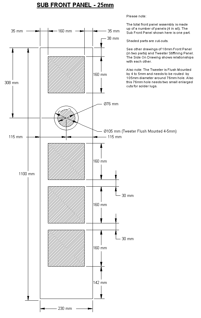

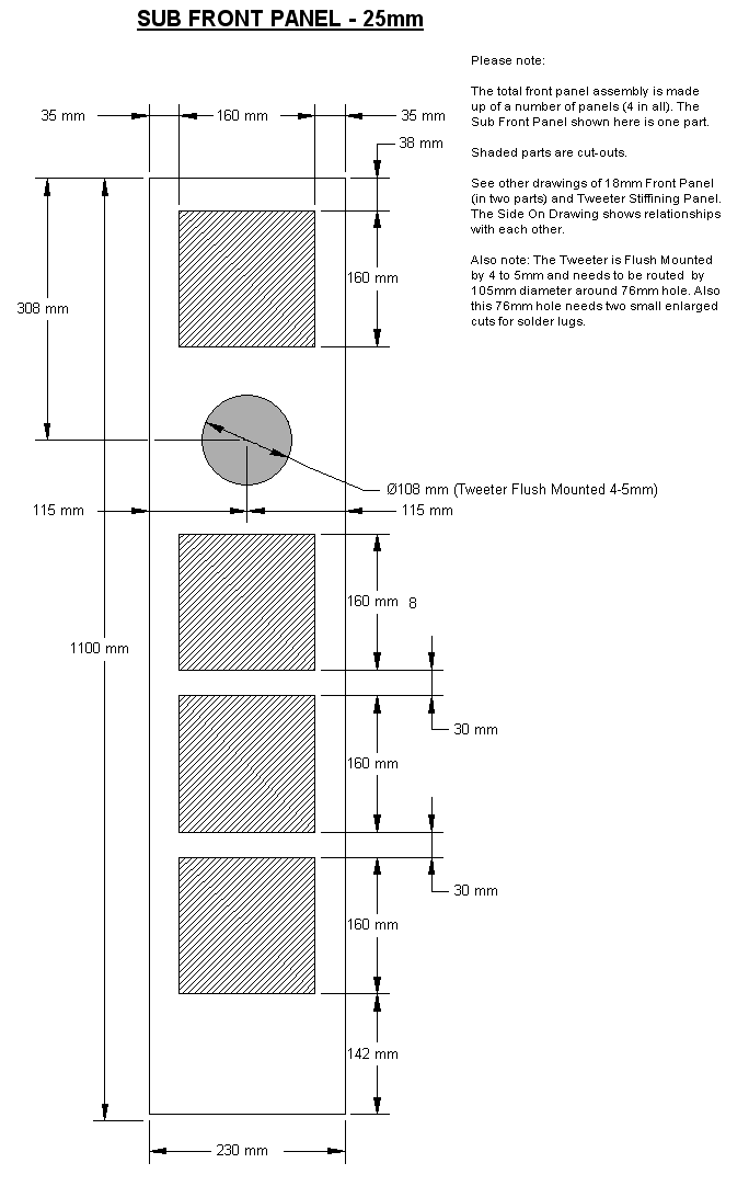

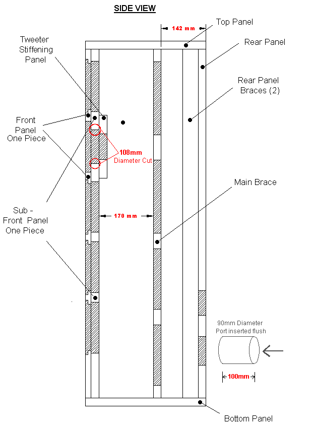

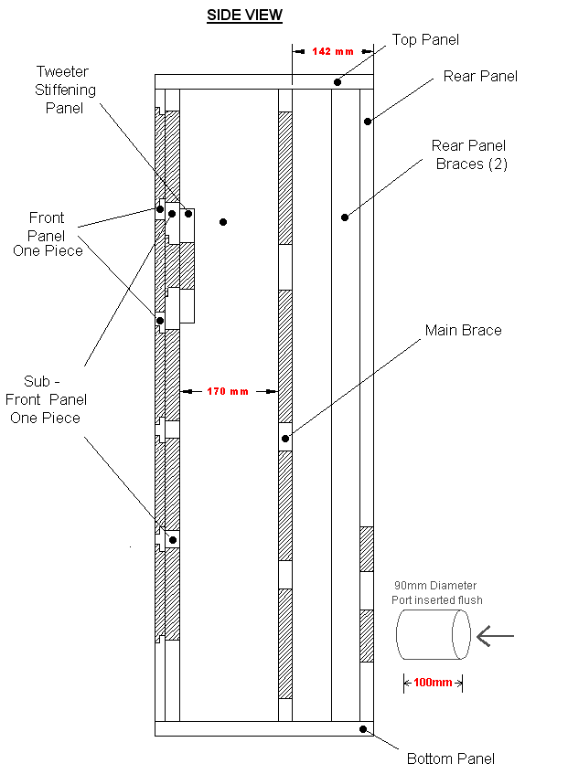

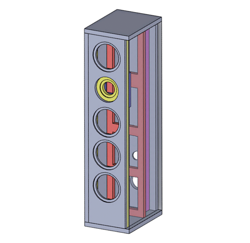

The drawings for Elsinores and Hamlets are being revised and will let you know here when they have been posted. It is about simplifying the mounting of the Waveguide/Tweeter assembly.
Take a look at the below attachments, you can see that the hole is being enlarged to 108mm and that leaves 2mm around the 104mm mounting flange of the Tweeter.
They are before and after, three sets. Not the middle 3D, the simplified hole is not to scale.

confusion over port size for Elsinore MFC Mk 6
Joe,
I'm a bit confused -- on the Elsinore Mk 6 parts list under post 4060, the port is listed as 100mm x 100mm and approx 96mm inner diameter.
On the new drawings in post 4150 shows the port as 90mm diameter and 100mm length. Which is the one I should be trying to source?

Alternate Elsinre Enclosure
A little bit of tricky editing and below the hole is a bit closer to scale.

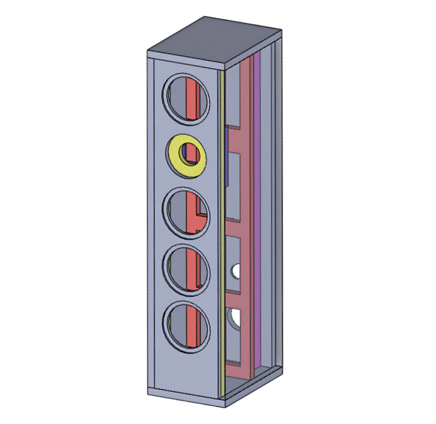

I have been following your Elsinore project for some time and have been an enthusiastic admirer of this DIY project. However, I have been concerned with the original choice of enclosure material, even though it is the most economical choice by a factor of 4, with weight and availability of 25mm MDF to be an issue for some.
So I have looked around for alternative solutions and it looks as though other DIYers have also expressed using 18mm or ¾ inch ply, but I note that no one has offered concrete plans utilizing the 18mm ply construction that adheres to Joe’s ever evolving plans.
For those interested, I have taken the liberty with an updated 18mm ply design that conforms to Joe’s original design, having an internal volume of 74,86L that is inclusive of internal braces and panels and a front baffle that meets all of Joe’s requirements. The enclosure sits on a stand, fixed or removable, with the following overall dimensions, 280 x 350 x 1250mm. The stand can accommodate Joe’s new crossover PCBs and can be finished to one’s choice.
Please note that 2 sheets of 2440 x 1200 x 18mm ply will be required for this design. I'm sure that Joe's design may be adequate for some, but this is just an alternative for those that desire an alternative scope.
For those DIYers interested in the amended design, please feel free to peruse the attached SketchUp file and if it meets with your requirements I welcome your feedback on the forum. Note, the CAD design has been assembled with all the enclosure components. All components can be detached and examined individually and dimension extracted for each for easy deployment.

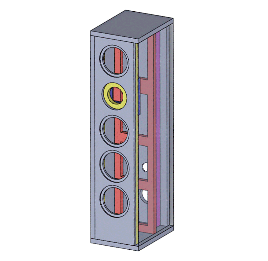

Alternate Elsinore Enclosure
For those DIYers interested in the amended design, please feel free to peruse the attached SketchUp file and if it meets with your requirements I welcome your feedback on the forum. Note, the CAD design has been assembled with all the enclosure components. All components can be detached and examined individually and dimension extracted for each for easy deployment.[/QUOTE]
Apologies due to all, found an error in one of the elements, ie Sub-Front Panel was malformed. Please see amended CAD file.
