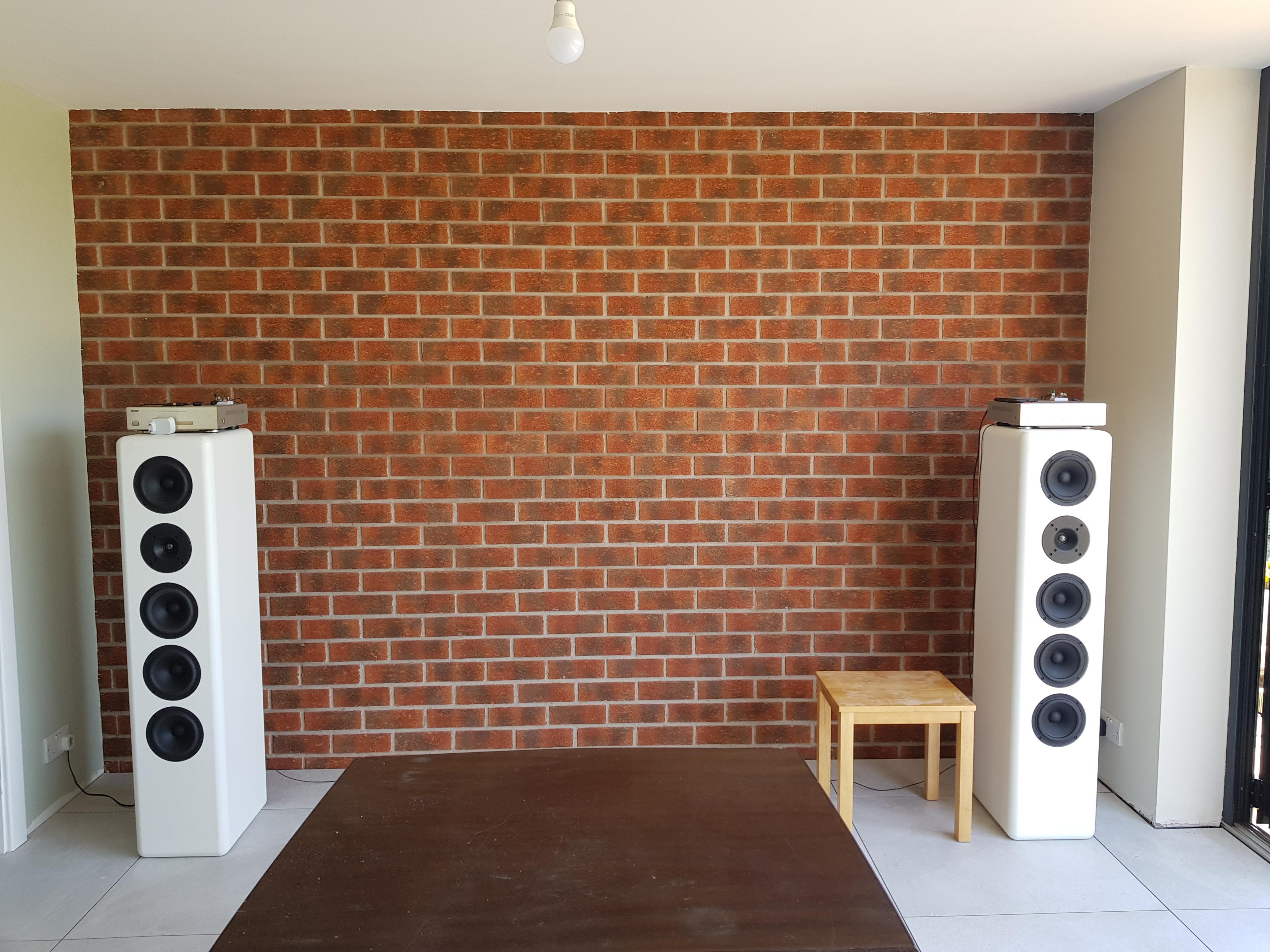

Great! Maybe some pics of your Masterpiece? :)
Here they are. More furnishings needed... One day they'll be reunited with the TV once I move to Finland.
Cheers

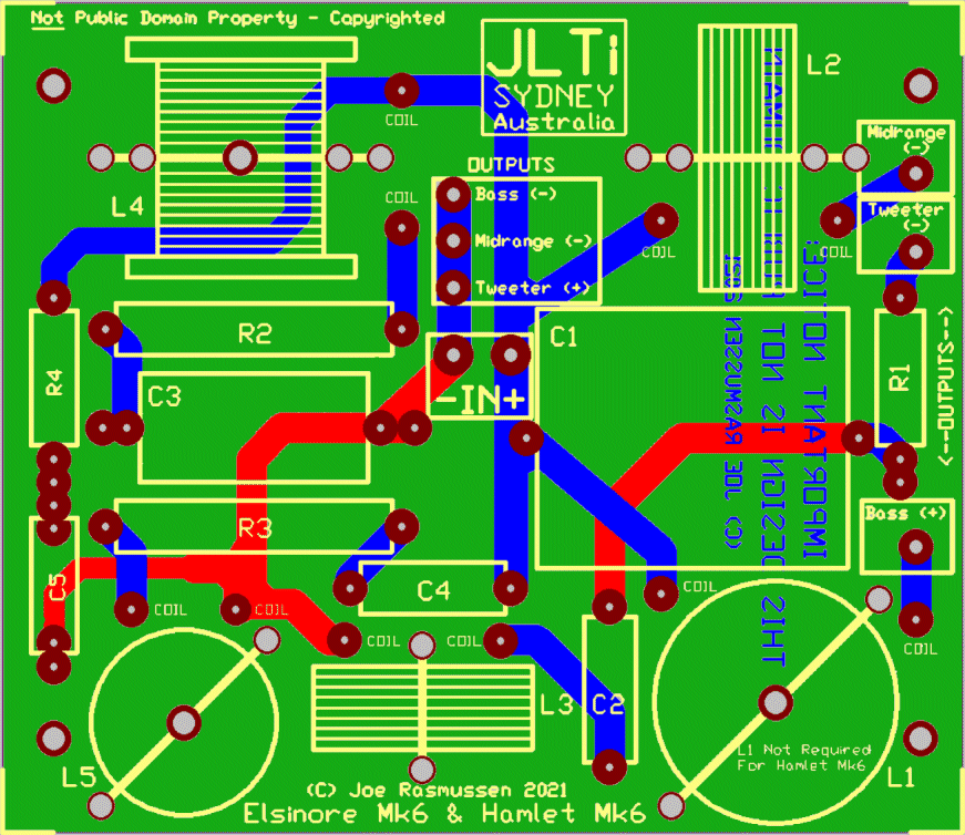

Thanks for the discussion of the PCB over this past week Joe. However now, due to the nature of the product would you please create a vendors thread for continuing discussion (Note 5 & 6) :cop:
I should have added that it was a Hamlet update. They need to know that I need the PCB to finish it and that means a delay. But getting there.
I could hardwire the crossover right now, I could get what I need almost overnight. But getting the PCB will take a bit more time.

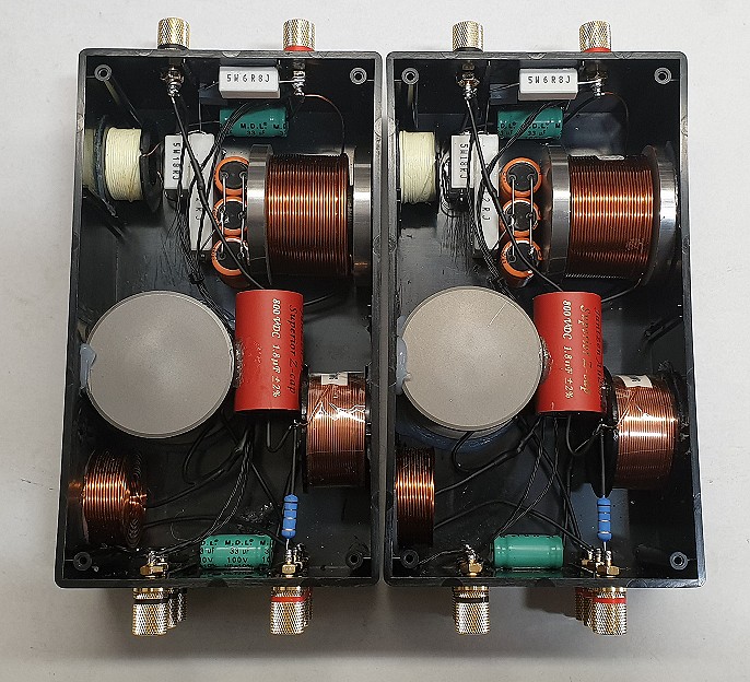

I have a good reason to switch to PCB when I had to make five pairs of crossovers, see pic below. That doesn't even show the wires (12) plus banana connectors (24) and it was too much. PCB is the way to go, now up to where it goes.
But thanks for reminding me about a vendors thread. I am getting the PCB primarily for above reason.

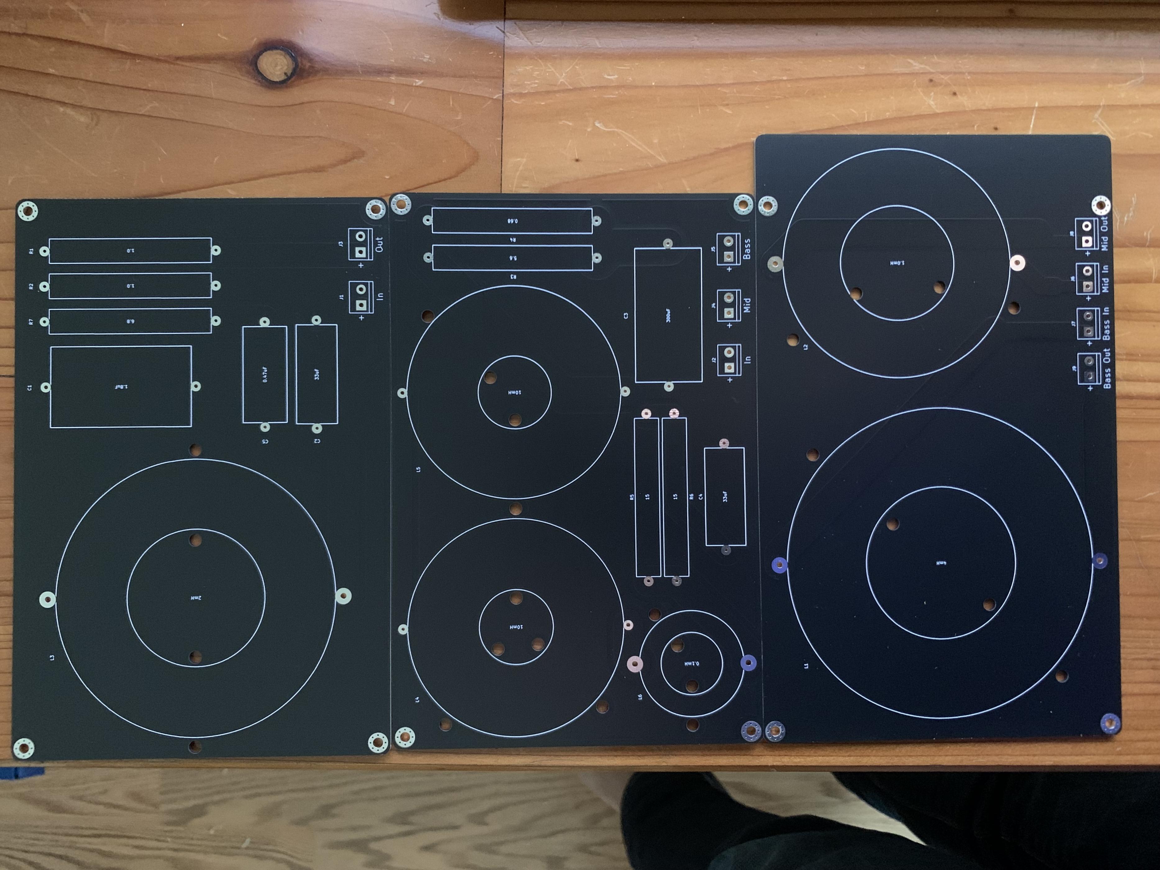

It's funny, I just ordered some PCBs meant for the Elsinore as well - though I took a different approach and choose to use larger air-core inductors. The results just got in today, and so far the boards don't look half bad.
My approach was to layer 3 boards on top of one another so they could fit into a box similar to this one or simply be placed in the bottom of the speaker. The two smaller boards are 180x120mm and the larger on is 200x120mm

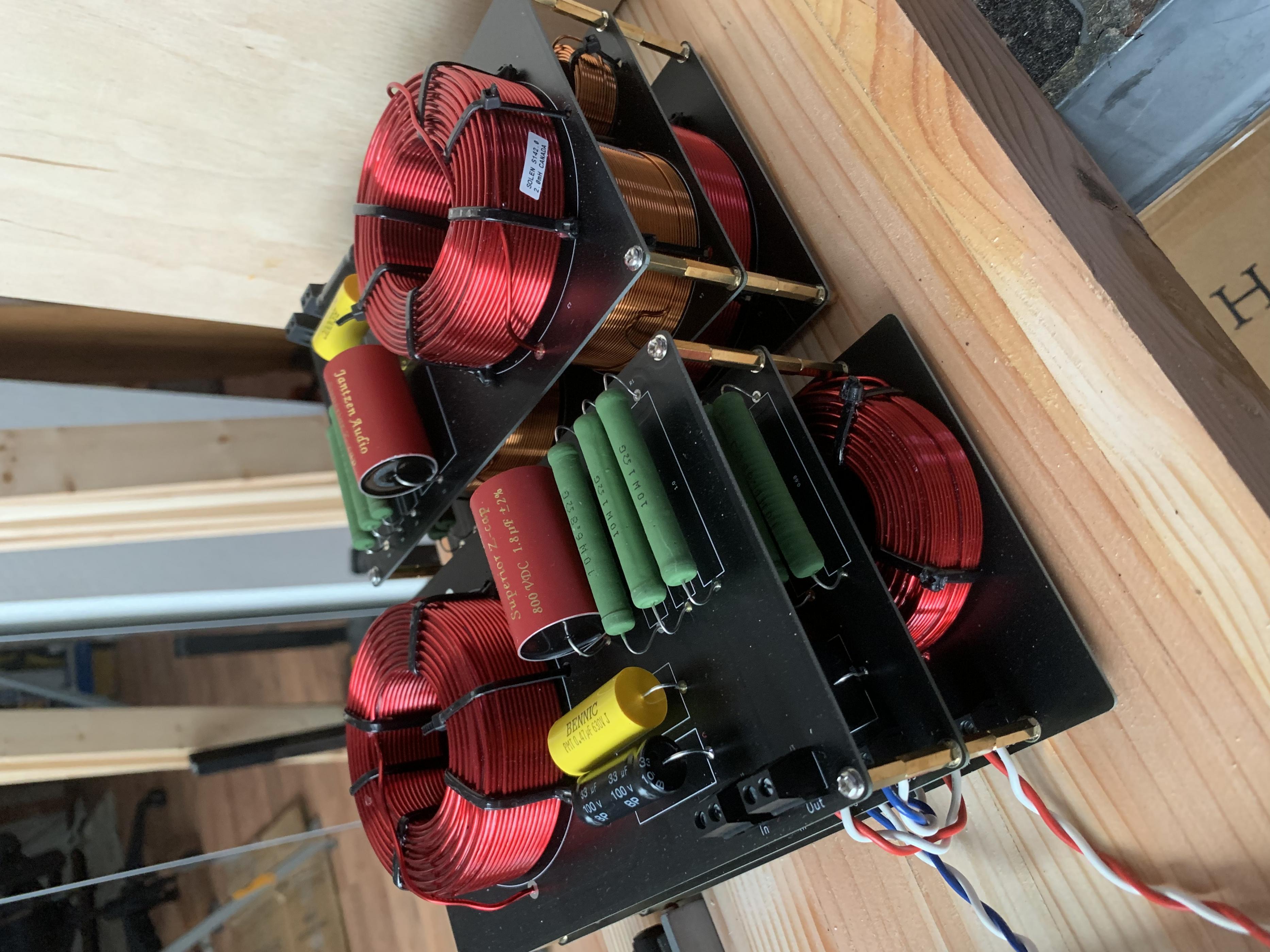

It's funny, I just ordered some PCBs meant for the Elsinore as well - though I took a different approach and choose to use larger air-core inductors...
I am also sourcing some 18mH inductors that are less massive and half the weight. There is no need to a low DC resistance inductor since it is already in series with a resistor in an LCR network. The inductor I am sourcing is 18mH and DCR is high at 3.2R, that means the series resistor value needs to be lower and I am thinking 3R9 10W would work, it means the total will be 7.1R (7R is the target) DCR and perfect. It is a quality inductor and made by Jantzen. Will I make those available with PCB, I am yet to decide but very possible.
Please note I am mainly getting this done for myself, but then open to help others. If I do decide, I will do as Allen says and start a new thread in the vendor's area. We shall see, but the more I think about it, it looks like this is where it is going.
BTW, it seems that you have to order this smaller inductor in quantity, this is what I am doing.
Neat! Curious to see how the final boards turn out, making this inductor available would probably be helpful, given that large value inductors seem to be difficult to procure (took me 2 months of waiting).
I just finished assembling mine... and they are heavy, roughly 10lbs a piece.
