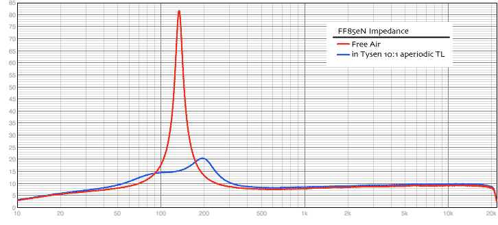

A TL can be tuned/damped from a very bass reflex like double-hump impedance — (a faster roll-off traded for extension in a small line -- at resonance all the way to aperiodic lines -- very flat impedance and little to no bass output from the terminus.
Here an almost aperiodic TL (the line it is a bit short, so the hints of the hump):
133540d1242324223-thread-tysen-variations-waw-fast-tysen-vrs-freeair-ff85-imp-gif
With every loudspeaker many compromises need to be made, and you have massaged the set of compromises in this loudspeaker thru 6 major versions to end up with something that, given all the very positve feedback, is quite special.
dave
dave
Indeed. It seems most commercial TLs have the saddle that indicate reflex action.
Some time I did a line that looked very much like it was a sealed box and I still have the Z measurement (took me a little while to find it) It was an 8" Peerless HDS driver into an about 6-7 foot single fold down-up filled line. It gave me a single define peak and no reflex action. The vent at the end just worked as a leak for the box? Your interpretation? See attachment.
901151d1607754052-elsinore-project-thread-aperiodic-gif

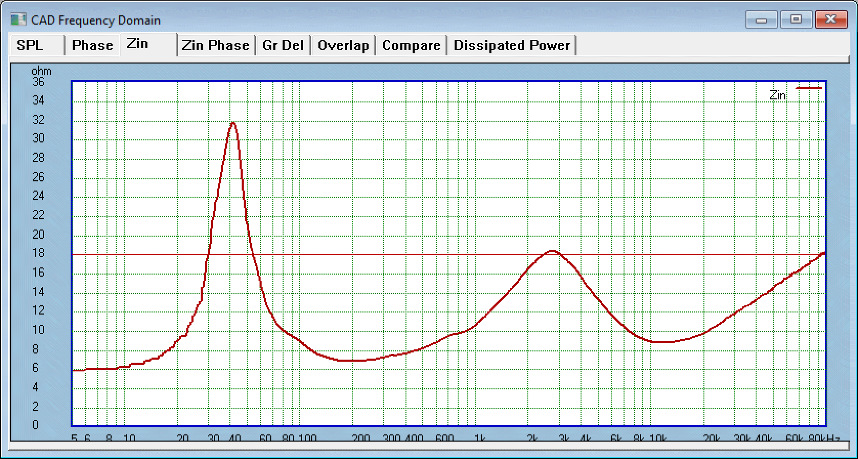

Since a filled 75 Litre box can be made to behave like 100-100 Litre box, then how should we explain it? Has it changed the apparent box size seen by the vent? By what mechanism?
Consider a sealed box with no damping and take a look at the peak of the electrical impedance of the woofer. The impedance peak shows the resonance of the loudspeaker system, and the frequency of the impedance peak corresponds to the resonance frequency (which relates to the bass cut-off frequency of the speaker).
Now, add some damping materials to the box, which will add damping to the resonance of the loudspeaker. In other words, the addition of the damping material will modify (attenuate) the shape of the impedance peak. The damping effect is usually stronger at high frequencies than at low frequencies. Therefore, the damping will be more effective at frequencies above the impedance peak of the undamped box than at frequencies below the peak. This means that the damping will "eat away" more of the impedance curve above the peak than below the peak.
The result is that the maximum of the impedance curve of the damped box will be shifted to a lower frequency than the impedance maximum of the undamped box. This is why adding damping materials to the box lowers the resonance frequency (and hence also the cut-off frequency). I guess this is what you mean by "it appears as a bigger box".
