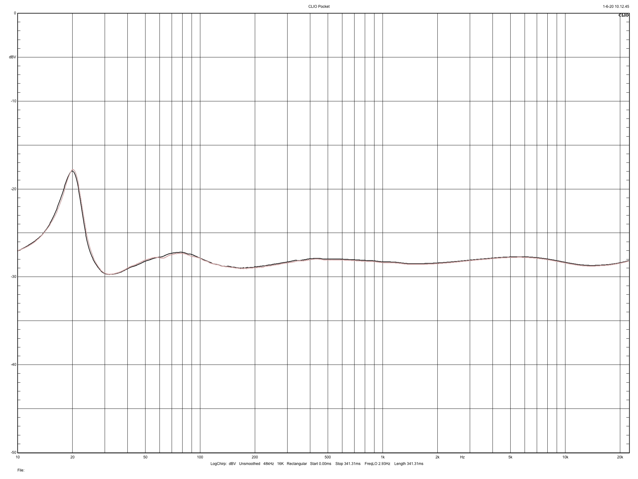

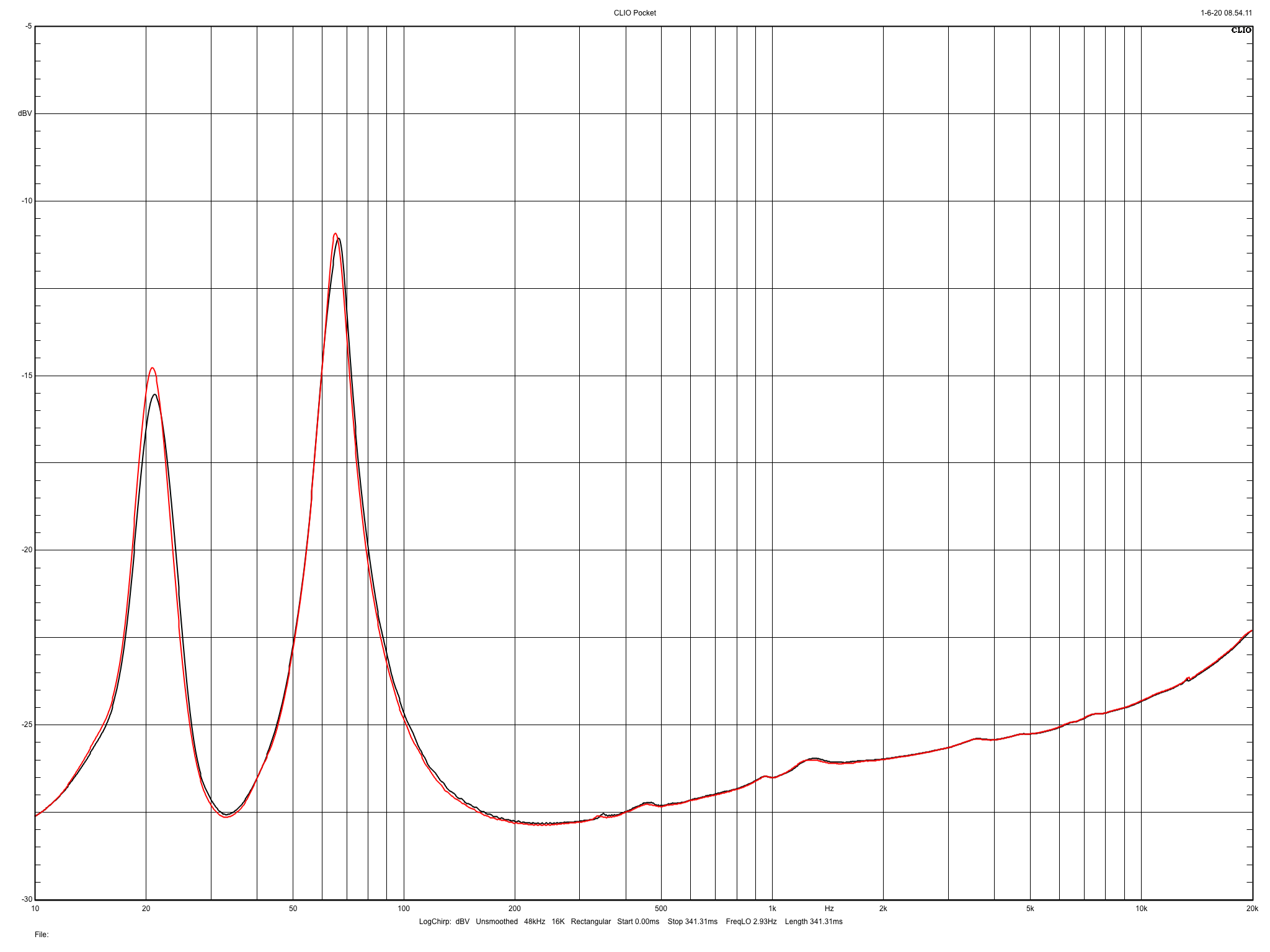

Connecting the compensation circuit is very simple. I see no error. When I put the whole thing together, I took measurements with and without the crossover.
Measurement of the mid-woofers themselves in the box. And measurement together with the crossover.
I do not know the output impedance of the EX-7M.
Yes, it is weird. There should be no change. Of course, I take into account that I have succumbed to some self-suggestion. Therefore, I need time to research this situation. And if anyone has such an opportunity, check it at home.
It's not that there is more to music. That something is not louder. It is expressive. It's hard to describe. But I definitely like it.
It takes time to tame it. Just to be sure it does change.

On the other hand, the compensation networks do interact with the xover+driver and with the amplifier. While the following may be a bit math heavy for some, it is just the conventional and well-accepted wisdom based on well-accepted physics (Ohms Law and Kirchhoffs Laws):
  • Vout is the output voltage of the amplifier.
  • Iout is the output current of the amplifier.
  • Rout is the output impedance of the amplifier (this includes the resistance of the loudspeaker cables between the amplifier terminals and the xover).
  • Z0 as the complex impedance of the entire loudspeaker (driver in box, xover, impedance compensation networks)
  • Z1 as the complex impedance of the driver+xover (without the compensation networks).
  • Z2 is the complex impedance of the compensation network(s).
The current output from the amplifier is Iout = Vout / (Z0+Rout).
The voltage across the loudspeaker terminals is V0 = Vout - Rout x Iout, and hence V0/Vout = Z0/(Z0+Rout).
If Rout is not negligibly small, the amplifier / loudspeaker form a voltage divider system. If Z0 varies with frequency (as with most loudspeakers), the voltage divider formed by the amplifier / loudspeaker is variable with frequency, too. This means that the frequency response of the entire system is modulated by Z0, which will affect the sound reproduction. To counter-effect this problem, impedance compensation networks are used in parallel to the xover+driver (Z1) to remove (or at least to reduce) the frequency dependence of Z0.
With the compensation networks in place, the impedance of the entire loudspeaker is:
Z0 = Z1 || Z2 = Z1 x Z2 / (Z1 + Z2)
The trick is to design the compensation networks such that Z2 balances the frequency variation of Z1, and hence results in an (almost) constant Z0.
If Rout is very small (much smaller than Z0), Z0/(Z0+Rout) = 1 and hence V0 will be equal to Vout, and Z0 will not modulate the frequency response of the amplifier / loudspeaker system. This means that the sound is not affected by the loudspeaker impedance as long as the output impedance of the amplifier is (very) low.
Therefore, assuming that JarBars amp really does have low output impedance, I do not understand how/why JarBar observed a clear sonic difference with / without the impedance compensation networks. Maybe the cables used in between the amp and the speakers were very long or thin (resulting in high Rout)?
