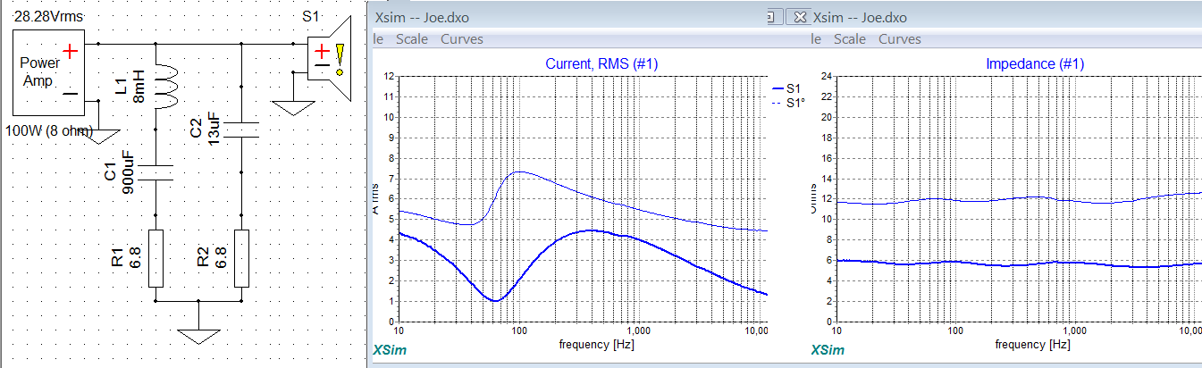

So I thought I'd demonstrate how to do this.
..that with just an equaliser/signal processor one can achieve this with a speaker by adjusting the response. Siegfried Linkwitz among others had a lot to say on the subject.

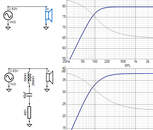

Unfortunately there looks to be a glitch in applying Pavel's current distortion tests here.
..and the excercise revealed something interesting.(and it will be revealed how) I can also the Q of a sealed box alignment from Butterworth (0.71) to a more damped Bessel (0.56)

Some quick thoughts.
1. It is the 1K that makes the difference... it happens to be the same value of a current source used by Neville Thiele, measure the Re and the voltage across the driver and plotting the LF Z and hence the alignment could be calculated when fitted into boxes of different sizes. The added LCR you show (get the values just right), now affects the current versus frequency because the current of the source is effectively fixed within a few percent. The alignment is a function of current versus frequency. Do the maths and why it is near -5dB at Fc and at half-octave it is -14dB instead of -12dB because by then it has become a fully developed 2nd order. Anything above the Re value is a voltage source and here it becomes an impedance, yes, voltage becomes a back-EMF impedance. It all fits together and I have even done the maths and it was accepted by Dr. Rod Crawford who could not fault it. I think even Scott Wurcer here might think it is at least near the mark?
"Back EMF has been known for almost 100 years now. It can be shown that as far as the amp is concerned the back EMF simply looks like a complex impedance and... There simply is no difference between back-EMF and impedance." Earl Geddes in a PM to myself.
Yet Earl disagrees with me, and yet he agrees with me at the same time? It is very perplexing. I have been 'corrected' for using the phrase "back-EMF impedance" and yet he uses it himself in a PM. Very curious.
2. You know what that does to any theory attached to amplifier's having a 'damping factor' and as to whether it is a Butterworth or Bessel? I can tell you, Richard Small taught me that it is the alignment that determines the damping entirely and not the output impedance. He and Thiele disliked any theory of the amplifier as having 'damping factor' and even Small said it irritated him.
3. Pavel's effort may leave something to be desired, but he made an effort. I just wish he would have engaged with me differently when I approached him. Instead he treated me like, what can I say, as a flake? That I just don't get and if he reads this and has changed his mind, I will forget the past and look to the future. In the last 5-10 years there has been things slowly happening on this subject and the future will win.
4. I also credit Esa's book, I was one of the first to get a copy. Even if there too I believe he has made some incorrect conclusions. I think some very unkind things have been said about him too. Like some saying that he has been "debunked" and that is not the case at all.
But we live in interesting times, on multiple levels!
Cheers, Joe

Yes h3, h5 etc. distortion components drop considerably with current drive even if the driver has copper shorting ring and very low Le. Easy to test with a series resistor. Also measuring with an SE tube amp (at low levels) they are always little lower than with voltage source drive.
That impedance smoothing rlc cannot be used Im afraid, it will negate the effect of current drive (look at the loopback impedance, which has to be high). If you put a 8ohm resistor across the driver's terminals, the net "drive impedance" is 8ohms, not 1k (= limits the effect of current drive to equivalent of 8ohm series res/output imp.).
The impedance has to be made flat with an aperiodic enclosure for the full effect, at least this is my impression. Been using strategical current drive (for ex. favor series res attenuation, not l-pad) for many years. Once had a fullrange drivers with considerable amount of current drive in a form of 50-100ohm series res + step-up transformers to bring the sensitivity back up. The effect to h3, h5 was quite dramatic. H2 can be higher near the Fs, but H2 in of no importance SQ wise.
