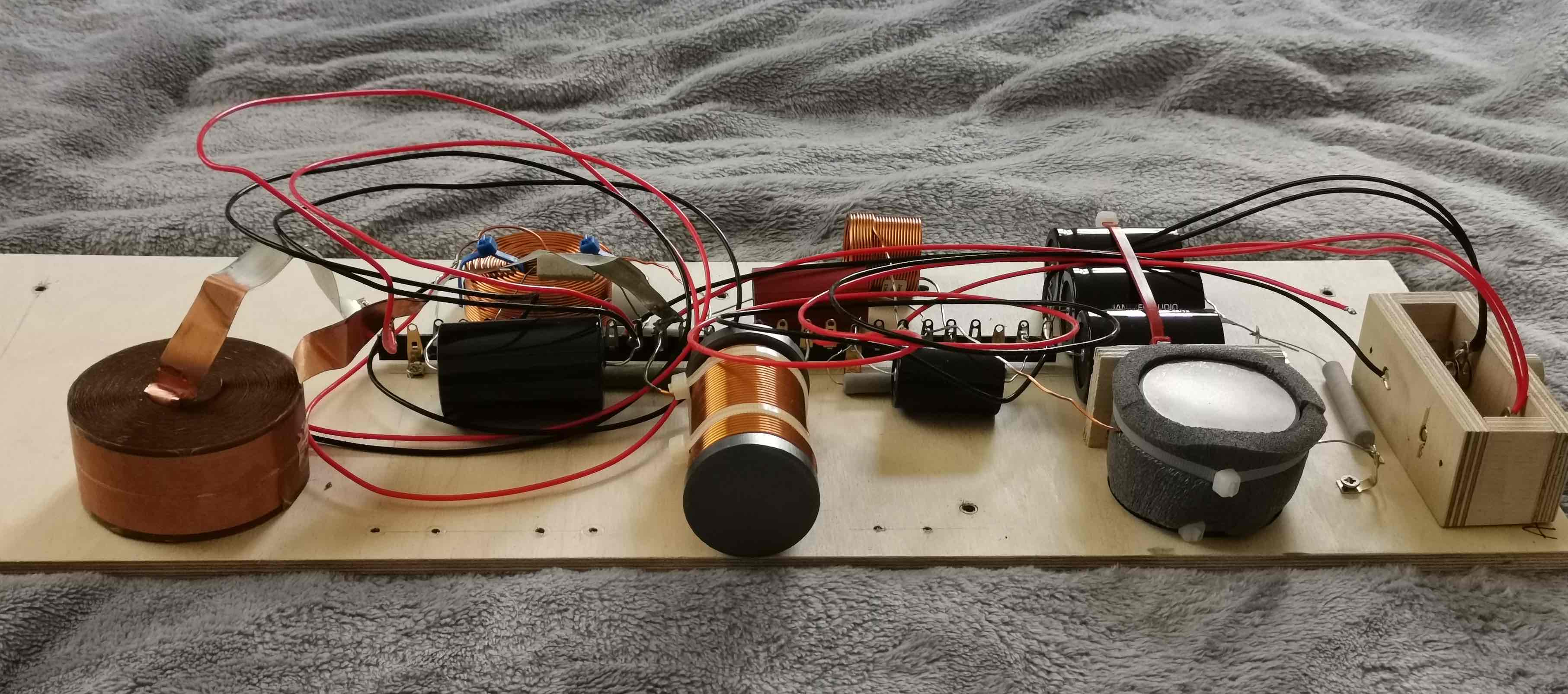

Had the wave guide sent from Joe, and all else ordered from who ever had the most in stock. Now that the cross overs are done, i'm way more familiar with each part, but ordering all the parts cold turkey was an endeavor. No one vendor carried everything and i probably had 5 tabs and shopping cards filling up at once. For me, it was a bit of juggling that I enjoyed very little... Thankfully all shipped complete and correct, so if there is a next time i should be more comfortable.
Trying to post a picture of the completed cross overs, but nothing i tried yet will properly rotate the picture for this forum..

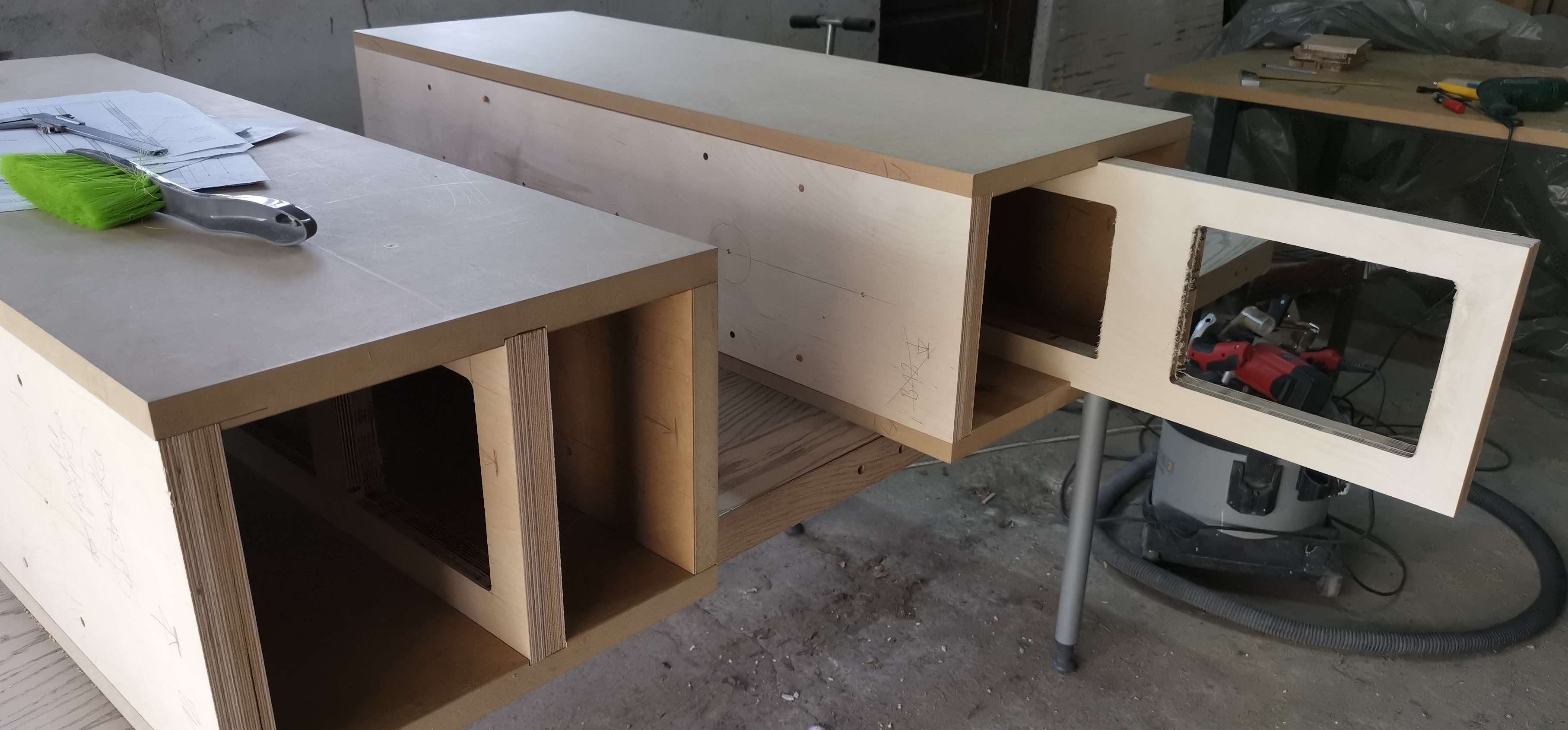

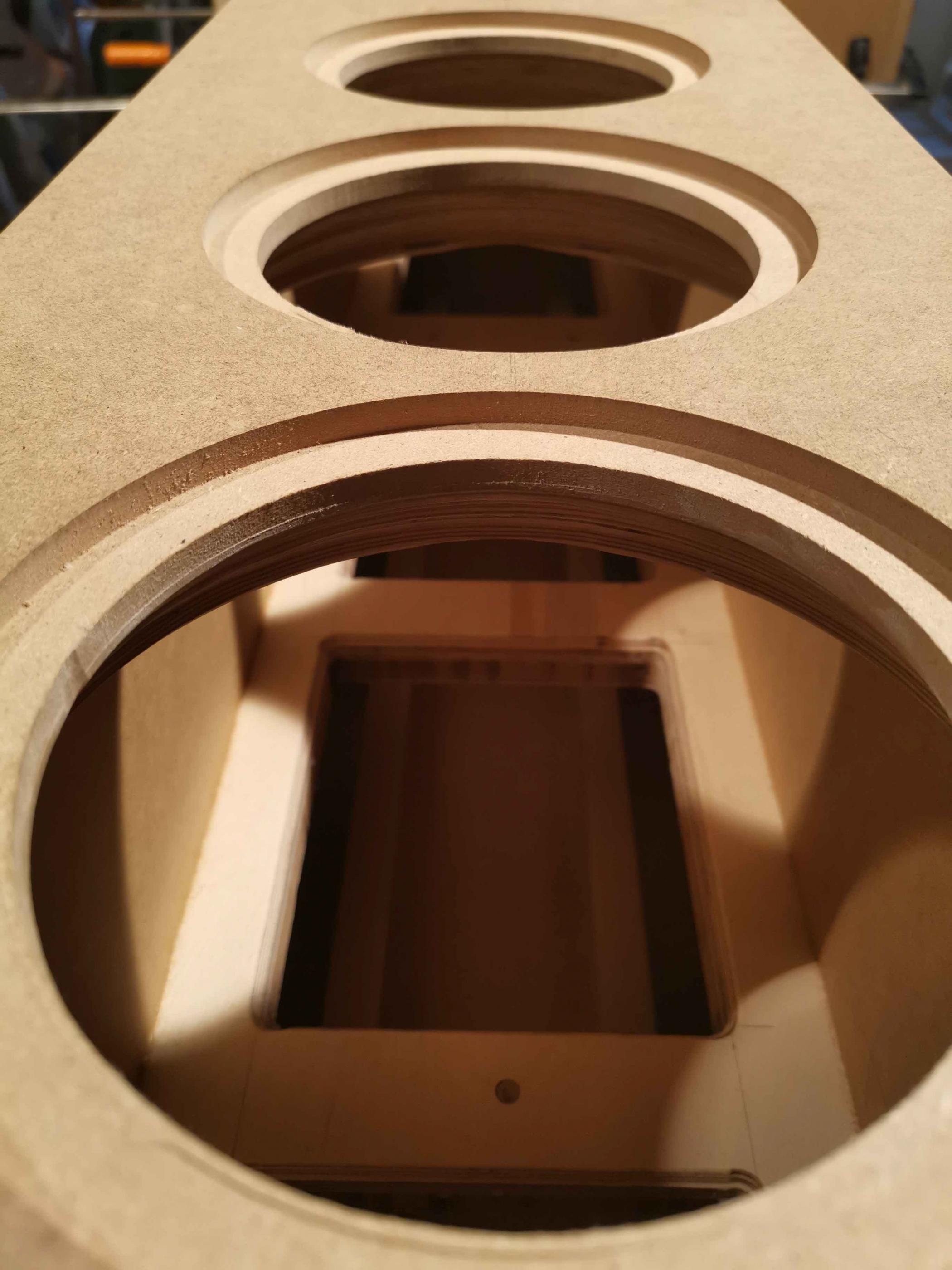

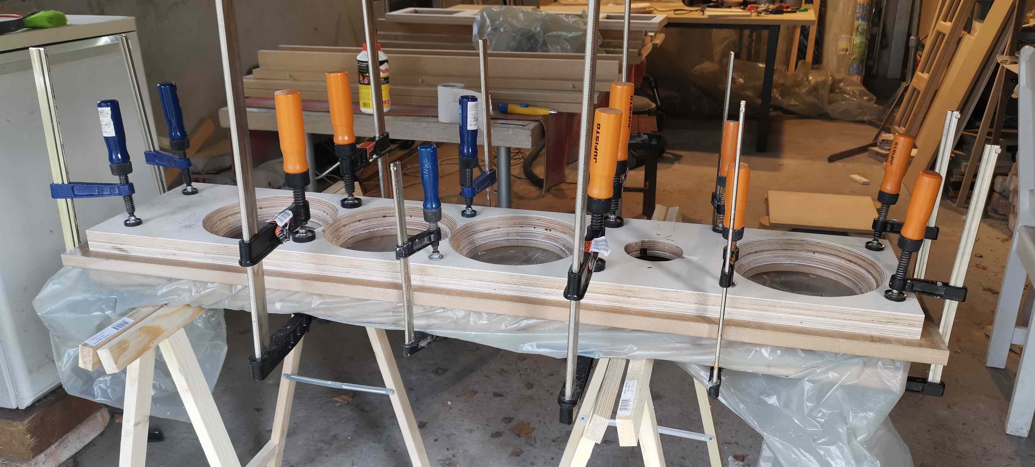

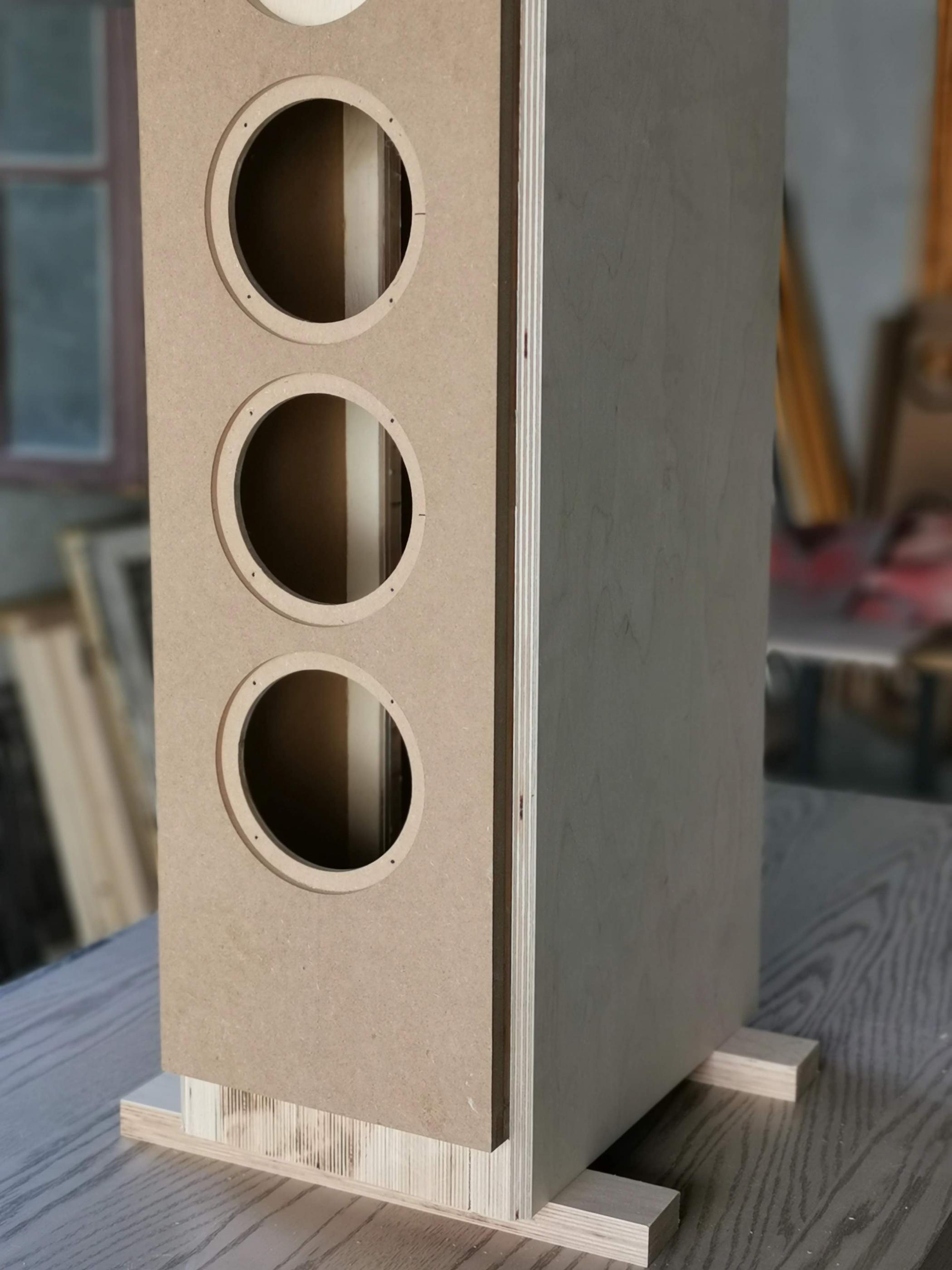

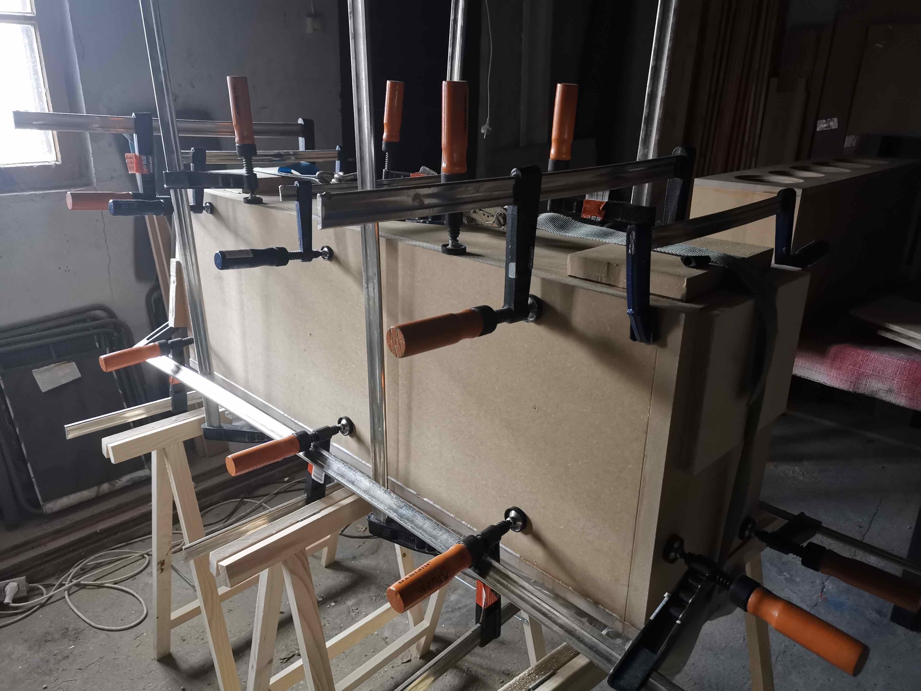

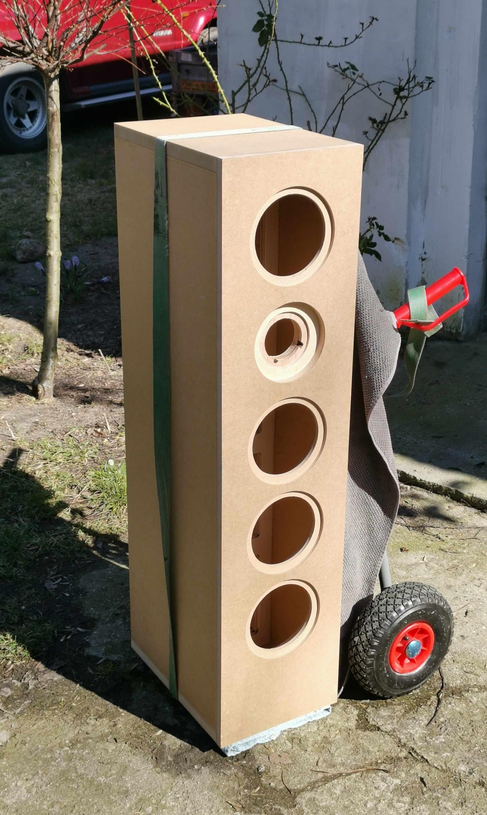

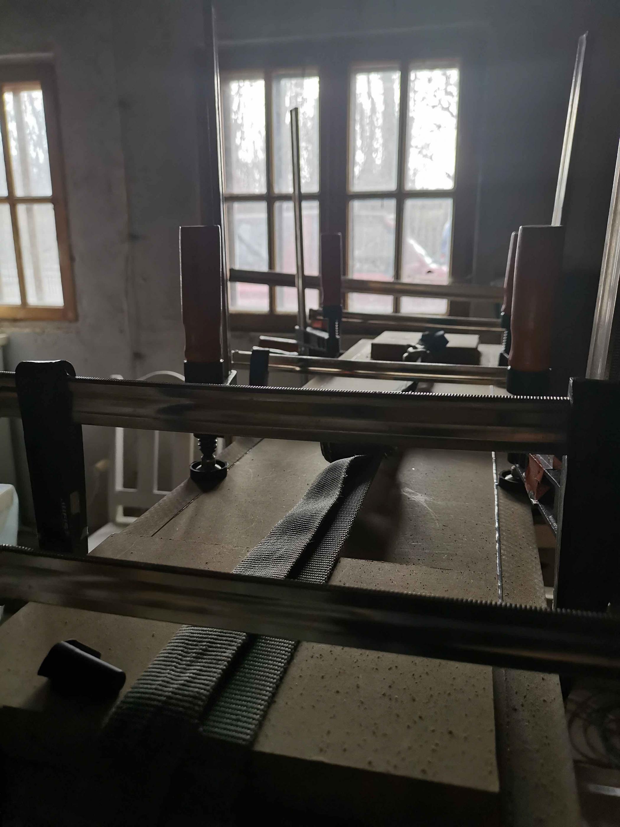

Construction has made significant progress since January. The speakers have been playing for a short time. Now they are at the varnish's shop. The whole front will be black. The rest covered with plywood. The crossover will be installed on the back of the housing.
I hope that in the coming month I will be able to enjoy their sound forever.

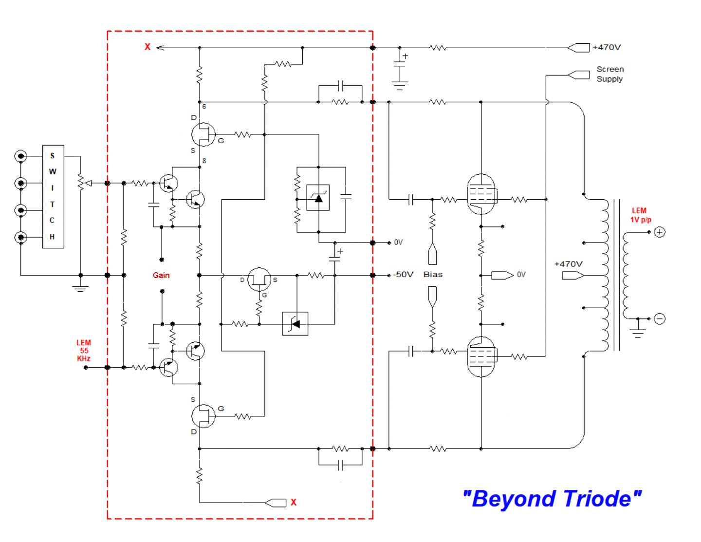

Some of you may know that we have been working on a new principles amplifier. This a new design from the ground on and breaks a lot of new ground. Using the 'new' word often gets out the trolls, but when the output tubes runs near Unity Gain and are not Cathode Followers, that you need a gain of 500 plus from the front-end and -24dB loss of gain to the speaker, those numbers indicate something radical going on. The new front-end circuit was modeled by the head of Power Electronics (behind SpaceX Exploration) in California. It took us from October 2016 to January 2020 to complete development. The late Allen Wright left a design behind, one that we did not copy, as it was completely impractical for us - but he showed us the way through that design that "Beyond Triode" operation was possible with Pentodes - this now means we can get better results from Pentodes than pure Triodes, in fact, we can go "Beyond Triode" and that is what we decided to call it. We were able in the end to push the concept way past what Allen did - that took a long time.
I have also had an approach from a company about the development of a 3-Way "Active Speaker" system that uses all current drive. This has not been done before because current drive lends it itself to drive midrange and tweeters and there are already designs out there doing this. But none of them are doing it on the bass because it has been put into the too-hard basket - in fact it is considered impossible to do. But we know there is a way to do it, and it proves that you can turn a Butterworth alignment into a more damped Bessel alignment by going from voltage drive to current drive. Yep, more damped alignment from a current source. The trolls will tell you that is impossible, but in fact it has been done by controlling the current vs frequency, you can dial-in more damping if you wish.
I am also working on a paper that I think will take a few more months to finish. This is a fresh look at the interface between the dynamic driver (voice coil, magnets and cones or domes etc) and that of the amplifier, it points out that ALL amplifiers are in fact current delivery systems, whether they be Class A or Class AB, Class D, solid state or tube amplifier, that they are all just different types of current delivery systems and that the output (the sound pressure level) of a loudspeaker driver is only in proportion to current and not the voltage. It will not be entering into any war of "voltage drive versus current drive" that seems to be emerging. They both have plusses and minuses. But to get the lowest possible distortion out of our designs, we need to know what the current does - and what it does will sometimes really surprise you and question opinions you previously had. But that also points to resistance, as that is the nature of these things. I will have some really heavy-weight support including several physicists, several renowned speaker designers as well as support by amplifier designers - and we are also working (now actually completed) a design of our own.
I will have somebody in the USA be able to supply amplifiers based on a rebuilt amplifier from China. I will also have somebody in Malaysia doing it for our Asian friends, another in New Zealand and myself here in Australia. Looking for somebody in Europe to also help out and have a couple of guys there that I hope will work out. We shall see.
This amp matches what the Elsinores and Hamlets do, where the emphasis is entirely on current and not voltage - but this is not current drive and yet it has advantages of both current and voltage drive.
So if you have Elsinores or Hamlets, this is the amplifier for you.
