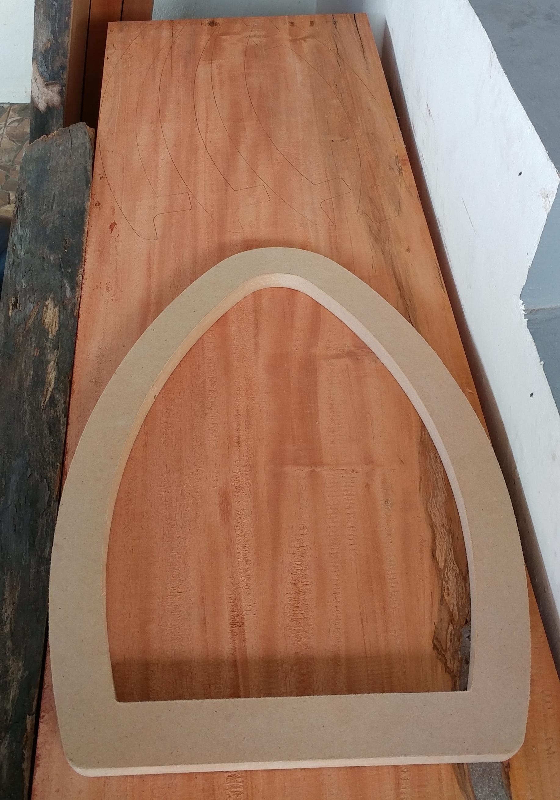

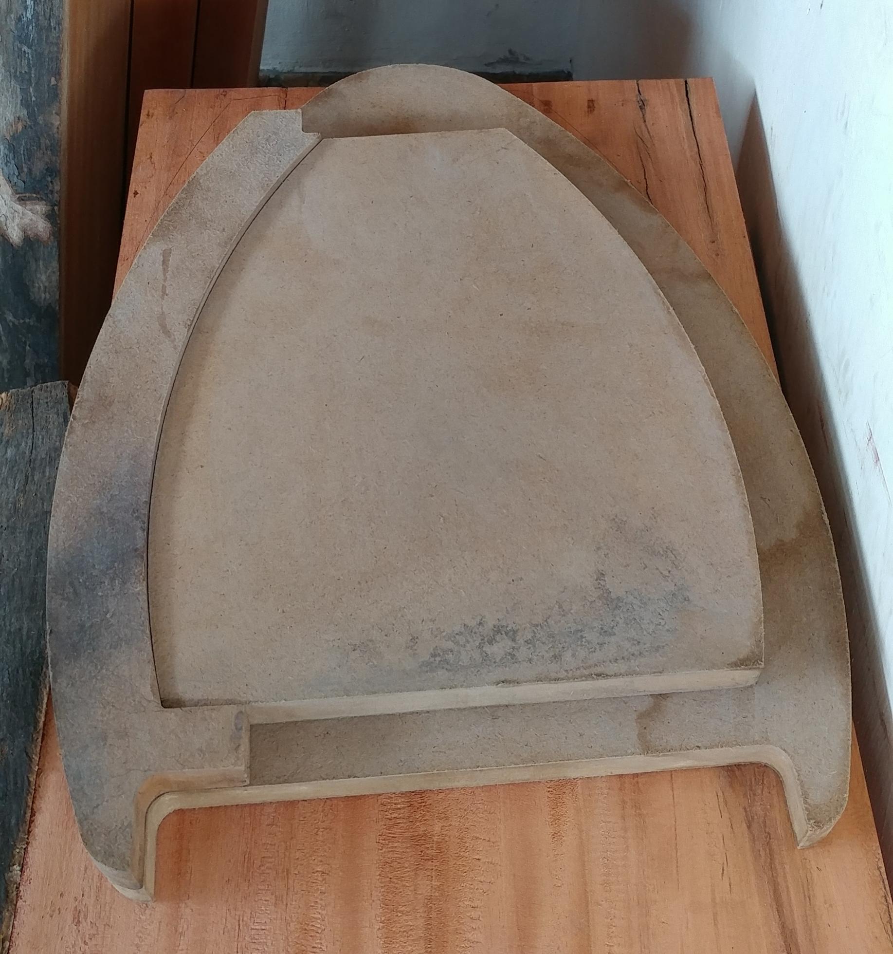

it's just that i still don't decide yet on what should i build with 10p, once i considered to sell it (also with AN 8 classic) to reduce my inventory but i will keep it for a while and decide later after completing Elsinore
i just find my previously ordered template have been exposed to moisture but still in good shape.
attachment.php

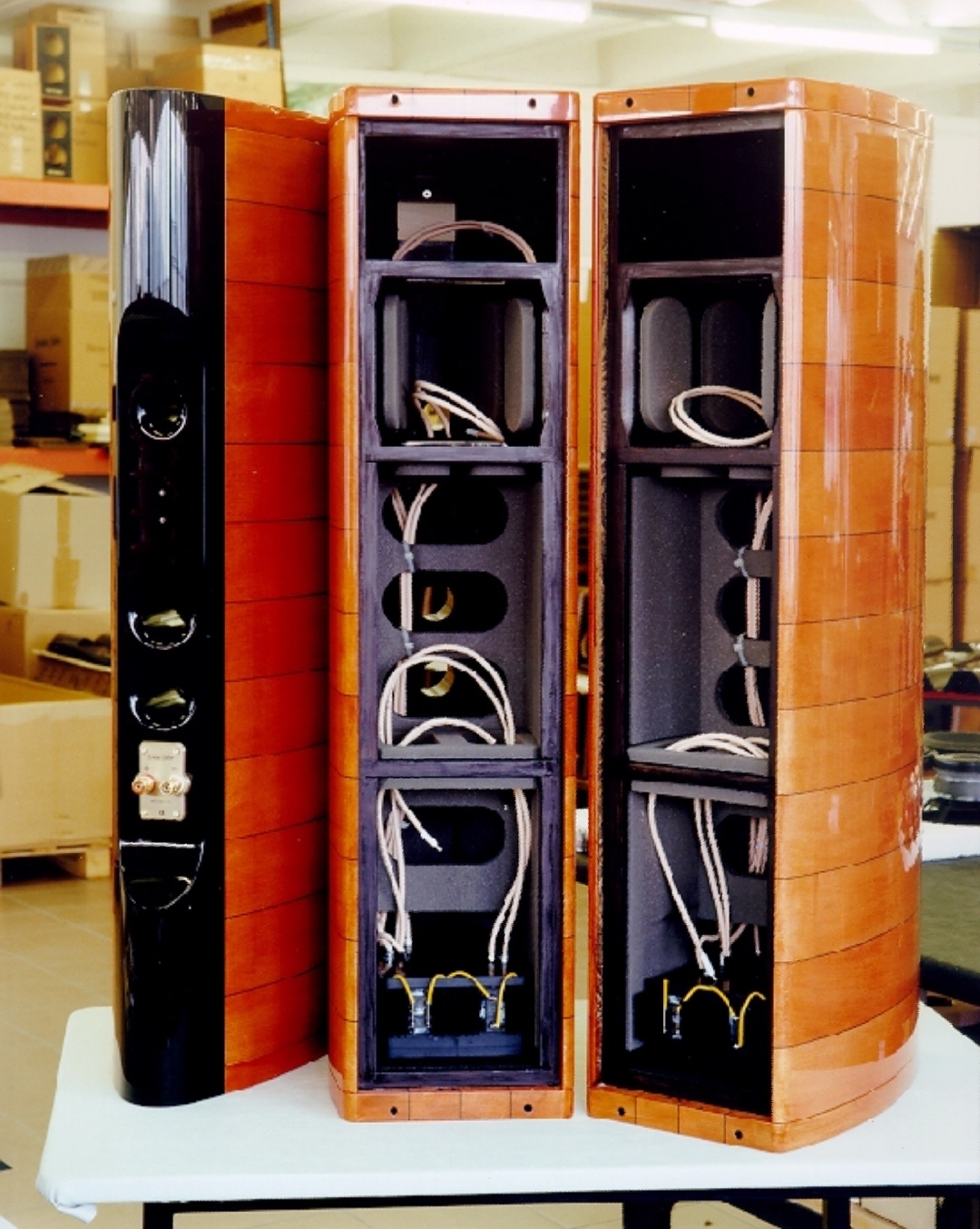

when i draw it to my lumber, the old template has higher output result where 1 lumber can give 10 layers compared to new one which will only give me 4 layers. the different is that i only need extra on gluing and make front/back baffle
attachment.php

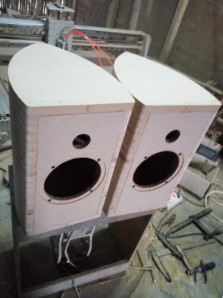

my friend has built smaller bookshelf and it looks good. i think i will go on my older template SonusFaber style to reduce wood waste :D

When using real wood I think I would line up the grain with the forward part of the cabinet wall (the curved pieces you have traced). In addition, the "thumb" that sits behind the baffle edge is susceptible to snapping along the grain, and should be reinforced in shape.
