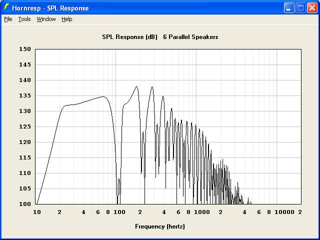

Basically, I chopped the design from post 24
http://www.diyaudio.com/forums/subw...c-5100neo-loaded-20hz-horn-3.html#post2135015
into 4 identical quarters - so I can lift them individually. They work out 42 x 44 x 160 cm each. That is slightly longer then the plan because I have inset the rear plate to protect the speakons and have inset the front to add a grill and foam. Internally it should be essentially the same volume and path length etc. per driver.
Making 6 because I have 6 3015lf drivers left over.
I am very curious how they'll do...
Regards, Ben
hmmm....
keep in mind that post 24 was just for justin's obvious infatuation with 20hz@140... That was the reason for the reverse taper. Somehow I doubt that you have the same need?
A t-tqwp at 1000cm2 and 300cm long would probably suit you better. (roughly 18x18x60) Keep in mind that when trying to put a 3015lf in a TH below 40hz, that excursion in the passband starts to be an issue. (remember how in the big box you can't push to 63v without exceeding xmax?? It's even worse in a 20hz box) The 1000/300 t-tqwp is only good to 40v, but then 6 of them gets you 133db flat to 25hz in 2pi. Considering the 28hz dub, etc... kind of music, that seems reasonable.
20hz is just a tough animal to tame in a horn that is still portable....
Quite right.
I don't at this point in time need 140 dB @20 Hz. Low to mid 130s would be nice.
But I do need a system for electronic, dnb and dubstep indoor gigs with 50 - 200 people.
Therefore I decided to use your design, just build a smaller number.
Am I wrong in assuming the response will still be nice and flat?

Is this correct?
If the board is straight, this will
- make the extension less flat?
- increase the sensitivity and power handling?
- but forcing me to move the highpass higher than 20 Hz?
Should I also centre the baffle like in JustinT's very simple TH?
Regards, Ben

yep, should raise a couple hz in tuning, help in the xmax department in band, and increase sensitivity a bit.

So we just move the highpass up to maybe 25 Hz? or would 30 be safer?
Then I could hit it with the output of an EP 2500, using the internal 30 Hz filter, and it could power the whole sixpack?

Plan C?
I guess I jumped in to this a little quickly, so now I'm trying to think it all over again.
Would it be OK to leave the baffle angled as in the plan, but close off the smaller side of the horn, and open the other, i.e. to switch the side of the mouth and reverse the taper?
Would this make the cutoff frequency around 30 Hz or as high as the stadium horn?
Regards, Ben

Plan D - make two switchable fronts, which can be switched if necessary, depending on gig - high volume or ultra-low bass... Please tell me it isn't stupid!
you're overthinking... the taper positive, straight, or negative only affects things about by a db or so, and a couple hz at most.
straight gives you 25hz, and that's the best compromise in my opinion.
You do need to limit to 40v, if you want to keep below xmax in the passband. (maximum excursion at 32hz)
attached is 6 speakers at 40v each in 2pi.

I'd nudge the baffle a bit just to give a full cm clearance... Not for any other reason than it'd make me feel better. I'd also glue some thin open cell foam to the board directly behind the driver, to kind of dampen the sound of any port noise. It's amazing how much port noise that driver actually makes.
