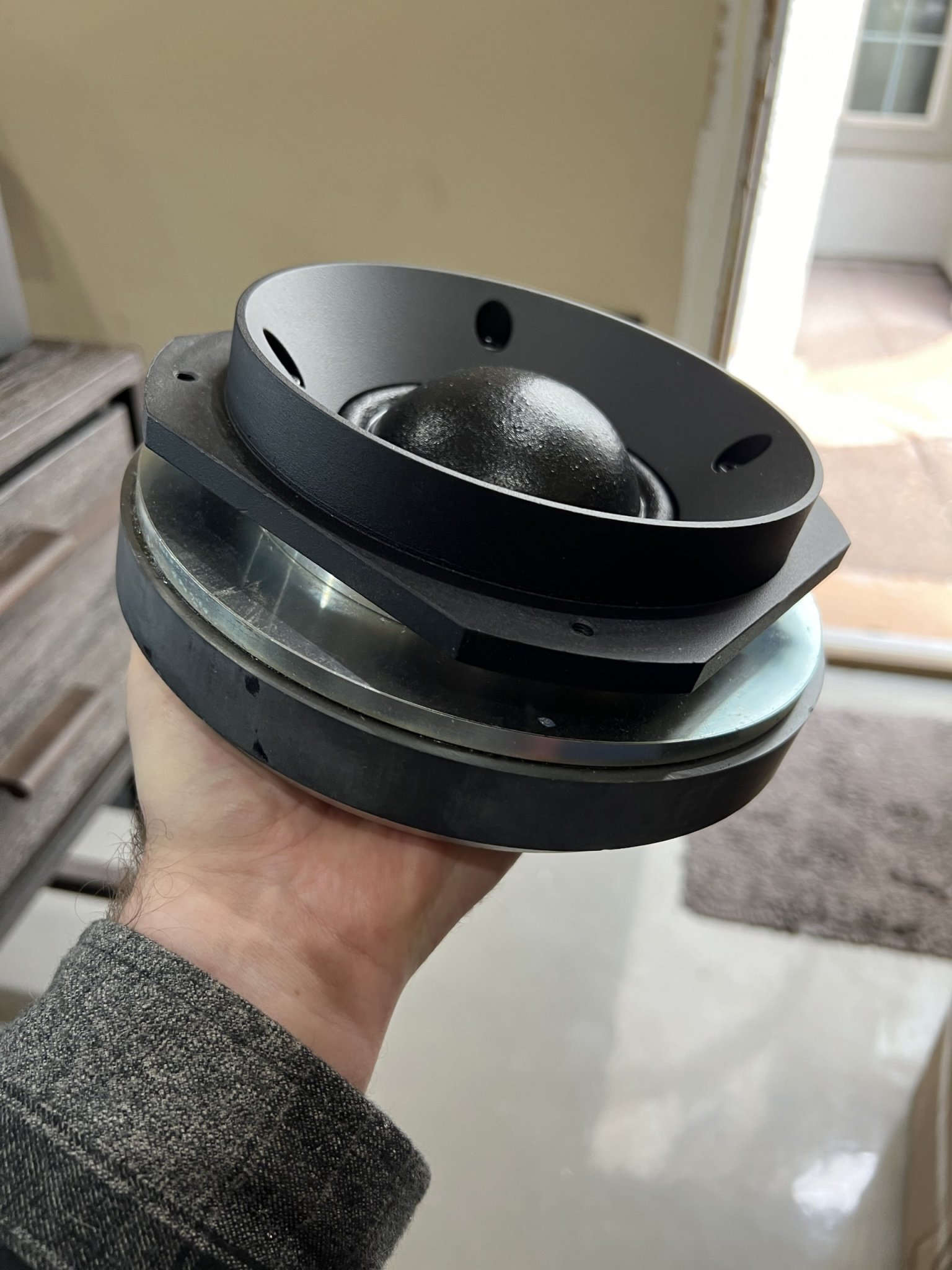

Yes, there is no comparison between the ATC and Volr domes when you look at the performance potential of the ATC in terms of sensitivity and xmax capabilities. The Bliesma mids will outperform the Volts by a big margine in terms of bandwidth and sensitivity, but the Volt 3" isn't as fragile as the Bliesma for sustained higher output levels.
I ran a set of party speakers with the 753s at 110+ dB levels at typical listening distances in medium size rooms often for several hours at a time doing dance parties. There was no perceived strain with the 753s running from 600 hz LR2 to 3.7k BW3 along with JBL 2206 and WGed Audax TW034 in ported cabs. These were my go to party/special event speakers for over 20 yrs and have never let me down. They filled any room full of people very evenly, sounding cleaner and smoother than most typical 2 way active LF + horn active speakers. The mids were predictably cleaner and much less fatiguing. The Volt domes can easily deal with 150W long term. Most other cone mids wouldn't cope with those power levels while remaining as composed. If I were to build another set of non CD equipped high output 3 ways, I'd pick the Volt mids any day over any other smaller cone mids or CD + WG based solutions.

@IamJF When comparing the Bliesma with the Volt in terms of durability alone, the Volt has higher temperature voice coil materials and a much larger motor with alot of thermal mass to absorb and carry away heat. The windings are copper with a fiberglass / nomex former. This is good for long term power handling but hurts bandwidth.
The Bliesma uses a titanium VC former and copper clad aluminum windings that aren't as capable of enduring long term heat loads compared to the Volt. Titanium is a heat insulator and CCA windings don't handle thermal cycles as well. CCA will anneal over time and tends to fail sooner as well as needing special processes to solder. Their smaller neo motor will heat up faster and won't carry away the heat as well.
Bliesma chose to focus on bandwidth more than durability. For consumer use this isn't an issue, but for pro use at higher long term power levels, their design is more vulnerable to failure compared to a typical pro design using the heavier, higher temp materials.
I personally prefer the Bliesma over the Volts when considering acoustic performance alone. The Bliesma neo mid drivers won't endure high power use for as long as the heavier Volt mids will. I've used the Bliesma tweeters in higher power designs but HF with higher xover points doesn't require as much power, even for longer periods of time. The higher efficiency also helps here.
I will always prefer the Bliesma sound quality over the Volt mids, but for specific high power, long term use, the Volt is the logical choice when the design calls for a large mid dome. ATC is even better but not available to small scale builders like me. Thats the hard reality of it.
