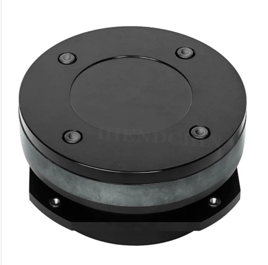

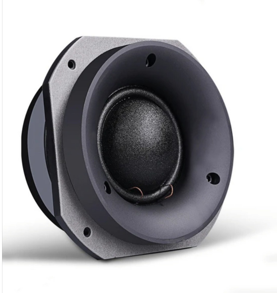

is this the 4inch atc dome mentioned earlier in the thread ? sorry I can't remember the posters name .this is taken from the listing of a boxer studio monitor stated as using atc drivers in the advert .
Looks like the standard 75mm ATC mid to me. I'm not aware of any current production 100mm ATC mid domes.
Edit * upon further inspection, it could be a custom run or 3rd party design from ATC - I've seen this once before, but I'd be very skeptical as to their authenticity based on some other ripoffs I've come across. I bought some used 75s from a guy in Canada, one of which had 2 different sized fastener threads on the front flange. I sent one to ATC and they decided to keep it for closer inspection, claiming it was a fake.
Even if so, the acoustic upper cutoff on it would be around 2.5k and that wouldn't mate well with a 25mm tweeter, even with steep cutoff filters.
If anyone feels adventurous, I'd be tempted by this despite its origin and blatant ripoff. ATC could do licensing agreements on their 75mm mids to make it worth their while and at the same time make it less lucrative to produce Chinese copies. I wonder how much different (worse) this driver is than the original -
No it is not. The ATC 100mm dome never made it into production as far as I am aware. I also thought the Boxer used a copy of the ATC 75mm dome identified by have four baffle mounting bolts instead of three?

It should also be understood that a significant part of the (wholly justified) folklore surrounding the ATC dome is as a result of its high reliability even in the most demanding high power applications. Such performance results not only from its design, but significantly also from ATC's proprietary manufacturing processes too. Just because it looks similar, does not mean it will perform the same - it certainly does mean it will last the same!
