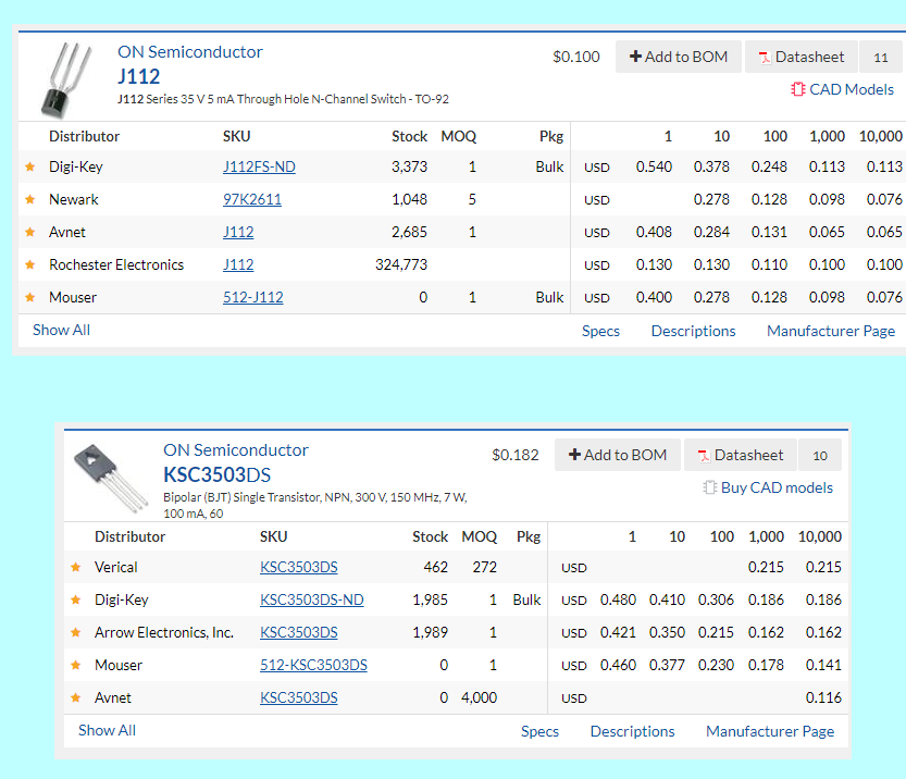

For comparison purposes here is today's OCTOPART.COM price sheet for the amplification devices used in the M2x "Mountain View" input stage daughter card. That's the stage whose circuitry is single ended Class-A, and which does not use any Toshiba JFETs at all.
To build a stereo pair of Mountain View boards, you need to buy a total of 2 pieces of J112, and 6 pieces of KSC3503. I am amused by the money numbers.

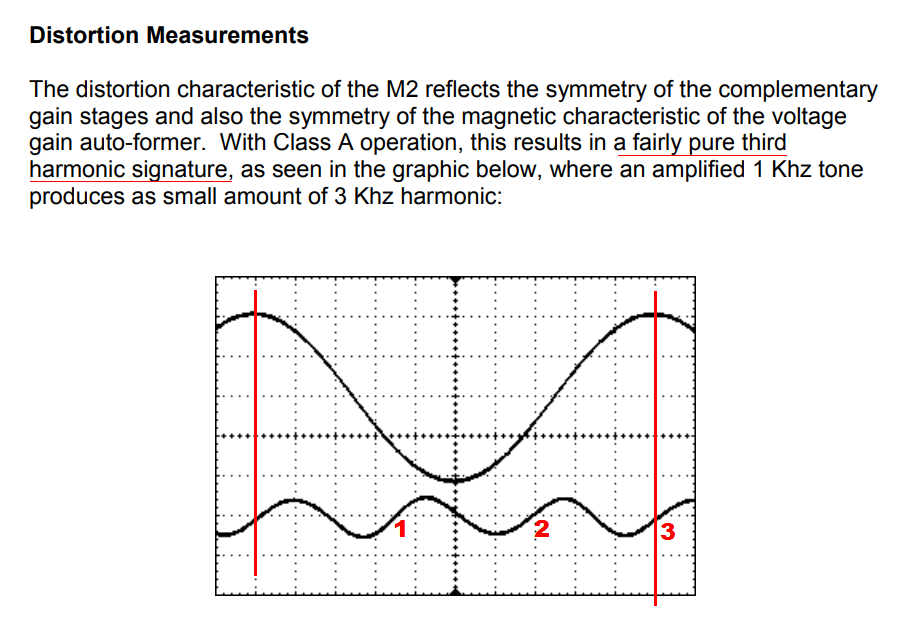

... For me at least, I would prefer something that I can adjust to yield a negative phase H2 ...
By all means, feel free to do that! You will be pleased that the layout of the Ishikawa PCB, makes your modification particularly simple and straightforward. No cuts, no jumps, no new drill holes. Just calculate new component values, stuff, and solder.
However ... ... ... ...
I should point out that the original M2 amplifier, sold by First Watt, did not have any "negative phase H2". The owner's manual (.pdf file) is still available on their website, and it includes the snippet attached below, on page number 5. I added the markings in red myself; if they are annoying I apologize.
You are free to modify the sound of YOUR M2, as you see fit. Nobody is forcing you to slavishly make an exact copy of the First Watt M2 circuitry or the First Watt M2 sound. Want H2 when the original amplifier built by Nelson Pass had none? Go right ahead, it's YOUR amplifier. This by the way is the same pep talk I give to people who like the sound of other, non-Ishikawa input stages, more than they like Ishikawa. It's THEIR amplifier, they can drop in whatever sounds best TO THEM. The originality police won't come throw you in jail.

If neg H2 is your goal, I suggest that this really isn't the amplifier for you. The current offering that is neg H2 beauty queen would be the ACA, run bridged mono through the RCA. (Monoblocks, you'll need 2, obviously... ) It's a clever circuit with an incredible sound and I highly recommend it.
