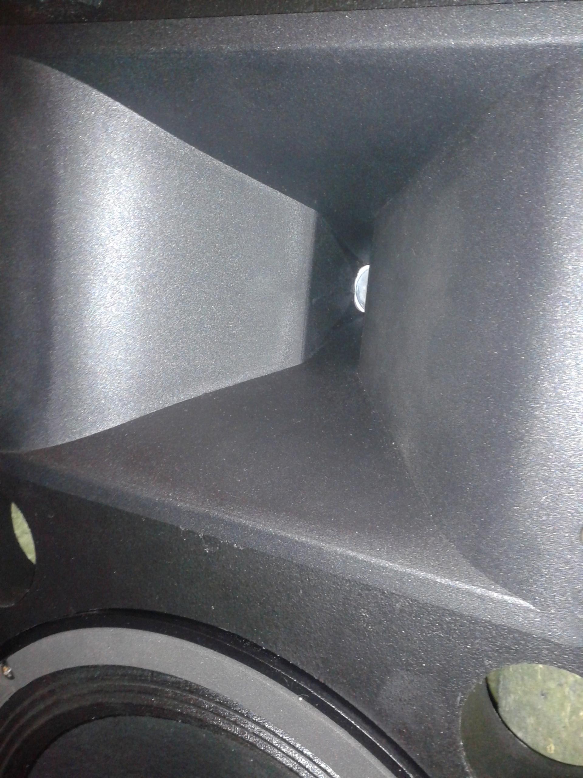

Currently, my HF horns look like the attached image.
The horn is ~11" wide and 7" tall.
As you can see, there's a discontinuity in the vertical walls. The inner vertical sections are actually parallel (about 1" apart), which doesn't seem like a good idea for HOMs.
I've found some 30ppi 1" or 2" thick foam online, that can be cut to size. The foam itself (for the inner part of the horn) is very cheap, but delivery is £8.
What does the panel think:
is it worth adding foam here?
if so, just to the inner section of the horn, or the whole thing?
Cheers, and Happy New Year
Chris

Definitely worth adding. Fill at least 1" past throat. How much more before you infringe on the gedlee patent for filled-up horns w foam, is questionable though.
yup, 1" slot certainly doesn't help it sound better............
I had luck with thin foam on 1 side of the slot, but I have a 1.4" cd.
And a much larger horn (13.7" x almost 24").
And it needed a bunch more boost when I added the foam, even on axis where foam didn't interfere with seeing the compression driver throat hole.
But it did sound better, less live (echo-y), more ribbon like.
You can try foam around the mouth too.
On mine it helped on the side, but not the top and bottom.
Too many path breaks in my opinion.
Practically speaking there is no issue using foam in a horn if you don't go mass-producing it. I would go ahead and fill the whole space. Just remember that you have to re-EQ the system with the foam in place. Otherwise it will sound dead.

Limited questionable return on foam. Great improvement from smoothing discontinuities at throat. Never hang any surfaces not blended in the wind.Definitely worth adding. Fill at least 1" past throat. How much more before you infringe on the gedlee patent for filled-up horns w foam, is questionable though.
