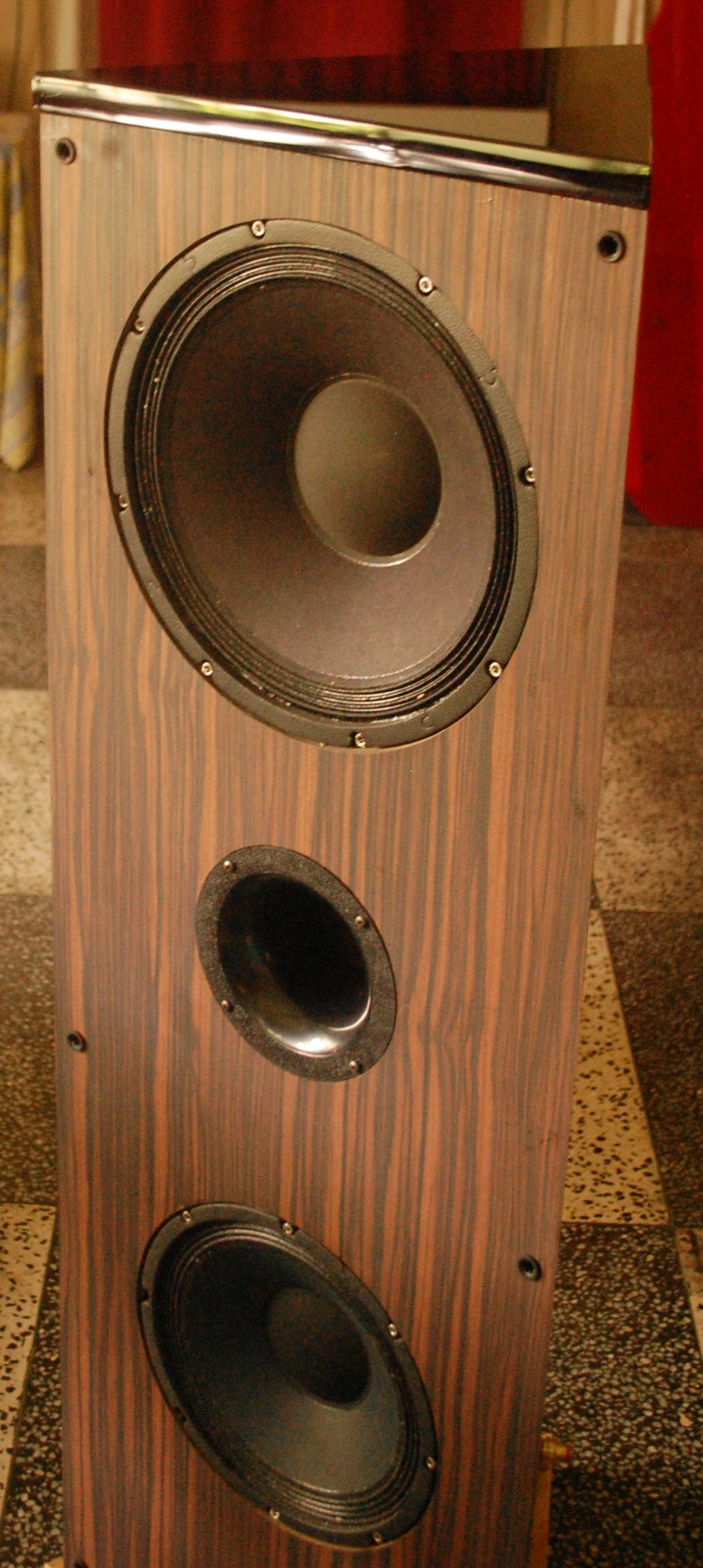

Fitted the drivers on the enclosures. Fitted the steel plates and spikes at the bottom.
The binding posts are from Dayton Audio/ Parts Express. Lovely hardware, together with their metal plates. I'd never want to use these binding posts without their metal plates.
The drivers have been fitted using absolutely delicious mounting screws from The Audio Crafts. I don't know where else such copper-plated screws are available.
The steel plate and spikes are made by Sound Foundations, a boutique manufacturer of accessories for high-end audio equipment. Those of you who believe in high-tech isolating mounts and supports for your electronics should see the kind of things he's made. These spikes too are better built and better looking than anything else I could find anywhere else. The steel plate is 8mm thick stainless steel. His workshop cut, drilled, and tapped the plates to order. Each plate is 14 kg in weight.

Looks like you had a bit of trouble getting the recess cut on the veneer, it's a pain though my carpenters came up with a compass built from a piece of kerfing and two nails, they get very clean cuts this way:
I suppose it would be tougher for veneer because the two layers have very differing ways of reacting to a metal edge, and the plywood backing isn't such great quality.
This is what a CNC-cut baffle looks like Baffle courtesy Ali, who you already know!
Actually, I don't have a problem with the precision of the cuts for the recess -- a router with a good bit seems to do a very good job. If you fit the driver just after the carpenter finishes the enclosures, you'll see a very precise fit.
But after that comes the polishing, and the layers of sealant followed by the final PU layer adds about half mm to 1 mm of material, makes the circle very slightly smaller. At that time, you need some coarse sandpaper to scrape off the extra material around the edges and expand the circle to the right size again. This affects the edges of the cut a bit, which is visible at close range. How would a CNC cut baffle avoid this problem?

If that is what it is, you need some masking tape and a sharp knife. Masking tape inside the recess before the coating process, and a knife to remove it after. The blue tape would probably be better than the white ones as the latter tend to absorb more liquid.
The knife is used to score the finish around the edges of the tape so that larger bits don't come flaking off when you pull the tape.

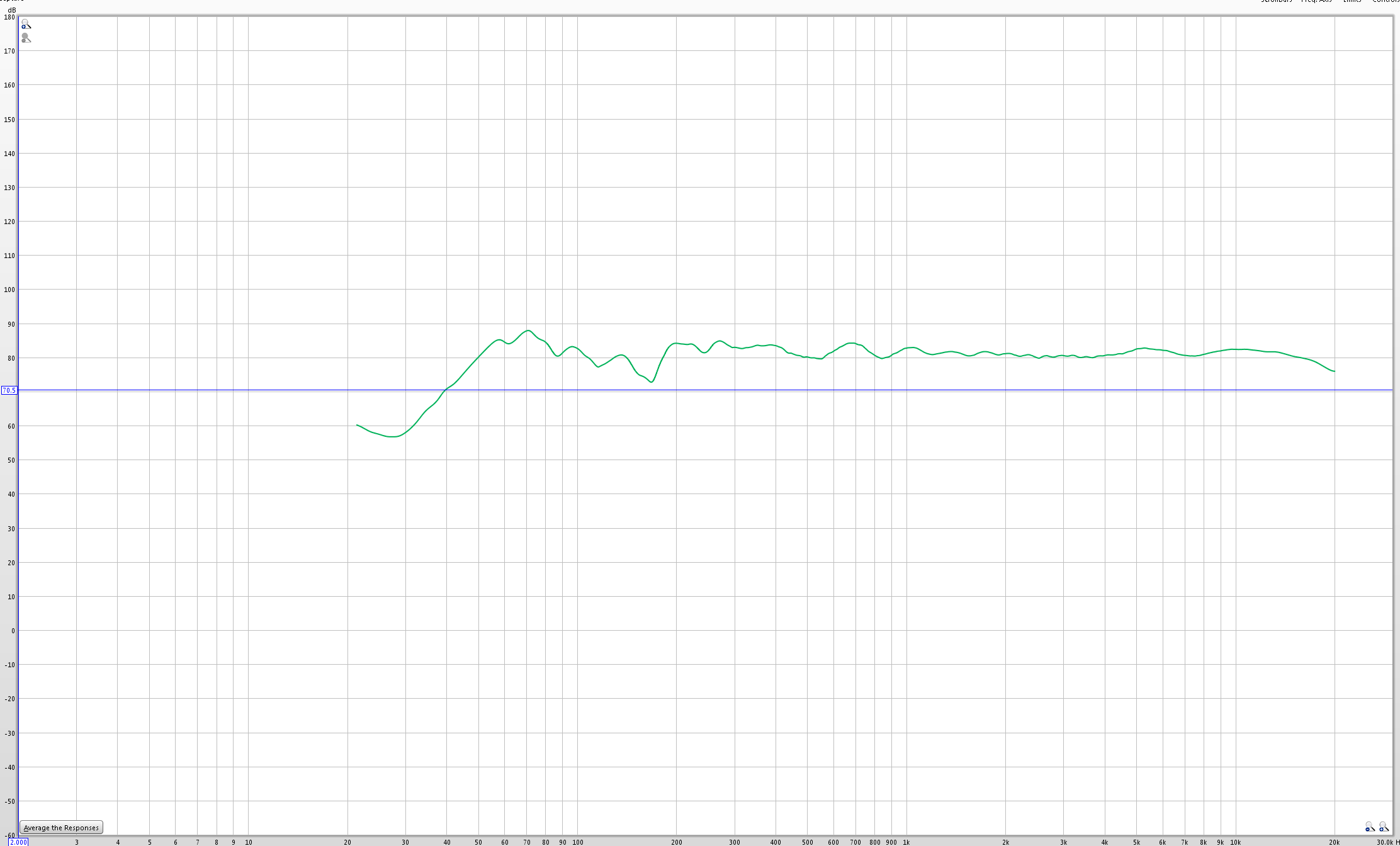

Finally did the SPL measurements of tweeter and midrange, at one metre distance, using my usual measurement setup (Dayton XLR mic calibrated from Cross Spectrum Labs, feeding tiny Behringer mixer, which is feeding my Creative Soundblaster USB sound card, which is hooked to my laptop, all driven by Speaker Workshop at 48KHz sampling rate).

I don't know if this helps, but here is the measurement of a finished speaker using this tweeter with a Revelator woofer. The crossover was passive. Since I did not have much time, I just took a composite 1m measurement in a concrete room, which is why the response takes till 1k to settle neatly.
The crossover was a two-component LR4 acoustic slope on the tweeter. I'm guessing with a 4th order electrical crossover you will end up near LR6, phase matching this to the woofer will be tricky. No harm trying it.
I have heard that system play at extremely loud levels and tweeter strain is not evident. I do know there is some response shaping required for that peak and dip combo at the upper end of the tweeter's passband.

Midrange-tweeter crossover version 1
I tried my hand at modelling a crossover using ACD (Active Crossover Designer, Charlie Laub's brilliant spreadsheet magic).
Full details on my Web page, with all the filter parameters and tweaking I tried.
