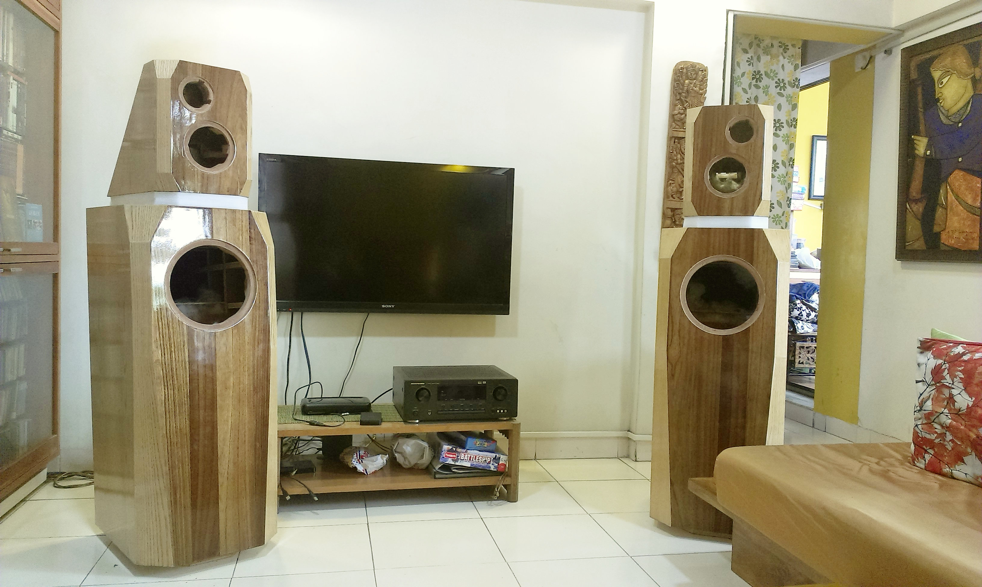

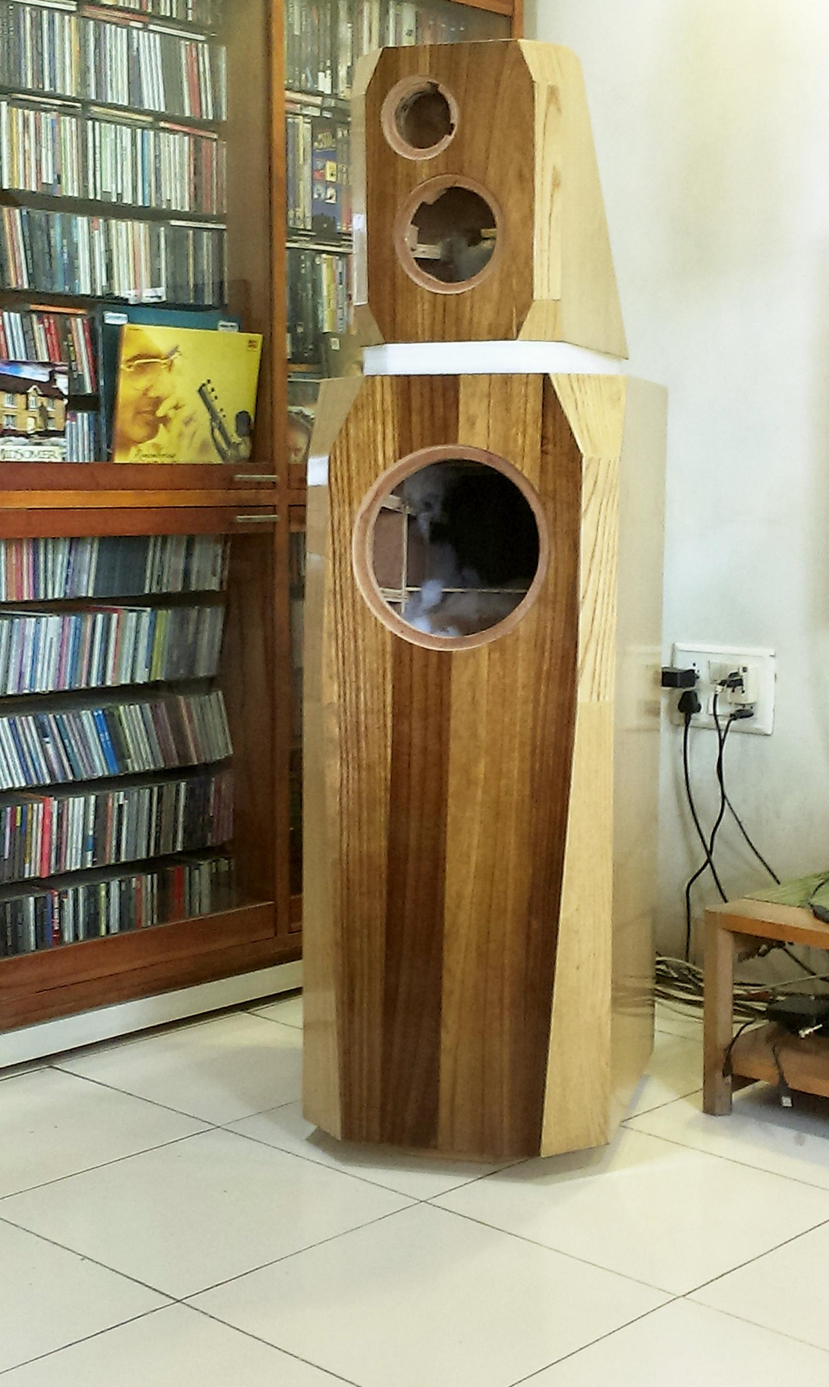

Finished the project. I may tweak the crossover over time, and I will certainly replace the current temporary amplifier stack, and will build new speaker cables, but all that is peripheral. The speakers are singing.
Darbari part 5: the crossover | dhandanought.org | tcpip
Darbari part 6: crossover tuning | dhandanought.org | tcpip
Darbari part 7: the sound | dhandanought.org | tcpip

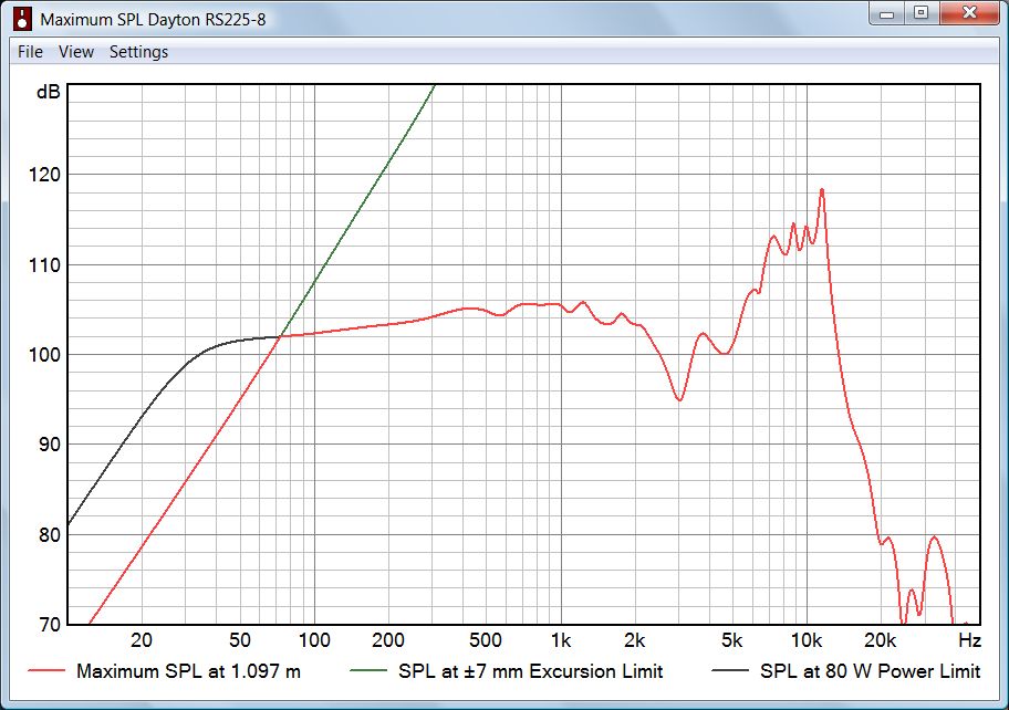

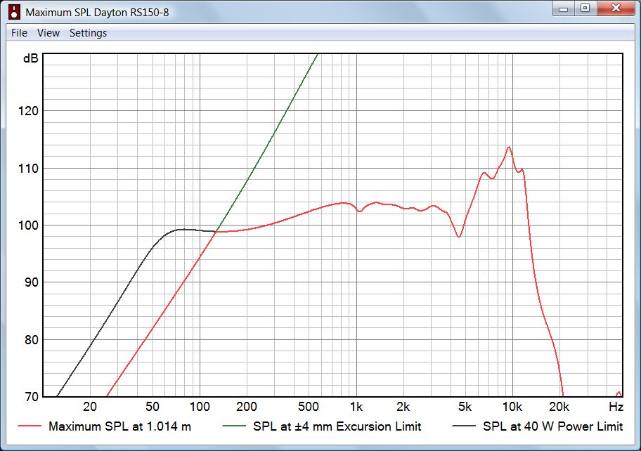

Had to go through challenges getting the crossover right. But then this was expected. This is my first 3-way after all.
My original assumptions done some seven or eight years ago have worked out in the most part. The crossover points are 150 Hz and 1500 Hz, and the drivers are behaving very well (other than the unexpected weakness of the lowest octaves).
The MiniDSP system delivers sound better than anything my ears can find fault with.
The Dayton RS drivers are excellent, and coupling them with MiniDSP is a match made in heaven, because the PEQ bands and steep slopes, not to speak of ease of experimentation, is really lovely.
Can't imagine doing analog active line-level xo now.
