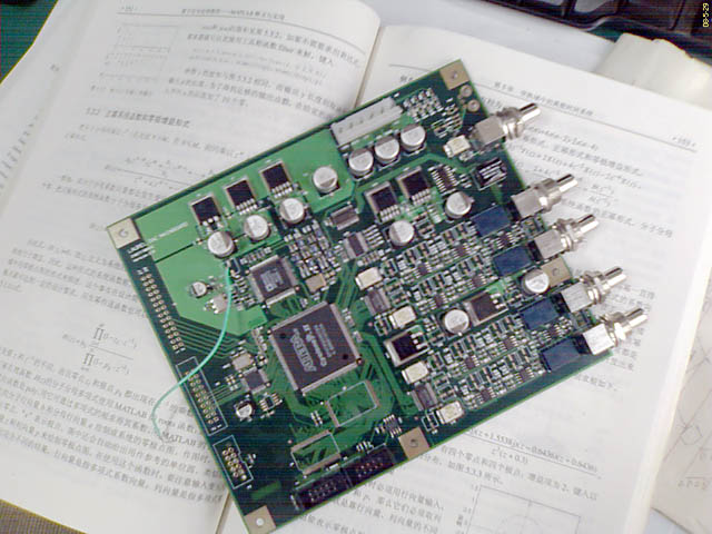

hi,all
I have developed a 24bit DAC with a FPGA in it.
the D/A are two PCM1794,running in MONO mode.differential output.
It has its own clock generator based on DDS technology(AD9852),and controled by FPGA,the Receiver IC is DIR9001.
The local DDS clock generator follow LRCK demoduate by DIR9001.
Now,I'm going to try FIR filter with different step and coefficient .
