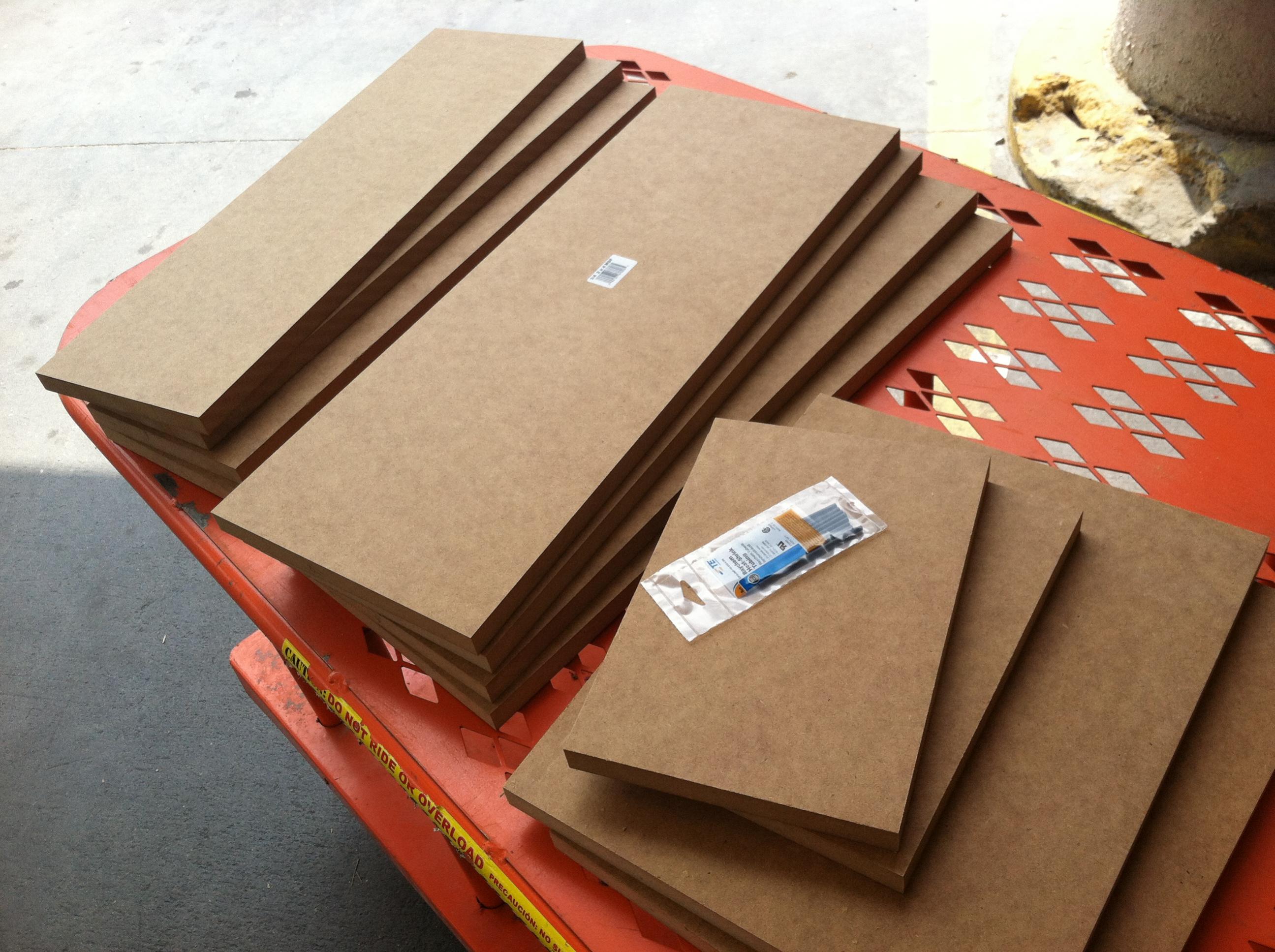

First of all, this is my "first" DIY speaker project and it was a challenge, since tools are minimal, however, with some background in wood, I made it through with minimal difficulty.

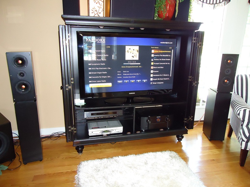

My room is approximately 20 X 24, 9' ceilings and hardwood with rugs....with all equipment close to a corner.
I own....a Marantz SR-7005 receiver, OPPO 93 Bluray, Comcast Receiver....Other speakers to compare with......Dennis Murphy's Philharmonic 2 towers, Philharmonitor 2 monitors, Philhacenter, Paradigm 7 (height speakers), 4 surrounds with BIC Venturis and Danny Richie's Direct Servo DIY sub.( Enclosure made "my buddy in Florida") :

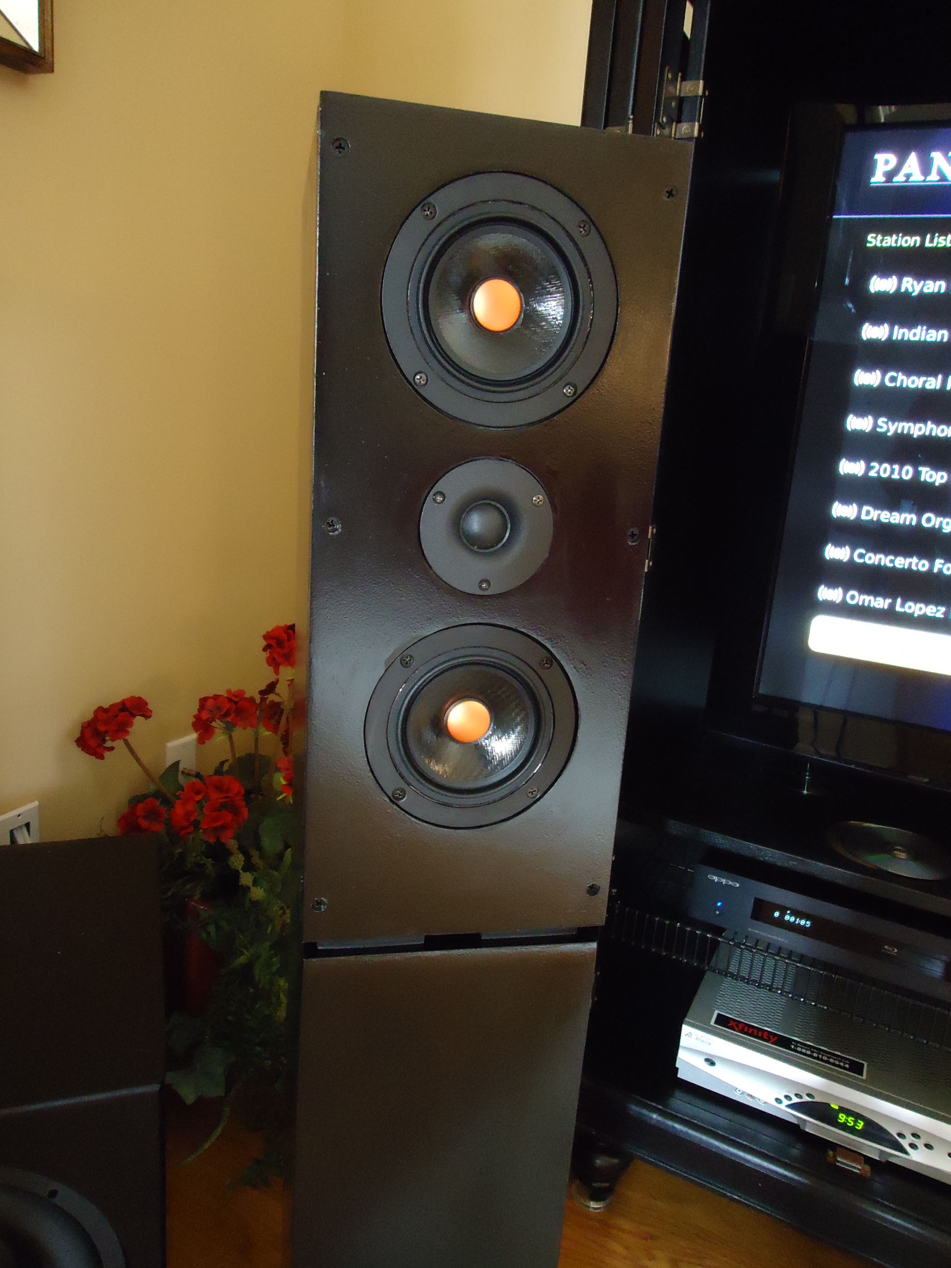

At first listen, which was in the office with the Musical Paradise 301 MKII 6.5wpc Tube Amp and the HRT Music Streamer II+......a little blown away with such clarity and detail. Sorry Bob and Jeff, I didn't expect this, but it honestly was jaw dropping!
Due to the living/theater room furniture upgrade, the Phils (superb speakers), were too big, so they had to be moved. My wife insisted more slender towers not as deep to be more compact, and since she is very important and gives so much, I would compromise. Thus the Tritons were chosen, recommended to me by a good audio friend who referred me to the Triton thread and the CSS webside and designed by a well respected designer, who I highly respect!

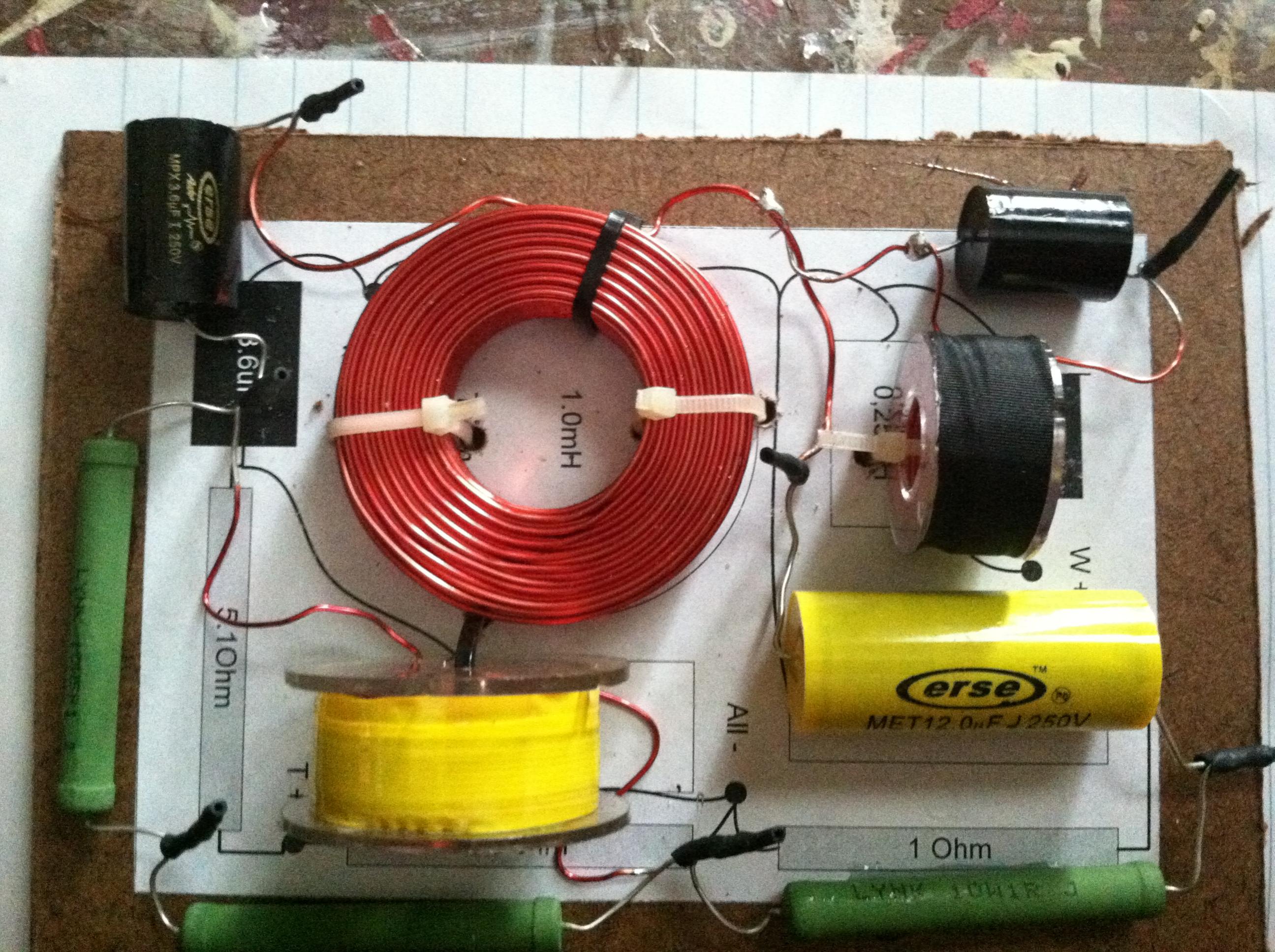

With my first crossover build, I was a little worried, but with Bob, Mark and Jeff, I made it and they both worked, just a little polarity problem, easily solved.
Most of the listening impressions are with Pandora, via OPPO, which does an excellent job. Some SACDs and blurays. I am no audio guru, actually as you read on is would be evident that my knowledge is very limited, but one's ears never lie! As mentioned the first listen was in the office with Pandora and Grooveshark.com, which is great streaming.....my favorite.

One other amazing factor, which still surprises me...they not only look like towers with the bases, but they sound like towers in every way.

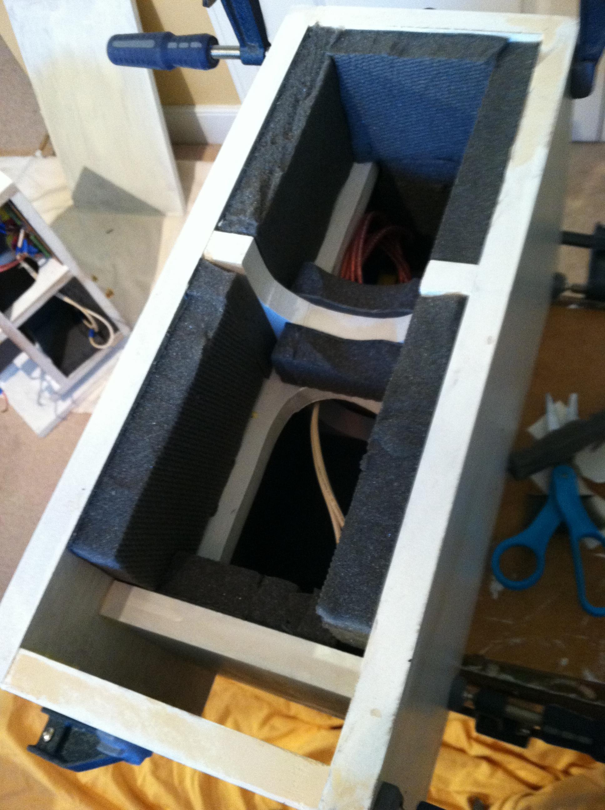

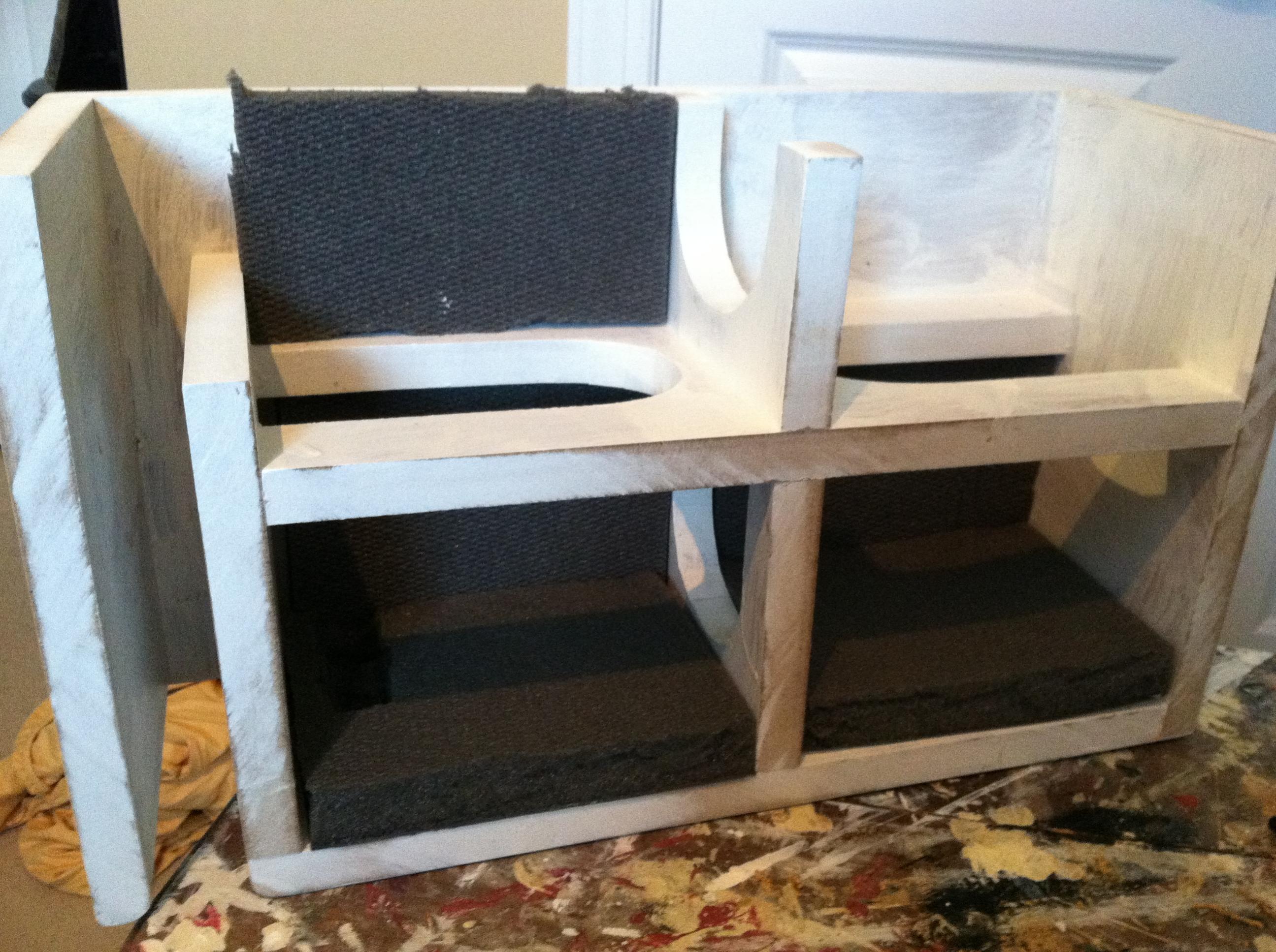

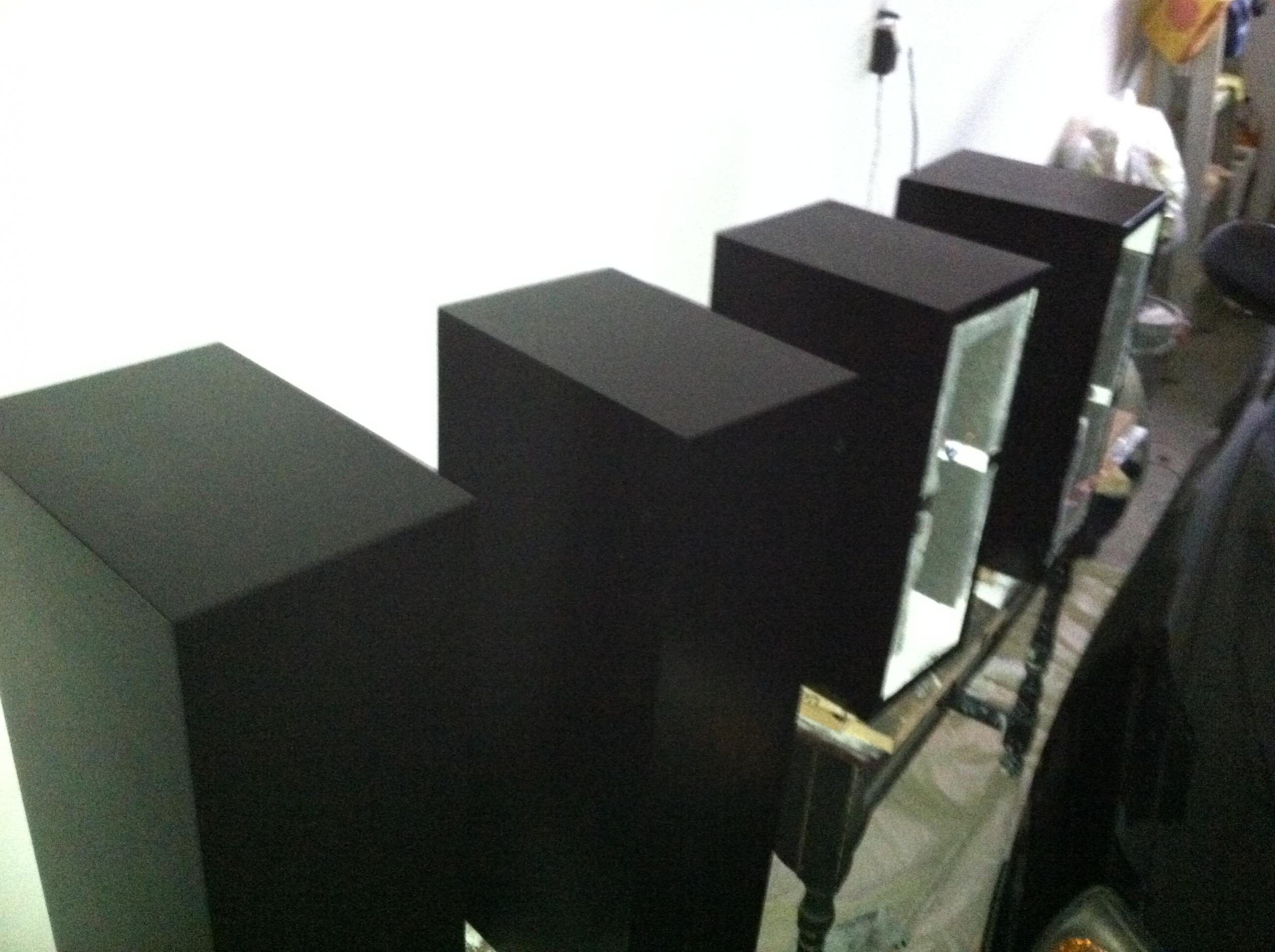

I also need to note that the bases were hollow originally, and there were resonances, so I filled them with cat litter for the lesser weight as the cabinets would be moved out for listening and the boominess was gone. They are heavy, but are easily moved.
With new banana plugs/sleeves/bases solid, etc on the Tritons, I am rediscovering the amazing sound quality these monitors produce all over again. I believe they were well worth the build and with the new CSS drivers with the XBL motor topology, the excellently designed crossover design by Jeff make these a worthy build and I think I can live with them a very long time. Thanks, Bob!

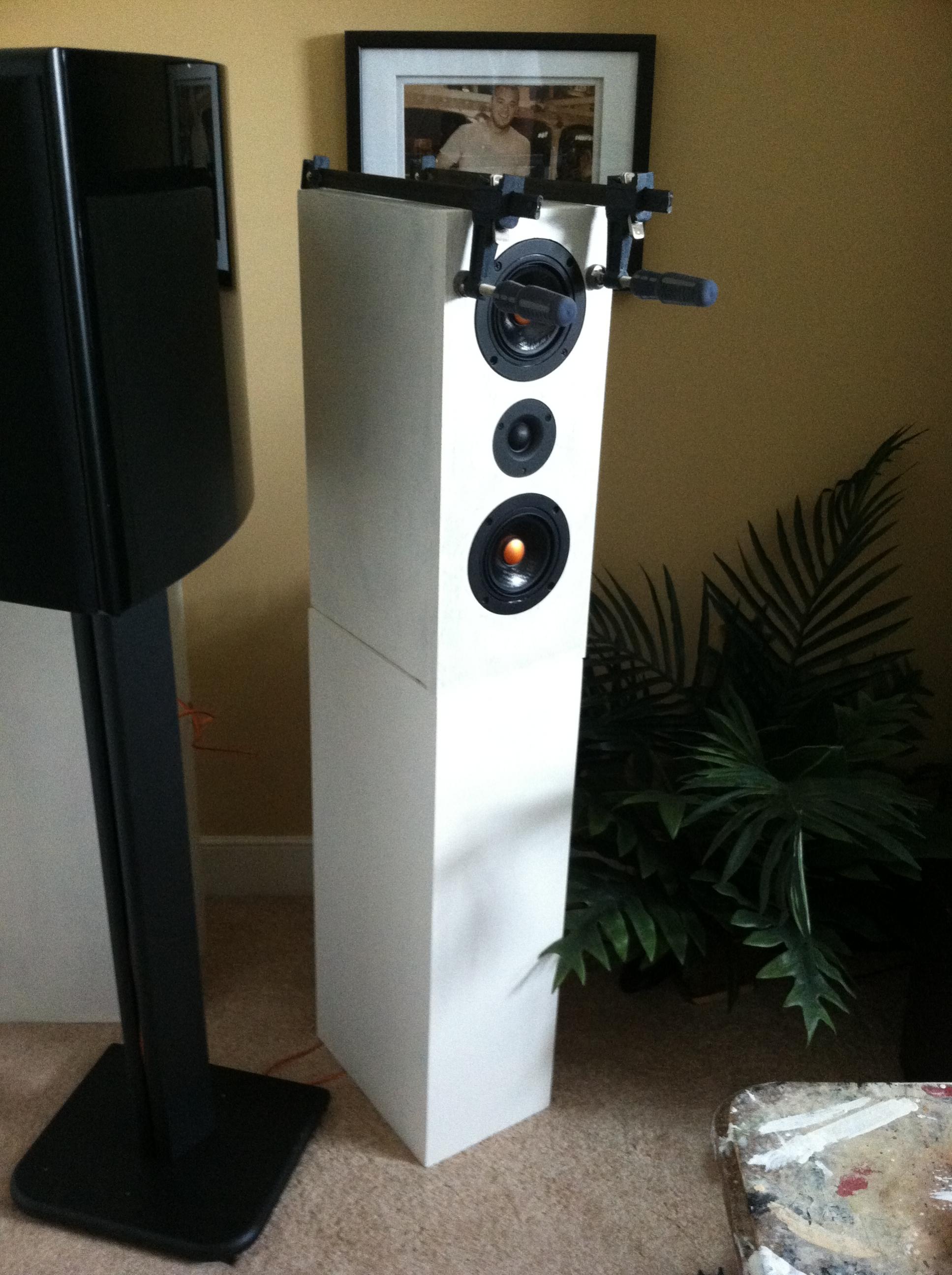

Now for a few pics.......Norez was my choice for the inside for dampening.

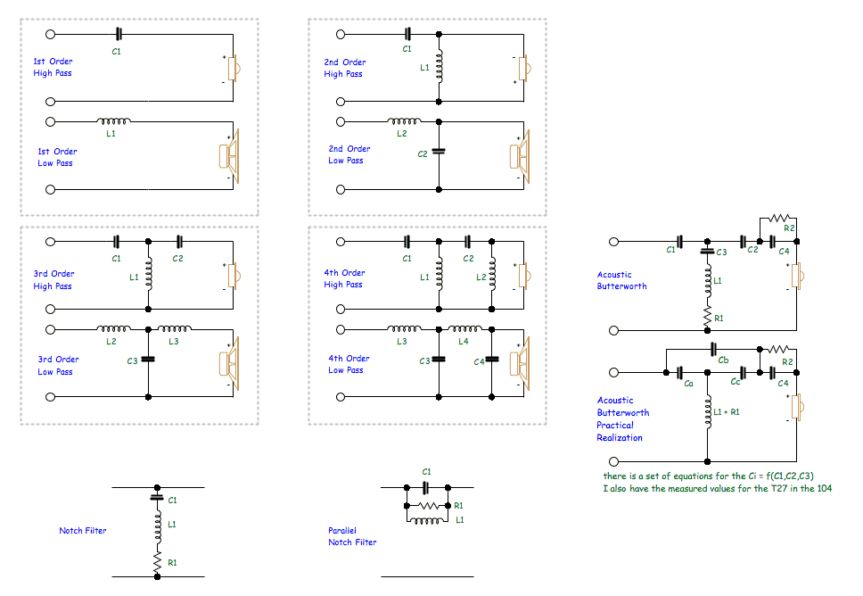

This is the second polycone D'Appolito design (aka as MTM to the those sadly addicted to obfuscating acronyms) we have seen at this forum in a couple of days. And very nice it is too. This time a small one (< 20 liters) suitable for small rooms I reckon, and having a PROPER crossover and evidently very uncoloured and low distortion. Any whining about bass performance misses the point I'd reckon.
2x 5" CSS VWR126X polycone bassmid and the CSS fabric LD25X tweeter. Whole drive unit and crossover kit available at CSS: Creative Sound Solutions - Loudspeakers, Parts and DIY Speaker Kits

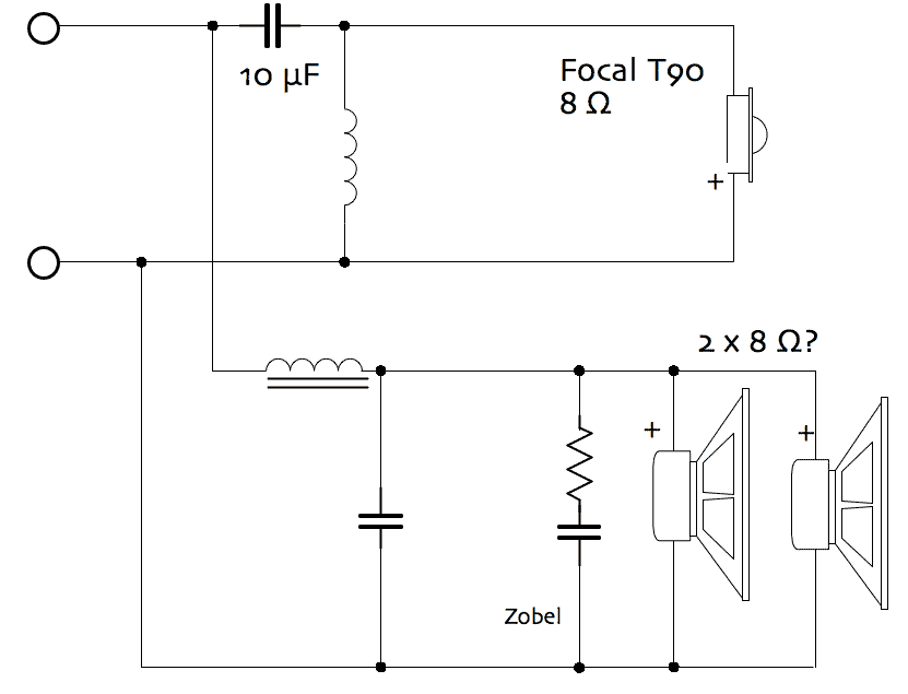

Naturally the review is incomplete for me without a schematic and frequency response, so I'll save you some legwork. Beats me why there is a 0.47uF/0.25mH tank at 14kHz on the bass filter...but I'd trust Jeff Bagby's reasons...
Calling the VWR a poly cone does not tell the whole story, it is a poly derived weave cone that is then heated until it becomes a non-homogenous whole. Dan Wiggins is very keen on this tech and took a long time finding the original manufacturer (it was 1st done over a decade ago (for Wilson-Benech?) and then lost). I believe SEAS also now has a driver using a similar technique.
And that XO drawingyou posted. That is my original EL166 + ERT26 drawing with new values and then jpged to death. It is embarrassing to see such abyssmal treatment to the original. I will redraw that and get it to Jeff/Bob. I did what i could to clean up the one you posted Mr. 7.

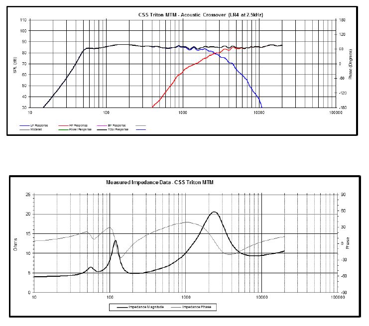

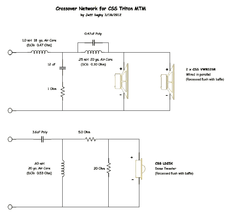

Hmmm.... I'm a bit perplexed here, but there must be some confusion. That is indeed my crossover, and it was drawn in my own software, so its appearance matches all of the other crossovers I have drawn. Maybe the topology is very close to the one you did, I don't know, I have never heard or seen that design, so I don't know. My crossover doesn't have any fancy circuits in it, since the drivers are quite easy to work with, so there could be many systems with a similar topology.
To answer the questions above about the notch filter on the woofers - I haven't seen any higher resolution response curves posted for the woofer that I am aware of, but it has a 20dB spike at 14khz due to ringing in the aluminum dust cap. I felt it prudent to notch that out even though it was a long way from the crossover point. I don't like to excit that kind of ringing in a driver if I can avoid it.

Jeff,
I think perhaps the origin of those driver representations & parts has just faded from your mind. That is my generic bass driver & tweeter drawing (nowdays i usually draw something closer to the real thing -- snapshots below just taken from my CAD files). It was what i used for the drawings i did for your 1st passive XO design SS software (late 2001 & early 2002) and for the earlier this article on TLS.org. I guess you have been using them over and over again, and each time saved as a jpg more noise added.
I misspoke when i said it was my EL166 XO revised (i did representitive drawings for that), i can now see the origins going back mush further than that -- sorry about that.
If you have been jpging all your drawings as much as this one, you should be embarrased by their quality, it is not commensurate with the quality of your XO & speaker design prowess. Just look at all the noise around the text. A drawing like this should always be saved as a gif or png. You have not been kind to the originals.
dave
Indeed Dave, for WB. They called it their tactic driver/cone/technology iirc. Woven poly, that is then heated in a specific way and then cooled so that part of the poly becomes far stiffer whilst retaining the materials self damping characteristics. At least that's the way I remembering it being spun in a review I read way back.

Yes, you are right. I was going to tell you that I built my "crossover schematic builder" out of the gifs that you made for me about in, I think, 2002. It simply pieces the little parts together to make the schematics I draw. It is pretty crude, but I thought it was OK for what I was using it for. I know there are real programs for doing this out there now, but I just kept playing around with my own little spreadsheet, since I had it working for me. Normally, I save them as gifs, but for some people they like me to send them jpgs. I'm not using them over and over again like copies of copies though, it doesn't work like that. As for being embarassed, I would only be embarassed if the speakers didn't sound good . The drawing itself isn't really what I am all about.

Thanks, RAW, I need to re-sand the cabinets one more time.

Yes the LDX25 has the rising response.
I believe ya have another set of crossovers coming your way....I could be wrong but thoughts so.
The rising response of the tweeter, place a 1.3uf cap across the tweeter terminal.Simple just remove the tweeters and solder the 1.3uf cap to the positive and negative wire for the tweeter.Then reconnect the wires to the tweeter.
