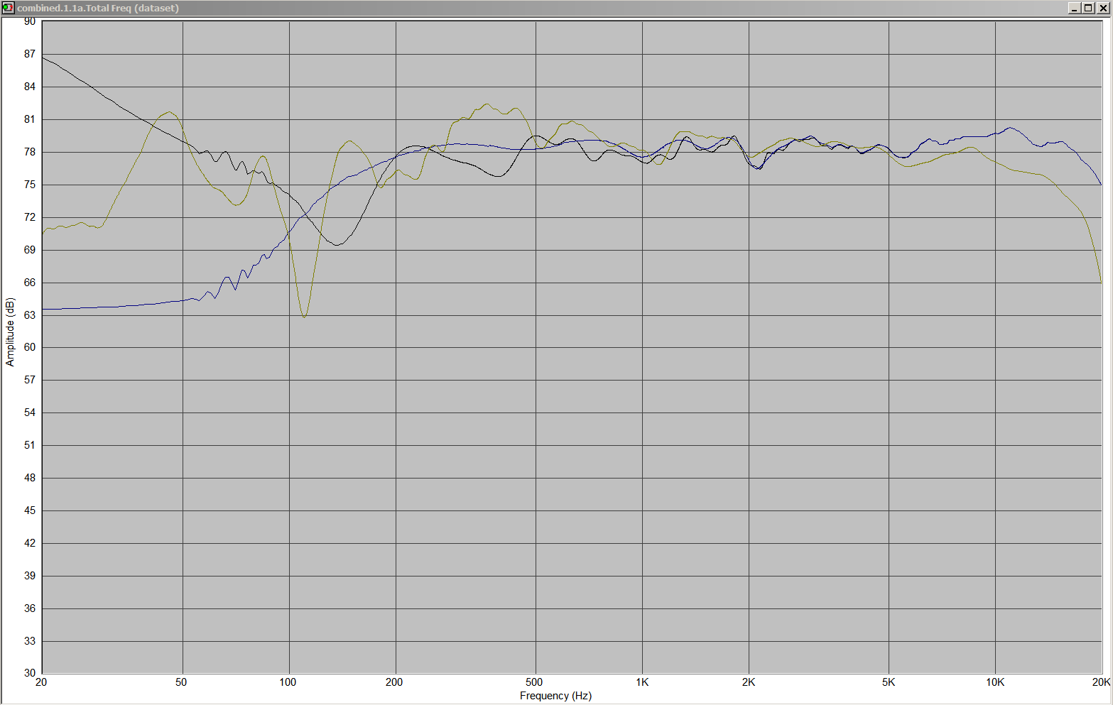

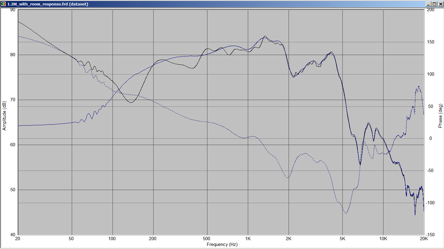

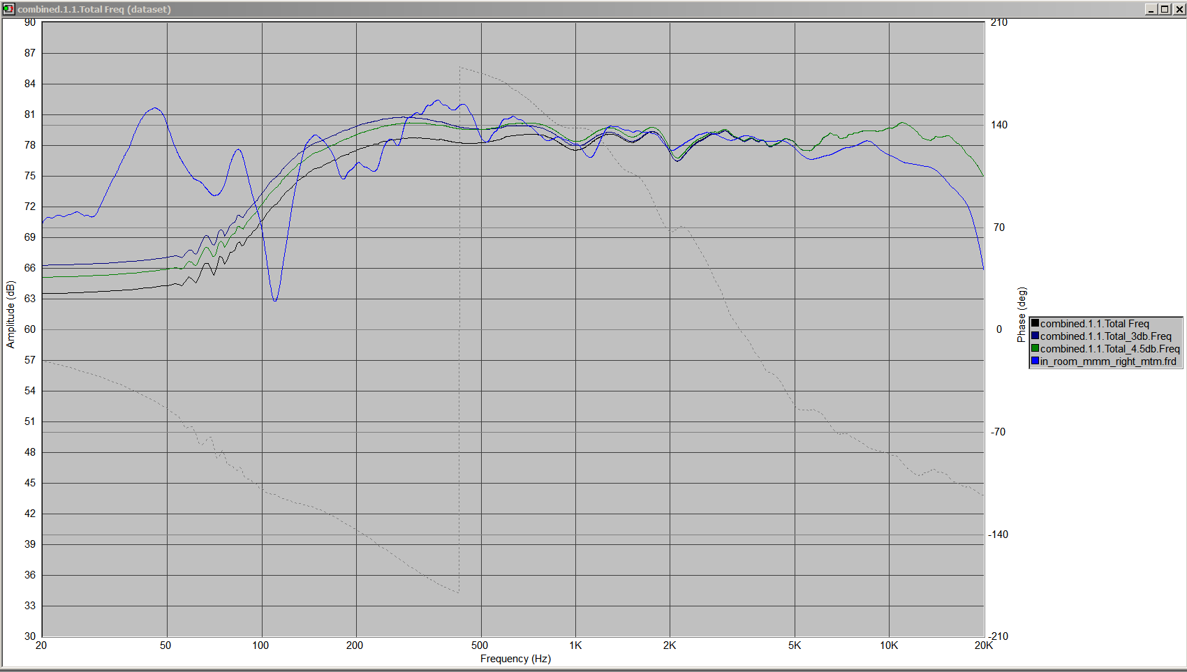

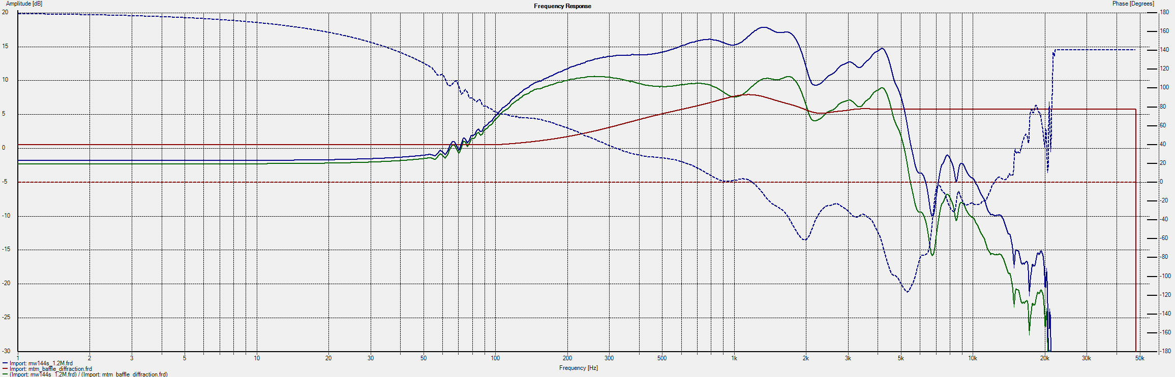

OK well I had a play tonight with the baffle and room sim and the results were not quite what I expected... First I modeled the diffraction using the original FRD consortium Baffle Diffraction Simulator as I have chamfered baffle and MTM format.
I loaded that and the frd file I had in speakerworkshop for my mw144s into holm impulse and divided the mw144s frd by the baffle response file giving the theoretical infinite baffle response (first pic).
I then ran that through the baffle and room diffraction and saved a room response version of the frd. I loaded that back into speakerworkshop and ran the crossover sim using that frd (after matching it for level with the original measurement).
The 2nd pic shows original response (blue) the response using the room corrected frd (black) and the actual in room measured response (green).
Not a good correlation. Though that is somewhat to be expected given that the room is a complex acoustic space. I really should do a measurement (and sim) in a standard room I guess, but that is unlikely to happen anytime soon...
edit: I added the third pic which shows what the output from the baffle and room response was. when added to the baffle corrected response file it is the black curve in the fourth pic.

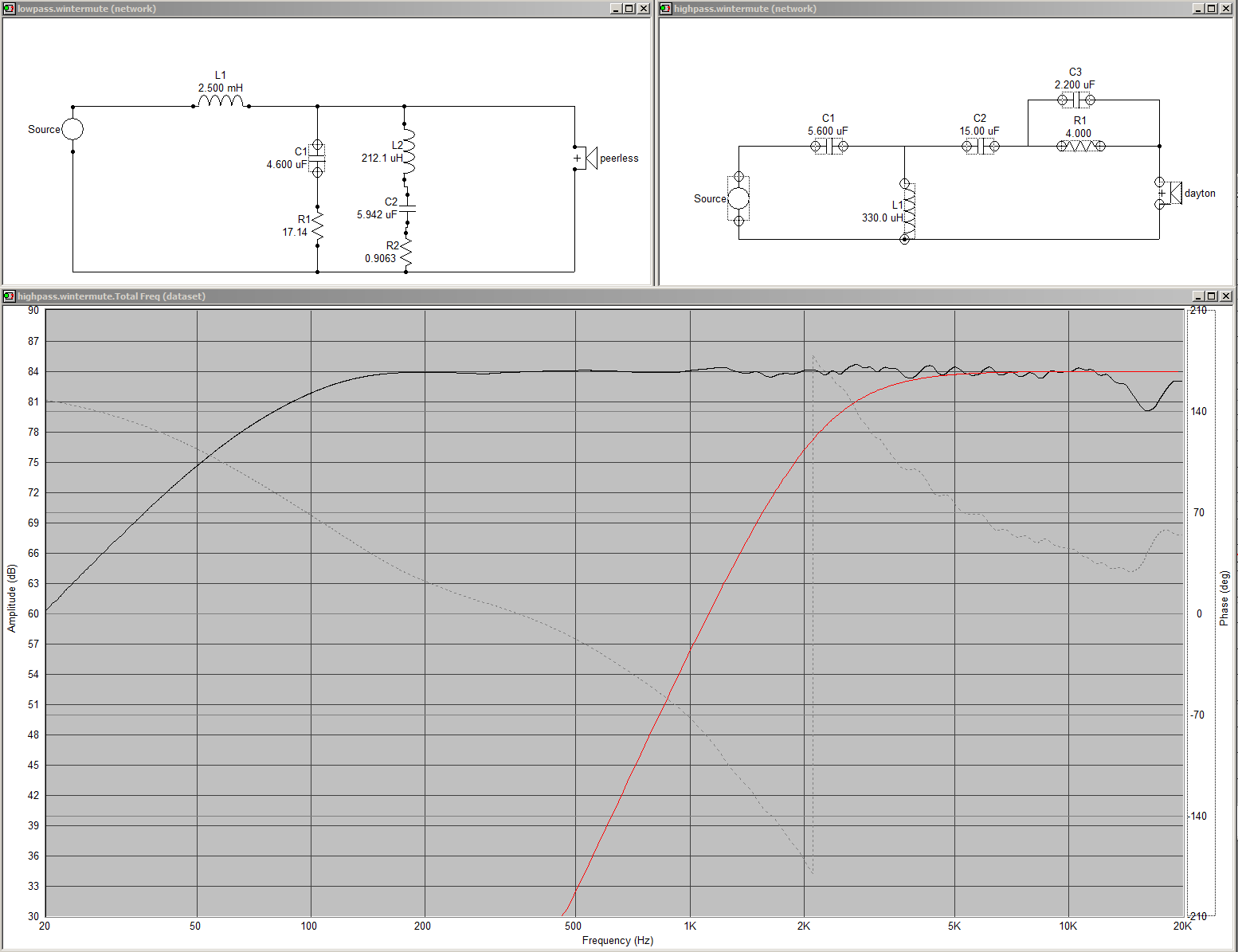

I've been having a play in speaker workshop, as I am more comfortable with it for modelling. tweaked a bit more, changed crossover to 2.2K. It looks very flat, I'm worried too flat!
I had a play with Jreave's version as well as it is simpler, but I was a bit worried about what it did to the phase at the notch freq... I haven't put the above back into PCD to see how it compares. Heading for bed.

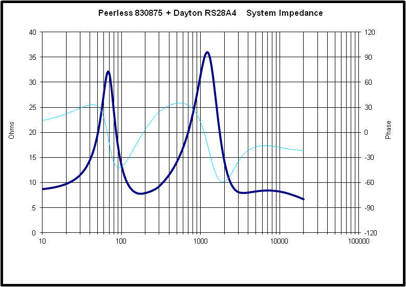

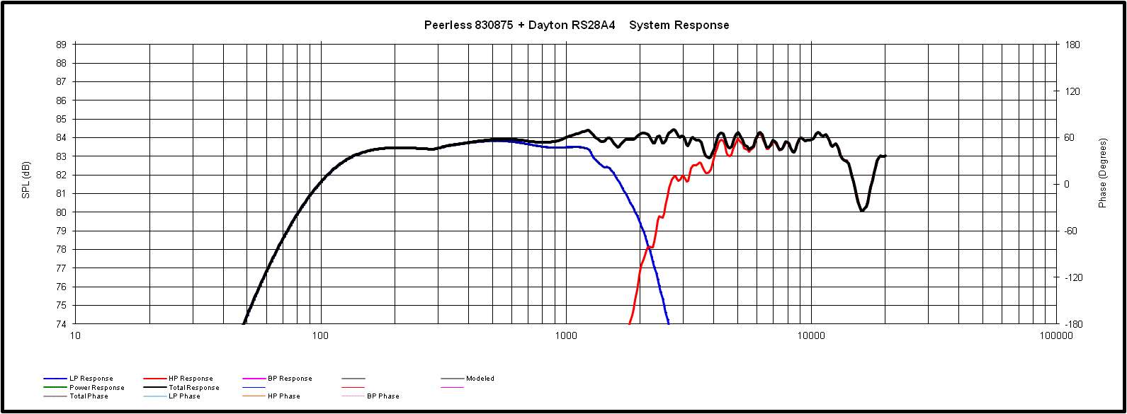

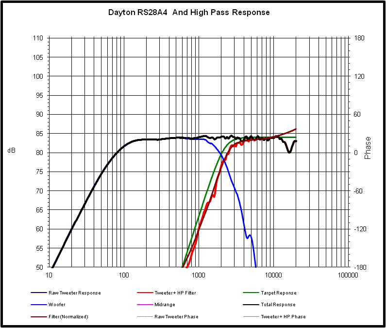

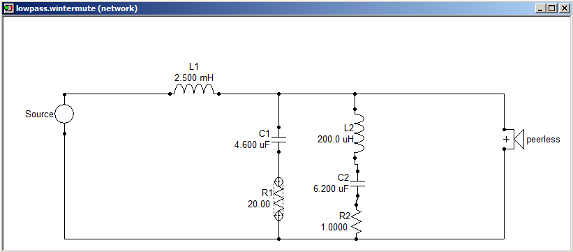

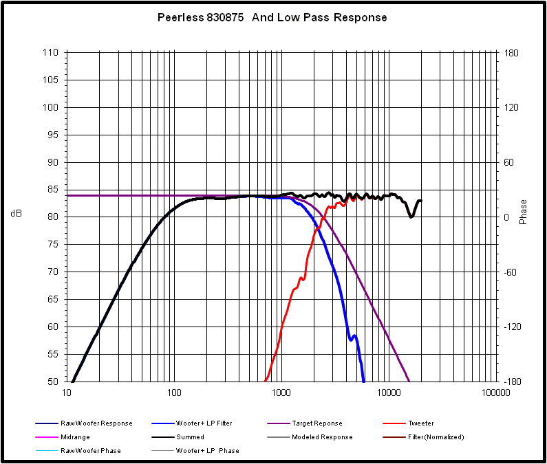

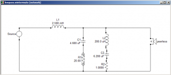

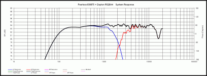

I input the crossover component values to the PCD. I cannot be happier. The results.
response_wintermute3.gif impedance_wintermute3.gif woofer_wintermute3.gif tweeter_wintermute3.gif
This is my next crossover upgrade unless someone convinces me otherwise.

I already checked rounding off the components to stock values and some to parts I have on hand. They all work fine.
Since I use the bookshelfs at above 100 Hz. The effect of reducing BSC may not be too audiable. I will wait until I finish and test your latest iteration before I make any further decision on the BSC. I hope that jReave may have some suggestion before I order the parts.
