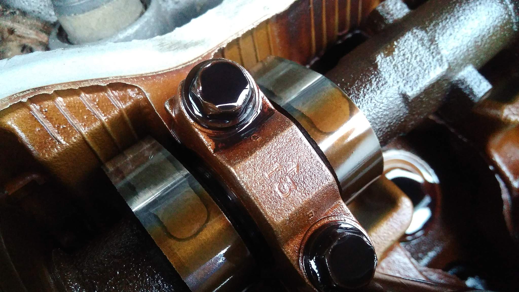

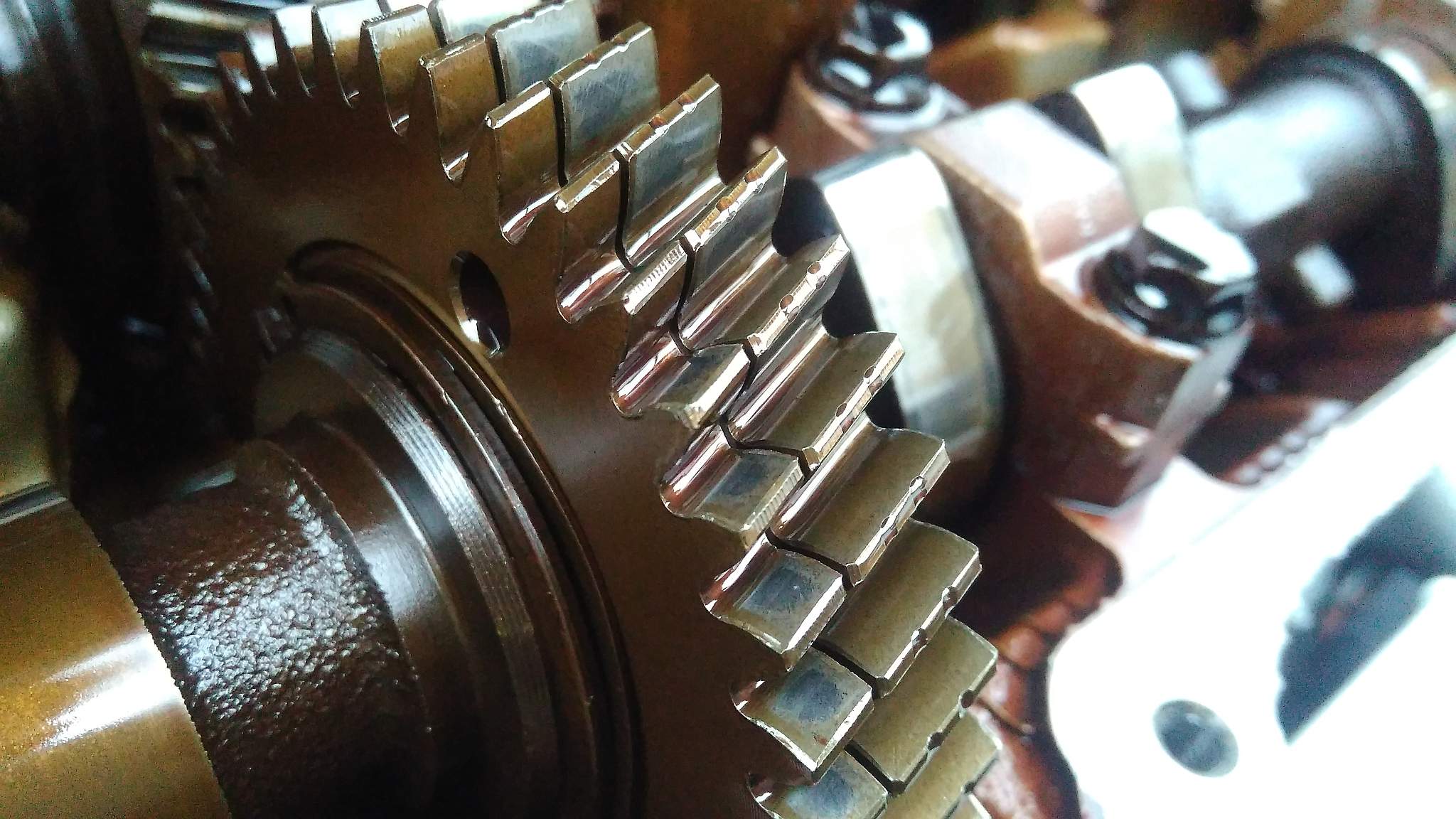

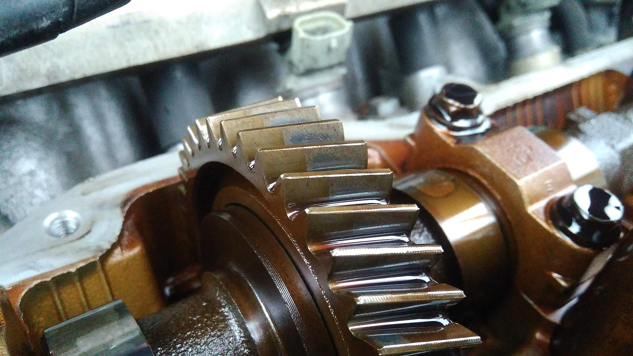

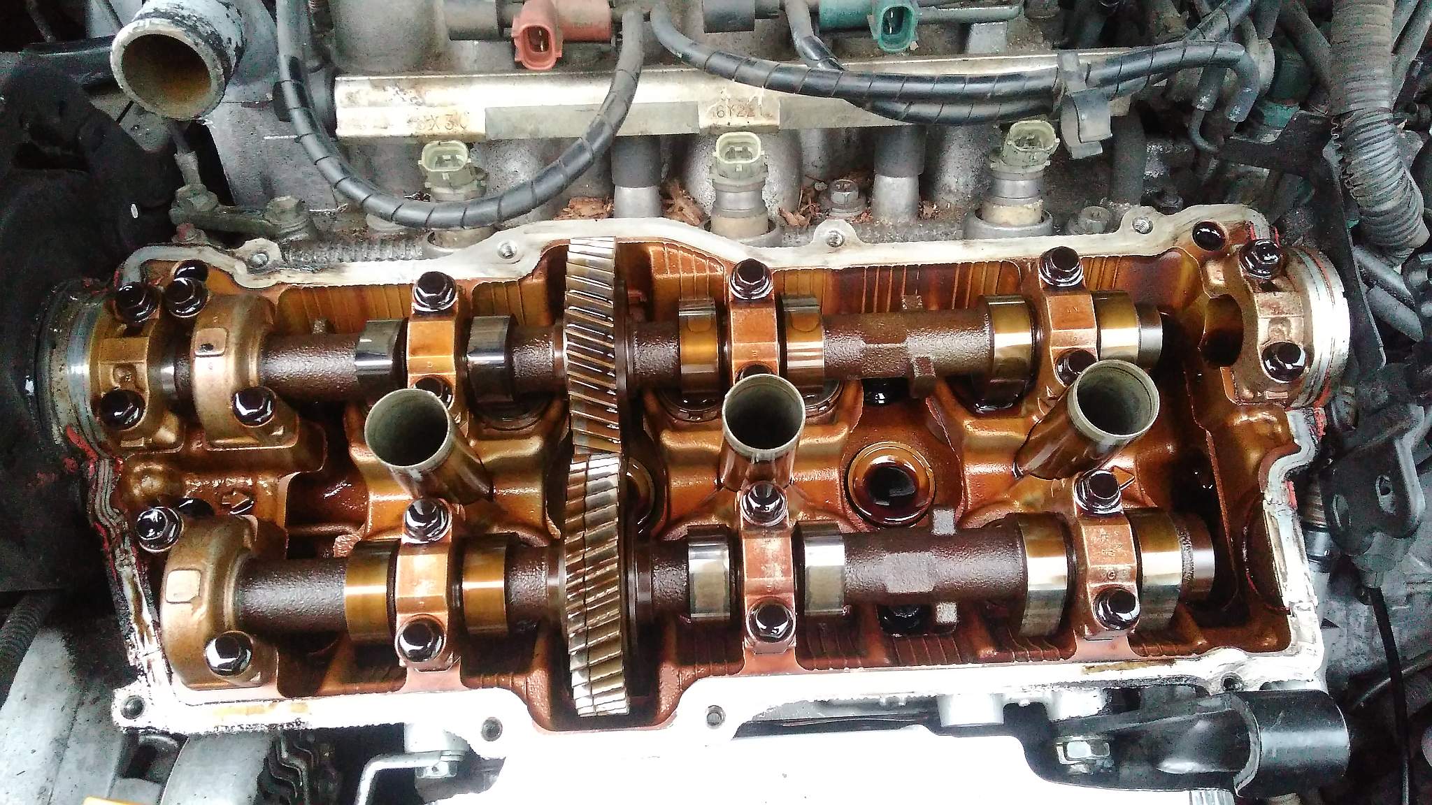

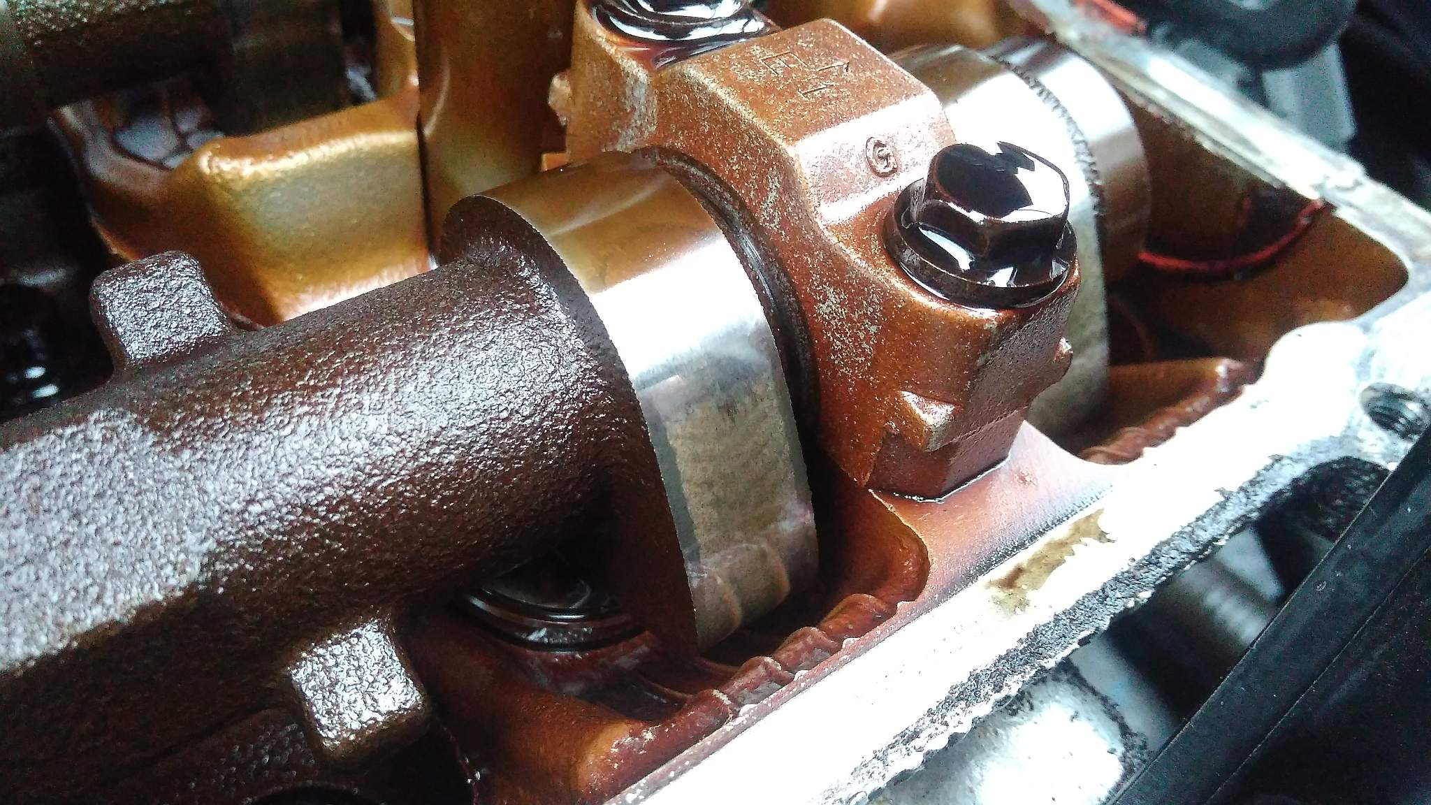

Here is some eye candy for you oil fiends out there. A 350,000km (217,479mi) Toyota Camry Vienta V6 3VZ-FE engine with regular oil changes its whole life. No idea what sort of oil was used but I can contact the mechanic who did it and ask. These pics were taken from when I replaced the forward bank tappet cover gasket. My mechanic did the rear one for me.
There is no scoring that I can see. Just the brand new ceramic coating that is put on cam lobes.

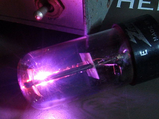

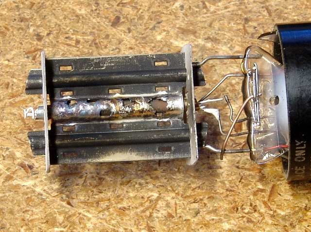

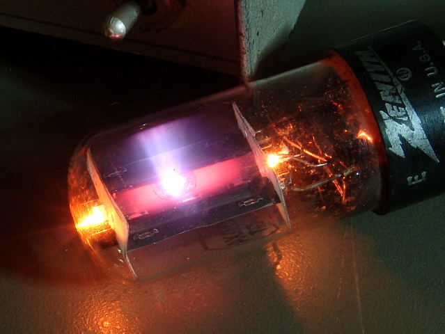

I learned cars the same way I learned electronics.....by blowing stuff up, then fixing it. Blowing up electronics is a lot cheaper than zipping a rod through the side of an engine block, or having a bearing come apart and one of the rollers get caught in the gears thereby busting the transaxle case apart in the middle of the road.
Ever tried feeding Nitrous Oxide to a lawnmower engine.....without fuel enrichment. It wasn't the big kaboom that we all expected. After screaming at about 5000 RPM for several minutes, it just slowed down and seized. Actual cause of death....melted exhaust valve.
Vacuum tube equivalent, parts of the cathode shooting through the plate followed by the blue ray of death, then meltdown, followed by autopsy.

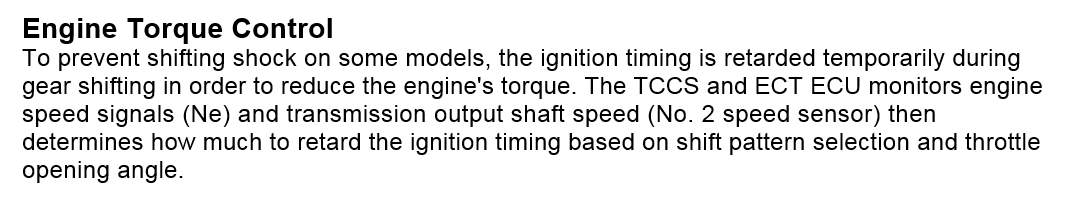

I do know that the transmission warms up because I've read in the service bulletins from Toyota that the A540E transmission won't shift into 4th gear (overdrive gear) until its warmed up.
See the attached file for the manual for the A540E transmission.
Could also be a failure of the ECU or the distributor in not letting it get the right timing. If the timing is off then I won't have torque available and torque is what spins the wheels.
But I bet you that everything is running fine and its just the 10w50 oil I've got in the engine. The reason why I believe this is so is because of past experience with thick oils AND the fact that this part of the manual should only be relevant to pre-1993 cars, as on page 7 it states that the main speed sensor #2 isn't present on future models and mine is from the 1993-1997 era, VCV10 series.
If the ecu isn't retarding the timing then I suppose the distributor rotor and cap could need replacing or the distributor itself. But I haven't noticed any misfires at all.
